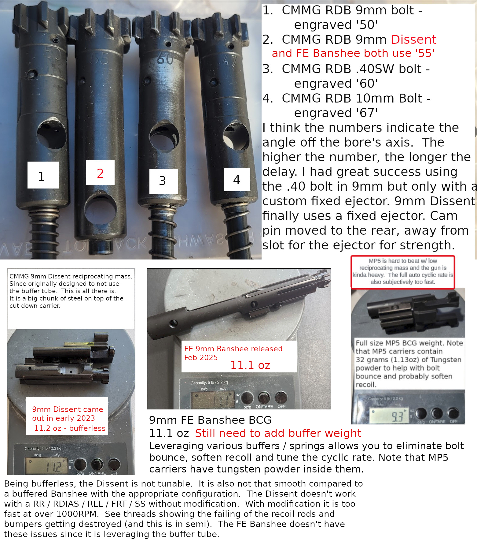

This picture from my website provides some more information:
Bolt 1 is from the older spring loaded ejector Banshee showing it uses a 50 degree bolt.
The 9mm Dissent which finally had a fixed ejector came out in early 2023 which is bolt #2.  Notice how the cam pin hole has been moved more to the rear to accommodate the slot required to clear the fixed ejector or the bolt will crack after XX amount of rounds. IME about 20K rounds if you were crazy enough to retrofit a custom fixed ejector in the old CMMG spring loaded ejectors.

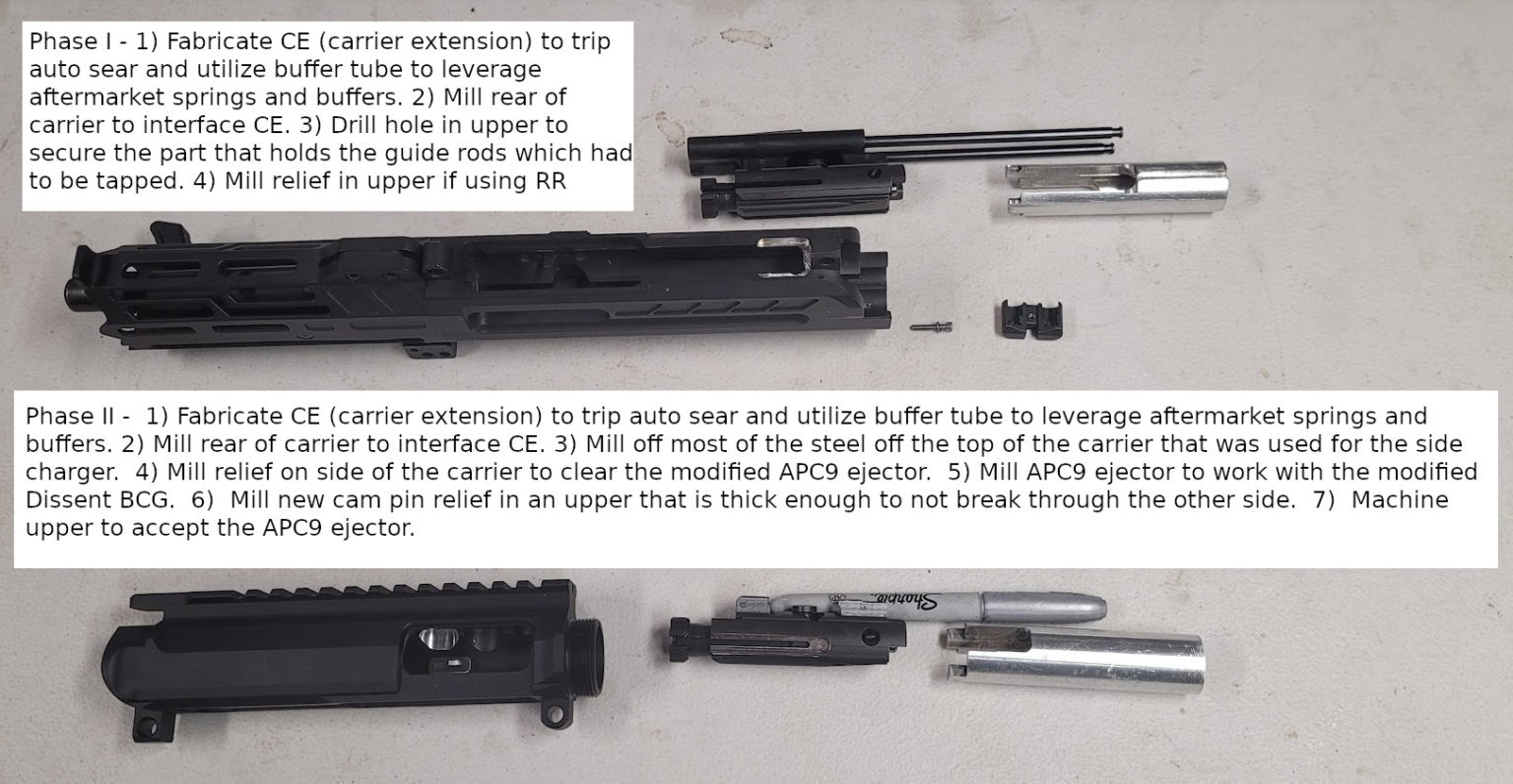

So from 2023 to early 2025, I was modifying the Dissent BCG's to work with the buffer tube and run them in full auto since a Dissent doesn't have anything to trip the autosear.  Notice at the bottom how I had to mill a new cam pin relief in the upper for this to work.  CMMG also wouldn't sell me their ejectors used in the Dissent so I had to buy APC9 ejectors and mill them out to fit.
Then in Feb 2025, CMMG finally released the FE Banshee's and I have been using the Retrofit Kits to build them out using my barrels as their barrels are known to have issues like I have documented here: https://c3junkie.com/?page_id=1882
This recent thread is discussing someone's dissatisfaction with unburnt powder coming from his action and I am suspecting it is the barrel but it is hard to say without seeing it first hand: https://www.ar15.com/forums/Armory/New-CMMG-Banshee-MkGs-A-few-FTFeeds/48-562010/
CMMG customer support gave him a generic answer.  Like I mentioned in that thread, when I had a bad barrel, they wouldn't anything for me either.  I had to buy another BCG / BBL combo and use a high speed camera to show the difference is extraction and then they finally replaced my first barrel as it had excessive headspacing.
I got so fed up, I stopped using their barrels, started converting straight blowback barrels for the CMMG system and getting a run of my own made.
