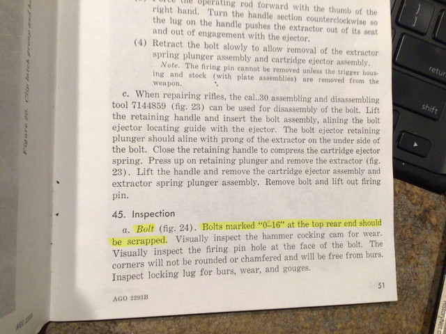

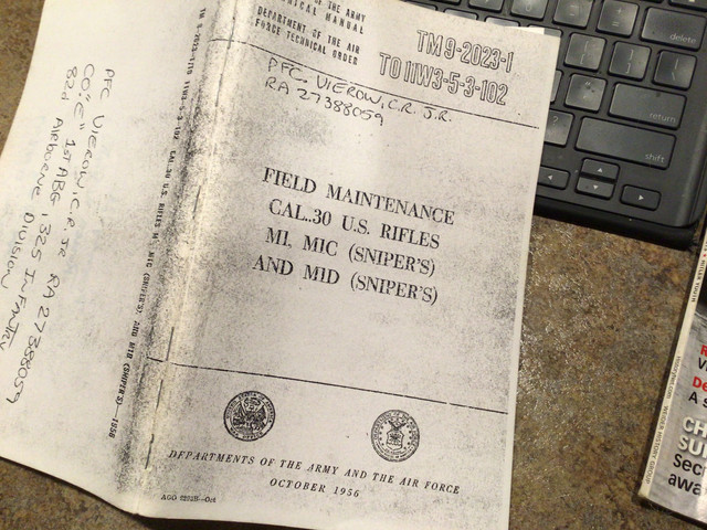

5/19/2025 8:23:48 PM EDT
Nice assortment.
Just a FYI from a 1953 Ord TM.

5/19/2025 9:42:20 PM EDT
Originally Posted By scottrh2:
Nice assortment.
https://i.ibb.co/CpRgZm31/IMG-1803.jpg
https://i.ibb.co/q3KMZHJy/IMG-1804.jpg
Good to know, thanks.

6/19/2025 1:53:08 PM EDT
Nice assortment.
You could sell that ‘O-16’ bolt to a M1 bolt collector as a non-shooting part (i.e., historical interest only).
6/19/2025 2:10:43 PM EDT
No one really collects these, I have have had several and had to basically give them away
6/20/2025 7:57:25 AM EDT
Paper weight, like cut M14 receivers…
6/21/2025 1:10:35 PM EDT
Nice assortment.
Quoted because it’s important
6/23/2025 11:53:24 AM EDT
Or a drill rifle/dedicated wall hanger.
