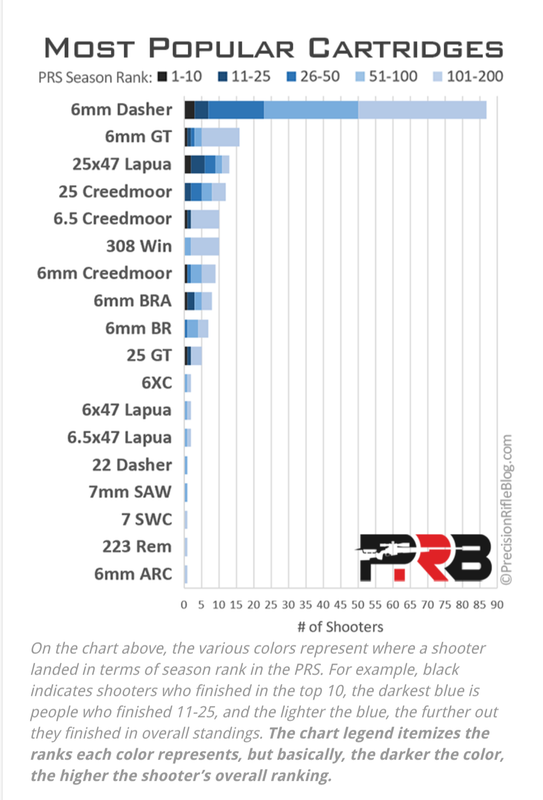

As for a PRC-6 being niche, I guess that depends on what target market the PRC cans are aimed at. I my read was that they were somewhat intended for the PRS crowd and if that's the case, 6mm is the most popular caliber in use by a pretty good margin with several popular cartridges, and .224 cal cartridges are much fewer and further between. Add in that many of the newer 6mm cans are similar in size/weight to .223 cans and tend to work well on .223, It seems to me that a .223 only bolt gun can for PRS type uses is a much more niche product than a 6mm can.
Here is the 2025 data for most used chamberings by high level PRS competitors from PRB, 25 cal is starting to catch up, but  6mm is still by far the most common.
https://precisionrifleblog.com/2025/09/19/best-rifle-cartridge/
All that said, I actually do run long OAL .223 out of a bolt gun out to 750 and 1k more often than 6mm, but I'm not competing and cost is a driving factor.... No real recommendations for the OP, I'm  pretty much always using one of a couple .30 cal cans or my 6mm CAT can on that rifle.

We’ll keep the data in mind.  In my personal opinion for every guy in PRS there are 25 guys who own precision rifles that want to be able to correct after a shot, and I would expect most of those to be 6.5 creedmore. This is kind of a really affordable option for them to do that with.
The 6mm version if it existed would have to be the length of one of the 556 or 762 versions with a different bore size.  So maybe running 762 with a dedicated 6mm brake would make more sense than actually making another model, as the front cap changing does 85% of the work anyway, and a larger bore just means lower influence to poi which the prs people should want.

I'd probably vote for a PRC-22 woggled out  to 6mm over the 300 choked down, a little lighter and shorter for those who might want to cross it over for hunting duty.
No argument that 6.5 is the most popular caliber for folks who aren't super serious about PRS type shooting, want more energy on target or are hunting and might make a decent compromise bore for 6mm, .25 cal and 6.5mm. Usually it seems like 6.5 cans are .30 cal size/weight and 6mm can be closer to .223 size/weight, that smaller size/weight would be an advantage for some uses.

I was the other person asking about a PRC-6. If there ever was a “niche” can, it would be a .223 PRS can. Like the other poster said, PRS, and long range rifle shooting in general is dominated by 6mm. That said, there’s a lot of 6.5mm also. Maybe it could be a PRC-6.5? I understand the PRC-300 works, but nobody wants that loooooong of a can. Think HRT-5K with a 6.5mm bore and braked endcap. That might help fill a hole in your lineup with less overlap. You’d sell hundreds of them.
We already have a prc 300, and the longer  can in development is a prc .338.  I think the .300 and .224 are only .550” different in length, but the .338 will be longer.
