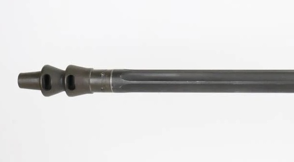

What is this muzzle device?
Pictures below...
Its on an m82a1
Sn under 500.
Is it factory or no chance?
Early a1 with old 82 part?
I looks so puny to be effective.
Thoughts?
Google results were no help
Thanks jp

Did you attempt to post a picture?? I ask because there is no picture.
5/3/2026 11:31:20 PM EDT
Like this?
early M82A1 brake - circa 1989

5/4/2026 8:28:28 AM EDT
Like this?
https://i.postimg.cc/hjJ7KfgZ/early-barrett-m82a1-brake.jpg
That's it.
Thank you.
 Is it  effective  for muzzle blast or should be upgraded?
Thanks again.
Jp
5/4/2026 8:34:24 AM EDT
[Last Edit: osprey21][Edited] [#5]
It doesn't 'look' like it would be very effective, and since it wasn't used for long, I'd say it wasn't.
eta: IIRC, 50cal used to work for Barrett so he may have more info on it.
@50cal
5/5/2026 1:08:42 PM EDT
Originally Posted By OWCH:
https://www.ar15.com/media/mediaFiles/34290/1000014132-3757229.jpg
I thought i had.
I was interrupted by turmoil,  our Bison Bull decided to go ape shit on a 5 hour old calf...
( calf is somehow alive this morning)
Jp
Thats the brake before the arrow head brake came into being. It wasn't really that effective. It was used on rifles made before 1989 or so. The arrow head brake came out not long before the Desert Storm era rifles.
It was also used in conjunction with the bolt carriers with the short throw accelerator in the bolt carrier. If you upgrade to the arrow head brake, you need the newer style bolt carrier that has a longer throw accelerator and accelerator rod.
The cone brake was also on the longer 33" barrels with the large flutes. That barrel most likely does not have a chrome lined chamber.
5/5/2026 10:03:43 PM EDT
Thank you for that good to know information .( bolt carrier)
Me thinks I'll fire it as is and see how I feel about it.
Then see about carrier and brake options with cost.

5/6/2026 6:36:19 AM EDT
That brake isn't very effective. You are going to feel the punch on it.
