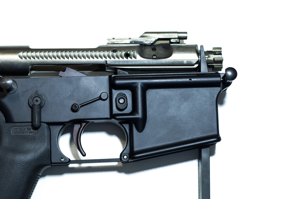

Blown primers can happen for several reasons.  When the end up under the trigger group, it can cause fail to fire, full auto, and safety selectors not working correctly which can include the gun firing when the safety is put into the safe mode.  Blown primers in the bolt lug recess can cause fail to lock into battery, and even fail to unlock from battery.  Blown primers in the bolt carrier cam pin recess area can cause the issue that sounds like you possibly had going on.
We show this tool in the Armorer courses we teach.  It is handy when the bolt carrier assembly is stuck forward.
https://www.ustoolanddesign.com/products/manual-bolt-extraction-device

Interesting tool right there.
In the past I have used inertia to move a stuck bolt carrier, and also a brass punch and mallet….  Of course this was for quick fixes, and I had spare guns to issue out of I broke something.  I would likely take a little more care with my own rifle.
