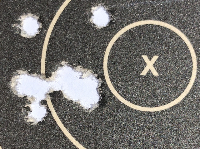

[Last Edit: Trollslayer][Edited] [#7]
69 gr RMR HPBT bullet
12 rounds fired at 100 yards,
No correction for wind was attempted (multiple mph wind shifts evident in photo)
24.0 gr TAC, WSR primer, R-P cases
Top two fliers are 100% my fault (called).
Group is 0.63 MOA (worst case spread, C-C)

Nice shooting. Update as promised.

Holy Hannah that's nice shooting.
I guess for the cost I'm glad I bought 1500.

Thanks for the compliments, guys.  Shooting is fun.
I updated the post after you guys posted, so take a look at the other bullet I tested.
