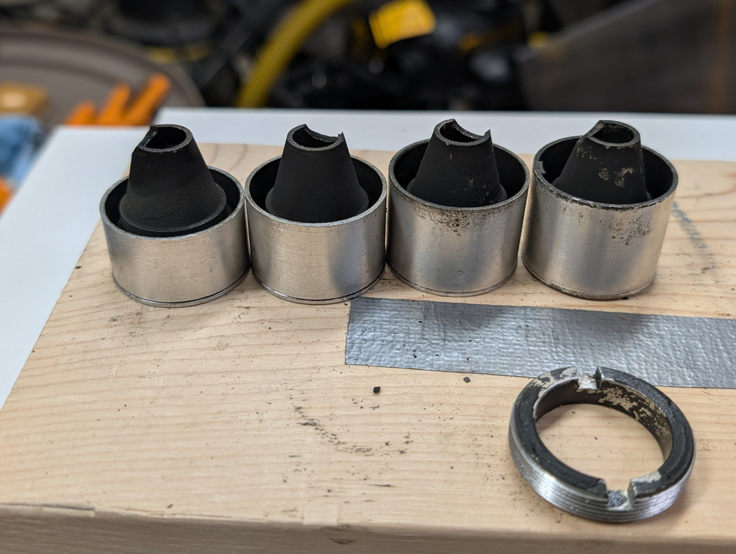

Well I already had 4 of the baffles out so I am cleaning those anyway (nothing works well, used Breakthrough last night). I might try some Kroil inside the baffle stack to get the last baffle out (it's crusty, the first two came out easily, the 3rd and 4th needed to be worked with my fingers but I can't reach in any further).
Before cleaning, much better now but not perfectly clean.
