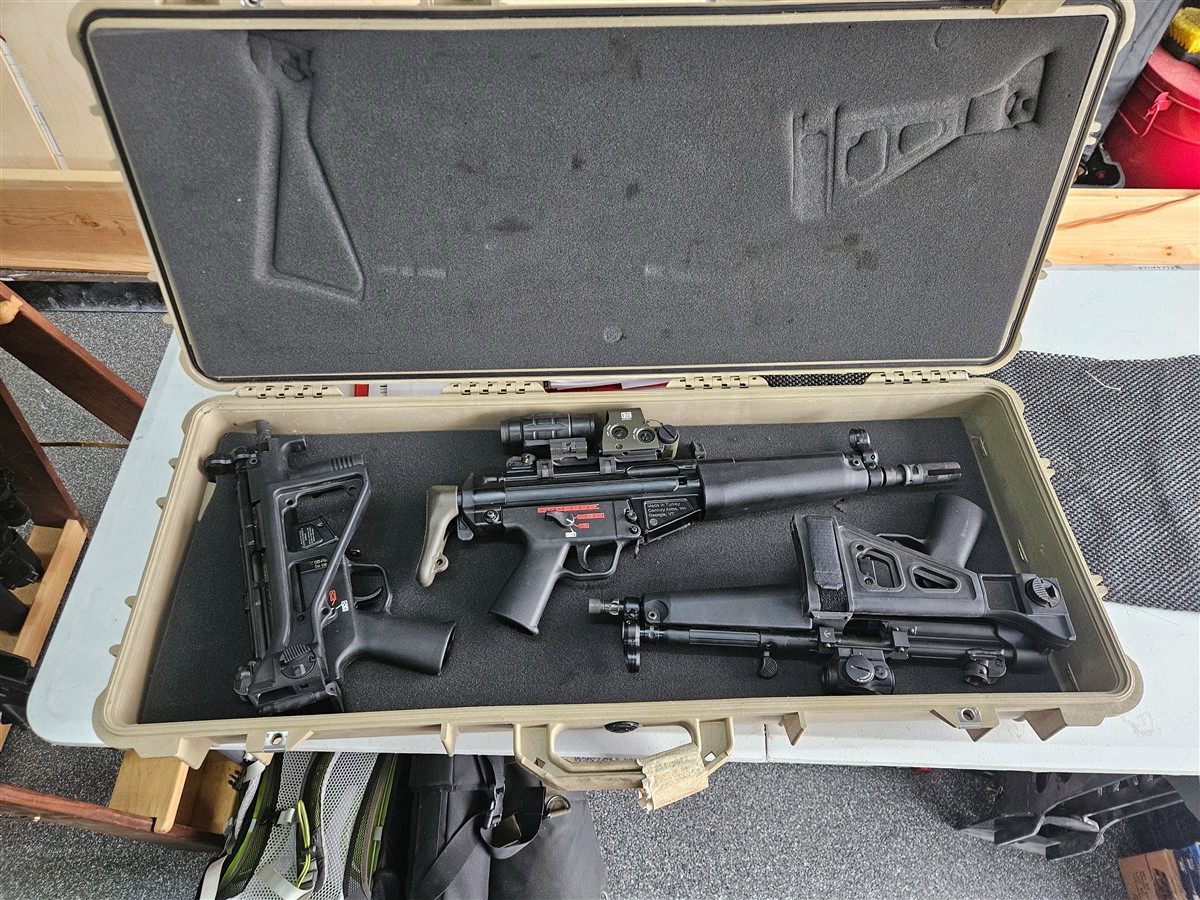

Originally Posted By Mblades:
I don’t think I’m far behind you. The main thing holding me back was indecision, couldn’t decide between the 53 and PTR G3k clone but now that one is sold out.
Get both Attached File
3/7/2026 9:01:14 PM EDT
Agreed! I'm not brave enough to try either with an A2 stock yet though!

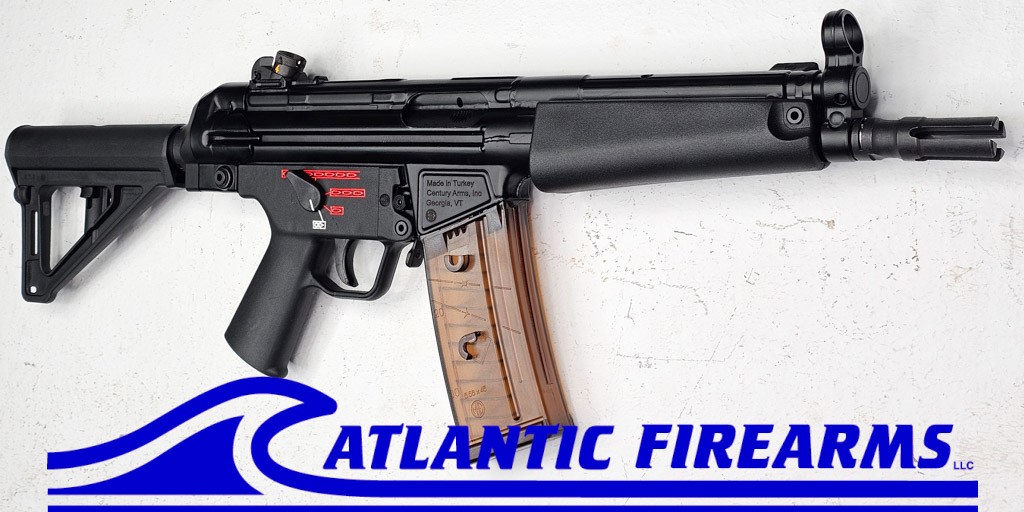

This but grab the A3 stock from Atlantic Firearms for $199 instead lol - https://atlanticfirearms.com/MKE-HK33-Retractable-Buttstock
You'll still need an HK53 recoil rod assembly though as noted above.
