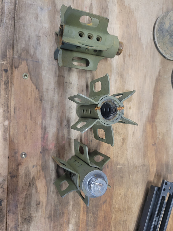

I got lucky and bought 20 of these demilled 81mm fin sets for relatively cheap. I'm going to make some 3dprinted bodies for them so I don't have to make my own fin sets. For the price I got them, it doesn't make sense to print them.
I still need to get my italian tube and cup separated and work on a firing pin. I'm not really expecting to have it done before the big event. But maybe I'll at least have some rounds made for others to try out.

The threads are s little bit rough on some of them. So I'll have to see how I want to tackle that issue. I even thought about just cutting them off and the. Welding a 3/4in nut on to interface with the allthread of a printed round. Especially since a hole would need drilled in the end for easy reloading anyway

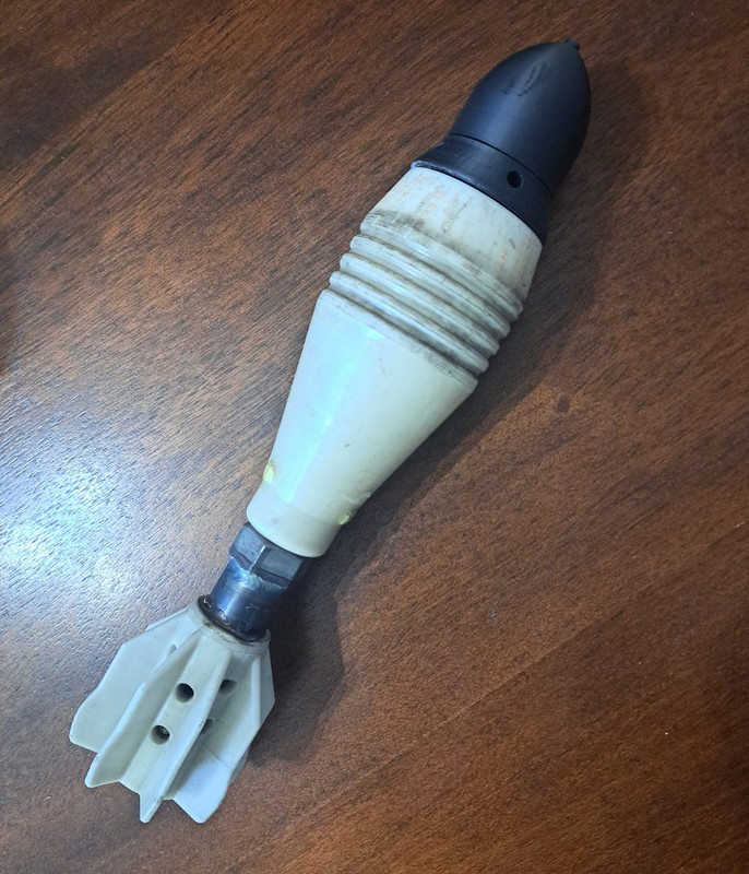

Managed to score some M879A1 practice rounds. I think my mortar round collection is complete. Now just need to have some fin adapters made that resemble the ones from the 81mm rounds from destructivedevices.

As much as I'd hate to cut up these fins we got, I'm thinking I'll just cut the threaded portion off and then weld on a 3/4" nut to interface with the allthread I use in my 81mm printed bodies. That'd also leave a good size hole to punch out the spent blanks. And the threads are already demilled. So I'm only making them a little worse.
I'll probably grab the ones I have with the worst threads and start with those.

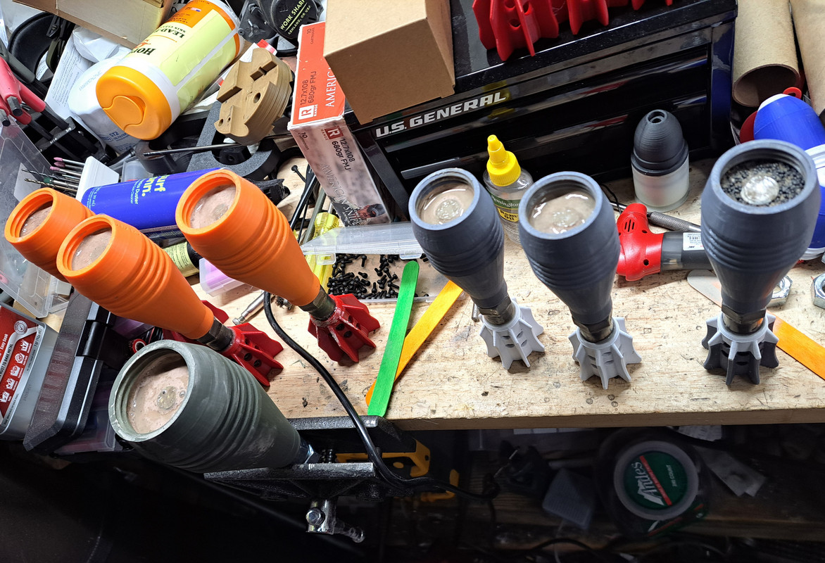

I was filling a few 50mm rounds I made for a friend, and decided to go ahead and fill a few 60mm I had ready and the one 81mm I made a while back but never finished. Now I have an excuse to since I have all these fins. Though I'll probably still assemble a set of printed 81mm fins as a proof of concept.
I also have thirty  50/60mm fin stems on the way from a machine shop. So I gotta make more 60s to stock up.

How bad is the demill? Could they be fixed running a die over them? I was thinking about just making a female to female adapter with the fin threads on one end and 5/8-11(that's what I use on my 3d printed rounds) on the other.
3/6/2025 2:54:01 PM EDT
They're not that bad, they don't look great, but they still thread into the US teardrop mortar rounds. You should be able to fix them with a die, even with a small triangular file.
3/12/2025 8:57:26 PM EDT
Got mine today. Yeah, I'm probably going to cut/weld mine too. Are these metric threads? I noticed they are completely different than my M880 rounds.  They measure 20mm major diameter, but I couldn't find my thread pitch gauge.

I got to shoot in a little bit bigger area this weekend. Bumped up to 65 and 75gr loads (TiteGroup).  I am a little disappointed with my performance. I only got 170ish yds @55 degrees. We did get MV reading with a Garmin 240fps.
My 3D Printed, concrete filled rounds weigh just over 3lbs.  And they have an OD of 3.150" (80.01mm).
I'm wondering if I have too much windage, or if the round is too light and not building pressure.
I'm also wondering if the "flat spot" at the maximum diameter is too short.  Currently it is .528 with 3 grooves.
What do you guys think?

I'll weigh my steel rounds when I get home. But OG shells of this type, for example, the US M43A1 with filler were around 7lbs. With the M6 ignition cartridge (upgraded from M3) containing 120grains of powder, with a FPS of 238 and max range of 565 yards with the ignition cartridge (charge 0).
The only US round I could find info on that still used the M3 ignition cartridge was the 81mm M68 training round (and some flare rounds, but focus is on tear drop style mortar projos) that is just a solid projo, weighing in at about 10lbs. The M3 cartridge containing 120grains of powder, and when used with the M68 has a ballistic data of about 172FPS, with a max range of 310 yards.
Referenced from the various tech manuals available.
Unfortunately I don't have a chrono to get my MVs from my launch charges, but so far I'm getting 190yds with 50grs, at 50 degrees using bullseye. The last outing I went, I reached 190yds, with 60grs, at 66 degrees. I'm finally going back out to test out more cartridges this weekend, at 70grs, 80grs, and 90grs. Goal is 120grs for the launch charge to mimic the OG m3 or m6 ignition cartridge.
Also note, the rounds usually have 3 bourrelet (rings), the blue one you posted has two (I'm assuming this is your standard shell). That could have something to do with it.

I'll have to measure the rounds I have and the one I made. I usually try to size them so that they drop with just a slight slowdown in drop velocity.
I have a handful of M3 and M6 charges that I thought about using just to see how far a printed round would go, and to "proof" them for full charge zeros. I need some m4 60mm shells too.

Well, I'm running out of degrees of angle on my tube for my 200yd range. 70 grains at 70 degrees on the tube for a 200yd splash zone. I'm gonna guess, 80 grains puts the tube at 80 degrees for a 200yd splash as well. Only thing left to play with is where rounds with various load lift charges at 89 degrees end up.
Tried out a US mortar fin assembly, ended up using two pennies for spacers between the lift cartridge and the bottom of the chamber. They worked out great, kept the 12 gauge shell sitting a just a bit out but stiff enough that the firing pin still set it off. Placed a little bit of electrical tape around the brass just to keep it in place.

Now we are LITERALLY just sending money down range!
4/7/2025 11:34:21 AM EDT
Also if I'm not mistaken, the long boy 81mm bodies like the M374 with the obturating ring produces more pressure in the tube and flew further at a higher angle compared to the tear drop mortar bodies.

Needed a faster way to get rid of my money.
