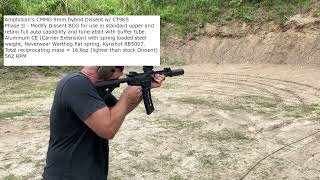

My take on 9mm M16 options: https://c3junkie.com/?page_id=361
I use my hybrid 9mm M16 Dissent every chance I can get.  My 13 yr old son also prefers this over my other guns including full auto MP5's: https://c3junkie.com/?page_id=1733
I have built several for friends and some for people I don't know.  Most of my friends also have full auto MP5's and we all prefer this over the MP5 for LRBHO, tune-ability and a nicer cyclic rate than the MP5.
Hybrid CMMG Dissent Full Auto 9mm Phase2 40rnd Exomag

I'd love a 9mm option. I've seen your website before and your write up's are great. BUT, I think it's just not applicable to me:
1. I've got 2 toddlers at home and not enough time to go tinker and shoot as it is. I need something that will work out of the box, or with a few range trips.
2. Getting it wrong and having my holes start to egg shape is an expensive experiment. My lower is from a full Colt rifle. I only say this to mean that it's basically the most expensive lower option to experiment on.
If there was an upper or known combination of parts designed to not egg the holes and work full auto suppressed, I would be all over it.
I could provide you with a turn key config that requires no tweaking if you wanted to go that route.
I run mine on my transferrable Colt 614 as do other friends on their transferrable M16's.
If you look at the high speed video I posted above and compare that to a 556 configuration, my tuned 'hybrid' Dissent is softer than a stock 556.  I think 7.62x39 is also more violent than 5.56 and many run that on transferrable lowers as well.

I thought the thing with the 9mm is its particular recoil signature and not necessary, just how hard it recoils. Let mekn ow what config is turnkey and should work and I'll try putting it together next.
Here is a link to my site again...https://c3junkie.com/?page_id=361
Please read it if you haven't already.  My custom hybrid setup is the only thing I would recommend.  If there was something else, I would be running it and so would my friends. I didn't want to have to make custom parts but I did as I wanted it so bad.  I made over a dozen for other full auto guys. I would make one for you if you are serious.  You can send me a DM / email if you are.

On the 9mm, GOT IT now. I thought maybe there was something that you came upon since writing your article. I read your article a while back when initially looking for 9mm, so I didn't read it again when you linked it. Maybe you've updated the edit since then. (or there haven't been any updates to talk about!)
