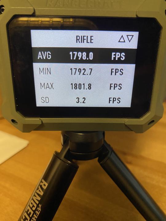

Working on a 300 grn FN/HP load currently, first time running these through my marlin trapper and here’s the results.
Marlin 1895 trapper magpul edition with 46 hybrid dtm.
New starline brass.
Sierra 300 grn FN/HP.
59 grns IMR 4064, minimum load, going to work up to max 62grns.
1800 fps
5 shot with a 3.2 SD.
Shot pretty good at 100 yds, about 2” 5 shot group.
Recoil is heavy but suppressor definitely helps tame it down.

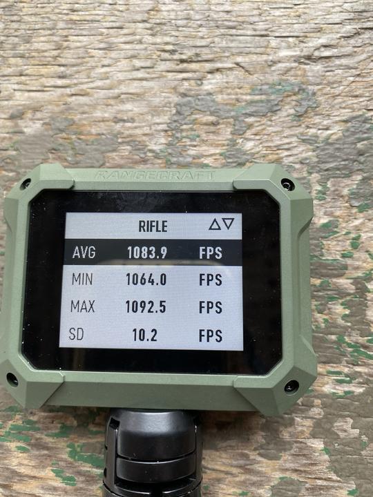

Also have a good subsonic load for it.
Hornady 410 grn subx bullets
13 grns titegroup
Would like to slow it down about 50 fps but it’s very accurate at 50 yds
First shot in the circle then adjusted and put 4 together so not sure if I want to mess with it, most accurate subsonic load I shot so far. Shot this load in the winter and will try again in warm weather to see how much velocity changes.

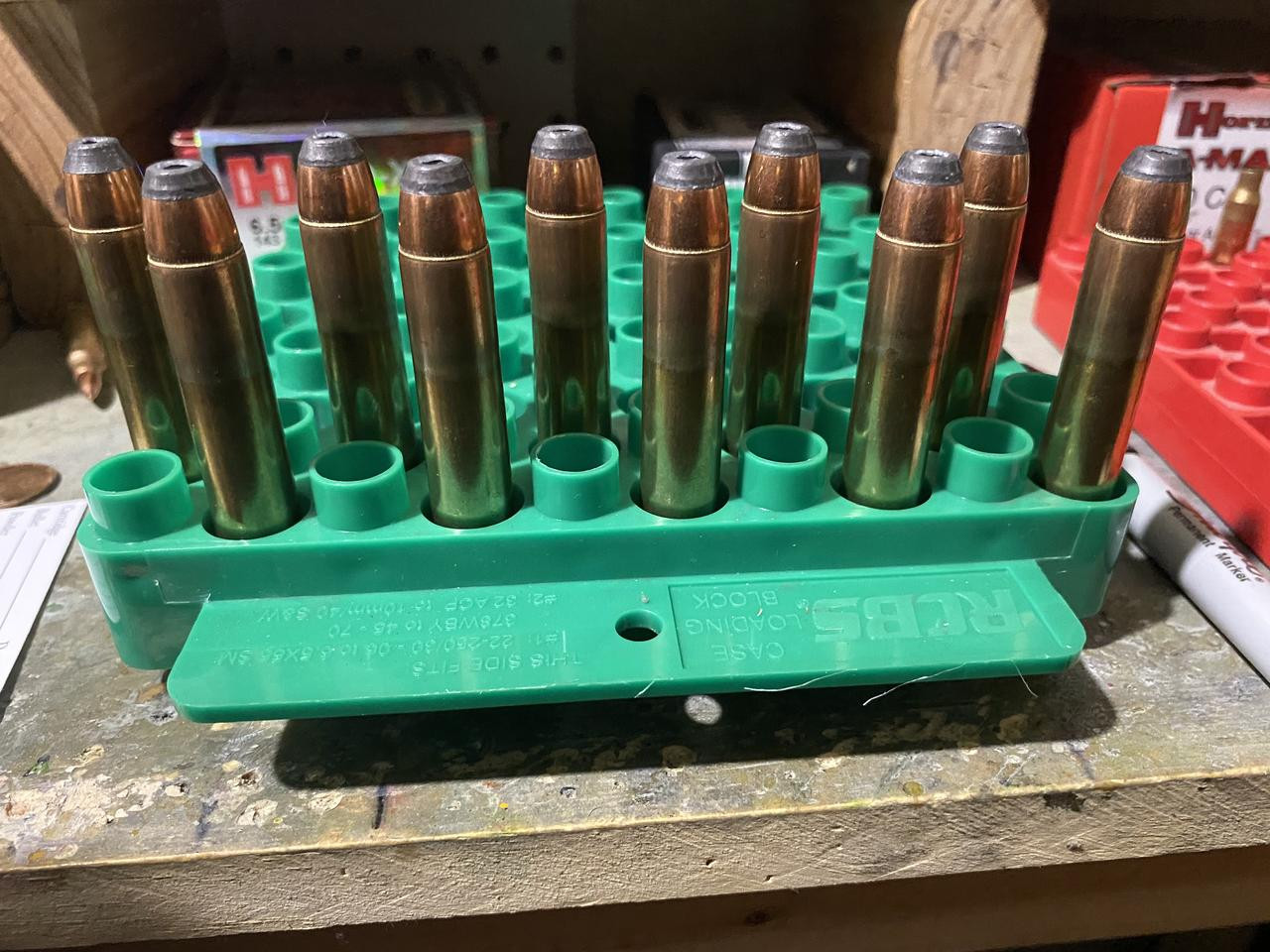

https://www.ar15.com/media/mediaFiles/857/IMG_2131_jpeg-3757132.JPG
I’m glad they changed that lever to something bigger. Mine is too small. Damn thing was cutting me on recoil till I took the dremel to the edges.
I’ve been loading the 410 grn subx flex tip with standard length brass, no issues, feeds and shoot great.
