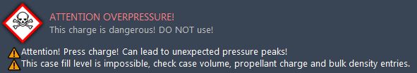

Let me clarify what I used in the calculation.
42.9 gr of IMR 4166
190 gr SMK
2.820" OAL <-- check this one carefully, bigtex84!
GRT says peak pressure was 63,820 psi.  In a 24" barrel, that yields 2591 fps.  This is over the max allowable for 308 W.  Also, the powder was not fully burned before exiting the 24" barrel.
Dropping down to 41.5 gr gave 57,384 psi and 2508 fps.  This gives you about 5% margin below the max allowable for 308W.
GRT would not even run the 42.9 gr/2.280" condition.  The error message said some thing about "the moon".
At 2.400", GRT would run.  The estimated pressure peaked at 93ksi and 2734 fps from a 24" barrel.  <--  check this one carefully, bigtex84!
That run came with this warning.
When I use IMR 4064 and the 190 SMK (my favorite long range bullet), I get 2575 fps using standard Winchester brass cases.  It's a hot load but doesn't require special cases or 90ksi to get that extra 160 fps.  Perhaps, that's something you should consider.  Or not, it's up to you.
42.9 gr of IMR 4166
190 gr SMK
https://i.postimg.cc/B6gdTKkX/Warning.jpg
Awesome thanks for the info I did whoopsie the oal.  Should be 2.280 max magazine length.  I’ll be shooting these out of a 16” barrel.  I went back and check what I actually loaded and I only went to 42.1 before I chickened out.  If I had to guess I’ll get about 2450-2475 fps if I’m lucky.
8/3/2026 8:12:57 PM EDT
[Last Edit: Trollslayer][Edited] [#27]
2.280" may be your max magazine length, but what OAL did you use for these cartridges?
I used 2.82" and 42.1 gr of 4166 yielding 2318 fps from your 16" barrel with peak pressure of 60.0ksi.
I load the 190's to 2.895" OAL (0.020" off the lands).  My Remington's magazine is 2.830" max, so these are single load only.

I have lost some faith in the GRT basic calcs...
I have noticed that no matter how precise my initial data is, if I don't have actual V0 readings and then run the post-range OBT for that charge, the (5.56) estimated psi (and fps) is way off - usually low (by as much as 10kpsi/200fps) - so now I still do the base work-up calcs but try to keep my base kpsi about at the -20% pmax line - then I take the actual oal & h2o of the fired cases to generate the OBT... surprising the difference from the base calc.  I'm finding up to 12%+ difference in some loads, probably due to poor powder models for some popular US powders
8/9/2026 10:47:57 AM EDT
SNIP
I think you hit the nail on the head here.  GRT’s models come from crowd-sourced data, and some popular US powders have as few as ONE data submission.  More submissions from more users helps make the modeling more accurate.  LOTS more can make the models more precise.
GRT for common powders in common rounds running common loads within common pressure levels, is fine.  Anything outside that ,it's worse than useless, as usually wrong and giving bad estimates.
It's terrible at 6.5 Grendel.
