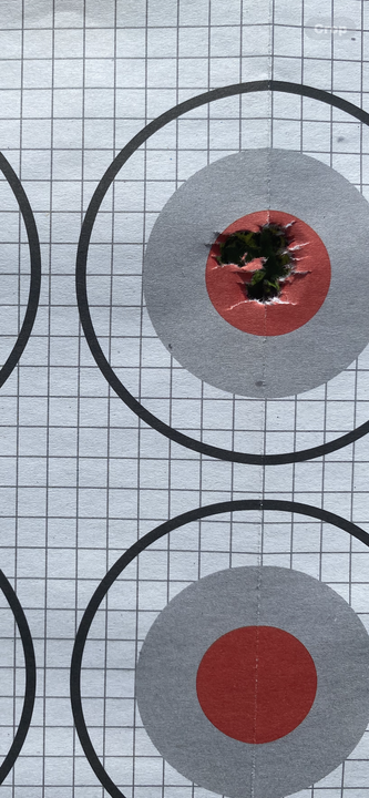

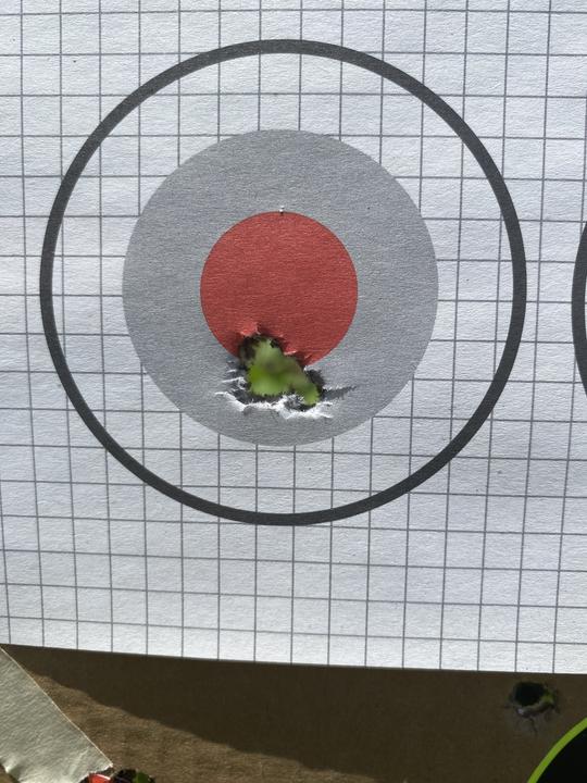

Got out to the range today. After my break in rounds, decided not to try my 200 gr loads. Used my 168 Amax loads for my AR10’s. Very accurate. Will load up some 178’s to see how it goes.
8/31/2025 9:14:30 PM EDT
The 178’s sucked. Will try 178 ELD X, 190 nosier and my 200 gr ELD X to see how it goes.

The 178’s didn’t do very well. Came across the Hornady 174 ELD-VT. Wow, what a difference. Surprised it’s a varmit bullet. High BC too.

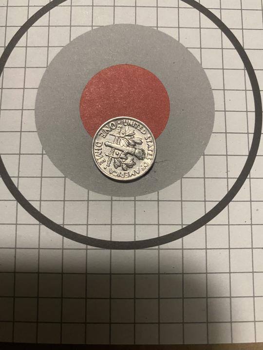

I have a rock creek 5R in that twist that is a laser beam, with 175’s and 178’s
