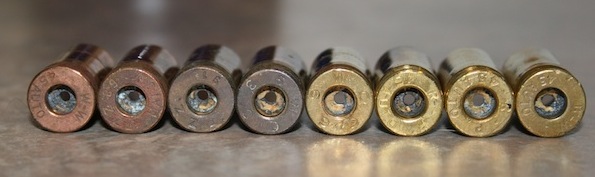

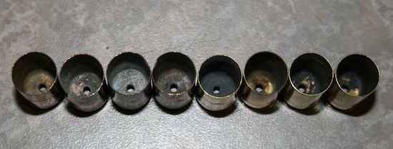

I had some nasty cases:
But after only 90 minutes...
The nastiest cases are kind of pink, and their primer pockets didn't get as clean as I'd like, but considering how horrible they were?  Fantastic!
These were the only ones I was sure were in my "before" picture...

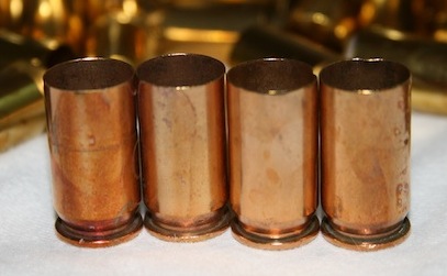

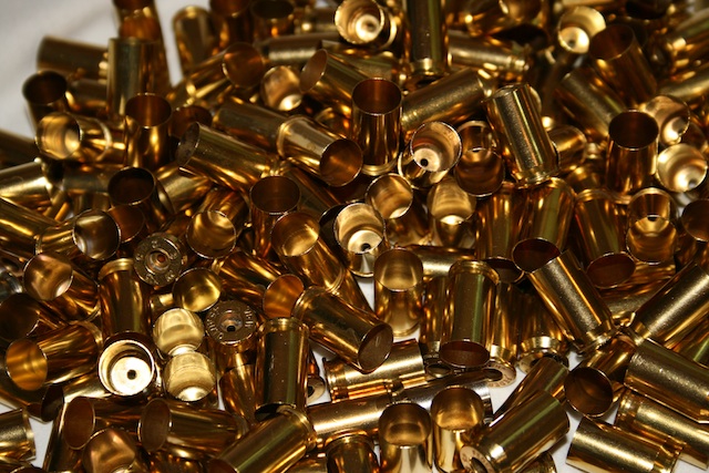

Just another guy saying "Thank You for the write-up" dryflash3!  (and everyone else who provided additional info in their responses)
Vibratory was doing it's job, but despite my best efforts (dryer sheets, suspending a vacuum over while dumping, etc) I was not happy with the amount of "dust" I had to deal with.  I don't have a garage, nor outdoor workshop... and didn't want to have that stuff in my living space.
Tried ultrasonic... meh, it worked for surface filth.  But how could one resist all the bling pictures everyone keeps putting up?!
Oh yeah... lack of funds = effortless resistance!
But... saved up enough nickels and dimes to get the Thumlers+Media package from Brownells/Sinclair.  After reading the instructions and various other recommendations, broke out the Lee Universal decapper and deprimed 1000 45ACP cases.   Used the cut-up 2L to measure the brass count, added a gallon of hot water, 3 second squirt of Dawn and a 2L capfull (since I lack the fancy 45 case scoop) of Lemishine.   Timer to 4hrs, rinse 3 times, lay out on towel to dry.  Thing of beauty!
However, the decapping was not going to work out for me.  As nice as it might be to have shiny primer pockets, with a 13mo old I simply don't have the time for the "added step" of depriming beforehand.  So after that initial batch... decided to skip that step.
Starting on a 2000ct 30-06 batch.  Keeping primers in.  After rinsing and spinning in the media seperator, I dump the brass in a lasagna tin and slap in the oven (at 200°) for 20-30min.
Brass looks better than new... and no more dust!
The aforementioned 13mo old has kept my progress at a minimum... but after reading some other responses and the luck some folks have had with shorter tumbling times, I may drop my tumble-time to 90-120min vs the 4hrs for future batches.
Only 10-11K more cases to go!
(Obligatory before/after/in-progress pics):

so i got my tumbler last week. i ran 9mm cases and they came out AMAZING! then i ran some .308 cases (had nickel mixed in) and it seems that they came out a little darker than my 9mm cases. i then tumbled some 45 cases (nickel mixed in as well) and they came out darker.
anyone else noticing darker cases? could the nickel mixed in have something to do with it?
2/25/2012 10:41:01 PM EDT
How big is your tumbler is home made , if so you may need to add more limi shine. I have heard if there is any steel cases in the batch they will be darker. I have also noticed if I don't wash off my sizing lube they don't come out as shiny.  good luck
