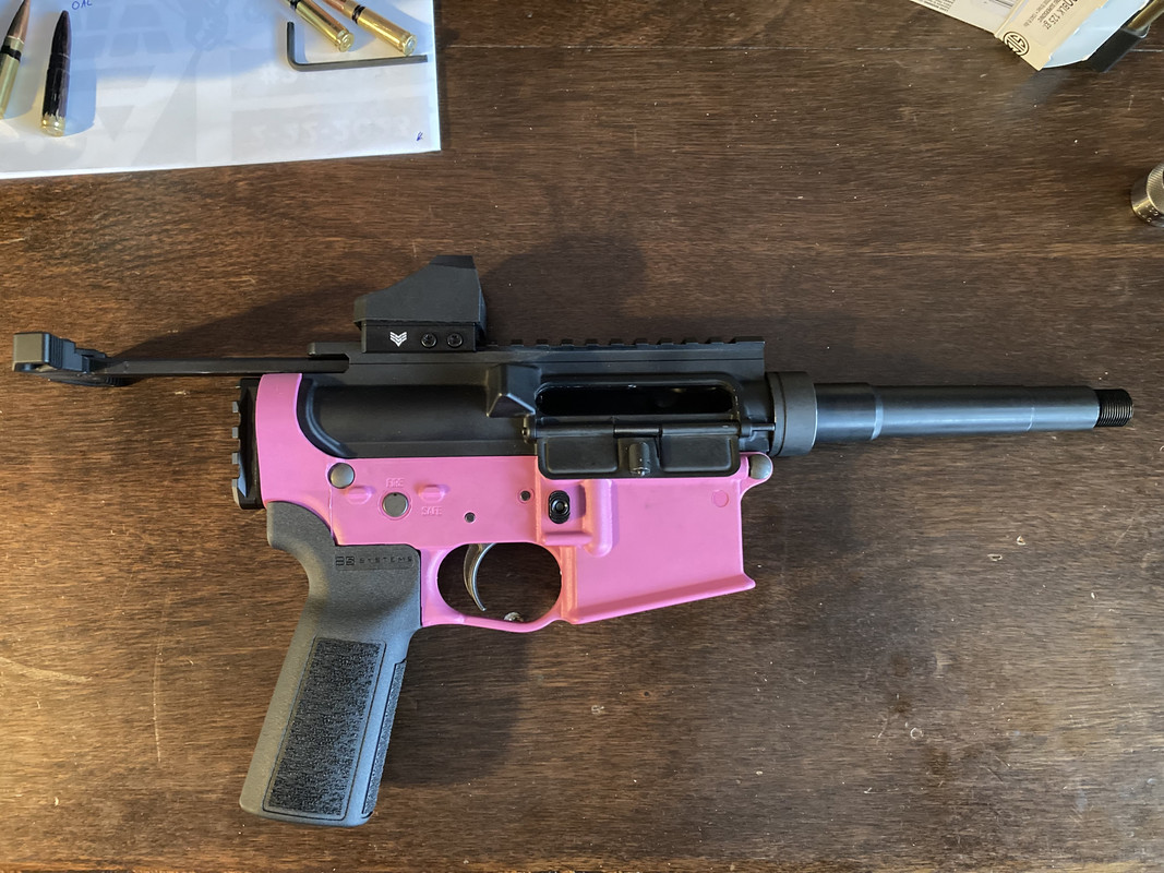

Build a straight pull ar15.  You can build it how you see fit and spend as much or as little as you want.  I tossed this toy together with spare parts and Tennessee arms plastic lower.  It’s stupid fun and everyone that shoots it has a smile on their face.
Specs for the build:
6” ballistic advantage 300 blackout barrel with gas port welded shut.
Some cheap barrel nut I turned down on the lathe.  Cut a notch in barrel nut and made a custom wrench for it.
Tennessee arms plastic lower.  Has brass inserts for the buffer tube and grip screw.
Slick side upper receiver.
Cheap BCG I cut the back half off.
KaliKey installed on the BCG.
B5 23 degree grip.
Swampfox red dot.
Pic rail adapter plug.
The KaliKey makes it easy and you don’t have to cut a slot in the side of the upper receiver and thread the BCG for a charging handle.

Driving around today I started to think how cool it would be to build a short barrel bolt action 300BLK with the barrel profiled for an AE M24 suppressor and the stock inletted to fit around it.
11/28/2025 4:33:00 PM EDT
[Last Edit: ropin4gold][Edited] [#44]
I’ve got the RAR gen1 and I don’t have the mag issues that you are experiencing. Guess I got a good one.
I run the short pmags in it. Love this thing.
Here is my Grendel. Guess I should SBR this 300 also.
11/30/2025 8:18:50 AM EDT
It would not be difficult to do.
I dont think this is a brains type of operation.
