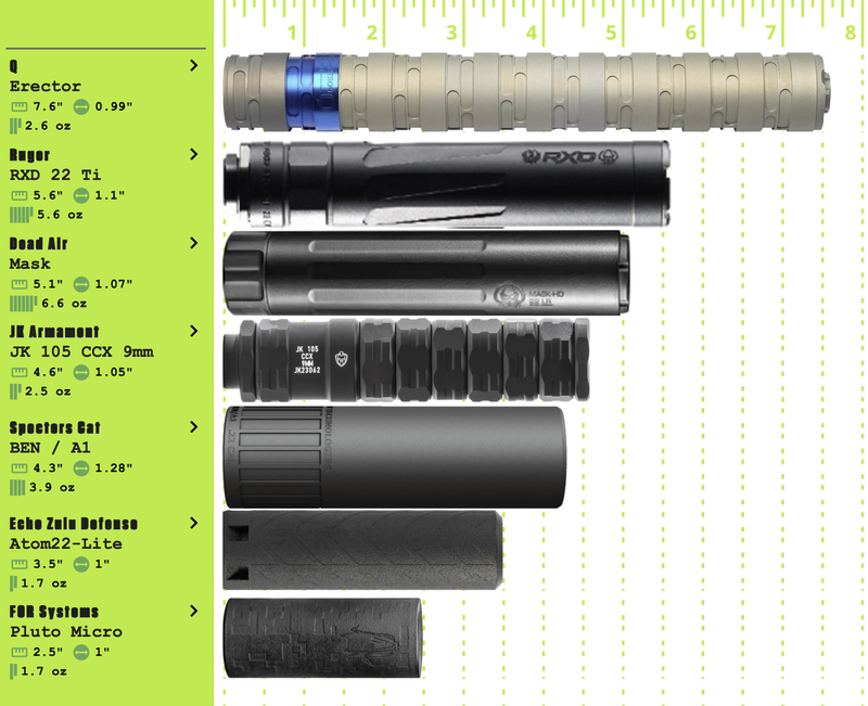

Most .22lr silencers are around 5". The most popular cans on the market (Sparrow, Mask) are right at 5.1".
Then you've got behemoths like the AB Little Bird and Q Erector* (6.9" and 7.6", respectively).
There's little cans like the Bowers Bitty (2.8", TacSol Aeris (3.0"), Pluto Micro (2.5"), etc.
Do you feel like there's a length — either too long or too short – where they just get too silly-long or ineffective-short?
*Yes, dear, I know that you can shorten the modular Erector.
(Edit to nod to CanContrast.com)

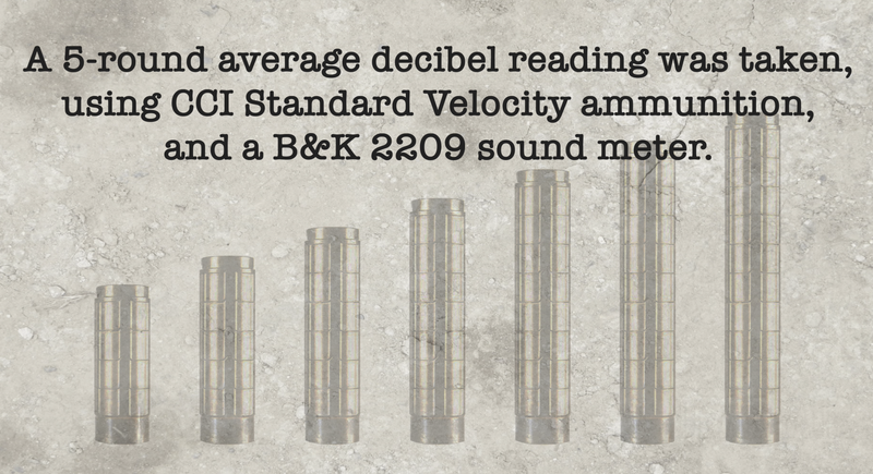

I was kind of curious how much I could cut down or add to a Mask, and where it got better or worse.
Dead Air Mask-HD: How does it sound with fewer baffles?
(Dead Air MASKs of different sizes.)
Sweet spot, to me, is one baffle shorter. Longer mods showed very little improvement over stock length.
Conclusion is that you don't have to get longer than 5", ever, and one is able to further optimize a 4-4.5" ish length can to equal what the 5's are doing.
I haven't seen anything shorter than 4" that does as good. I don't have a CAT BEN, probably should pick one up to see what that does.

I'd gotten an opportunity to meter the DeadRuger RXD22 before it was released. Compared it head to head with a Mask. Didn't see the added length of the RXD appealing when the shorter Mask basically did everything well. You've seen that video of the Checkmate HD vs RXD: I don't think the added length of the RXD is buying any performance there. To me, CM wins on envelope/sound ratio.
Originally Posted By Green0:
The mask video was neat- odd they didn’t publish numbers for mask plus 1 baffle.
From the video description: "Spoiler: The longer mod versions basically didn't do a darn thing. It's already very well optimized."
