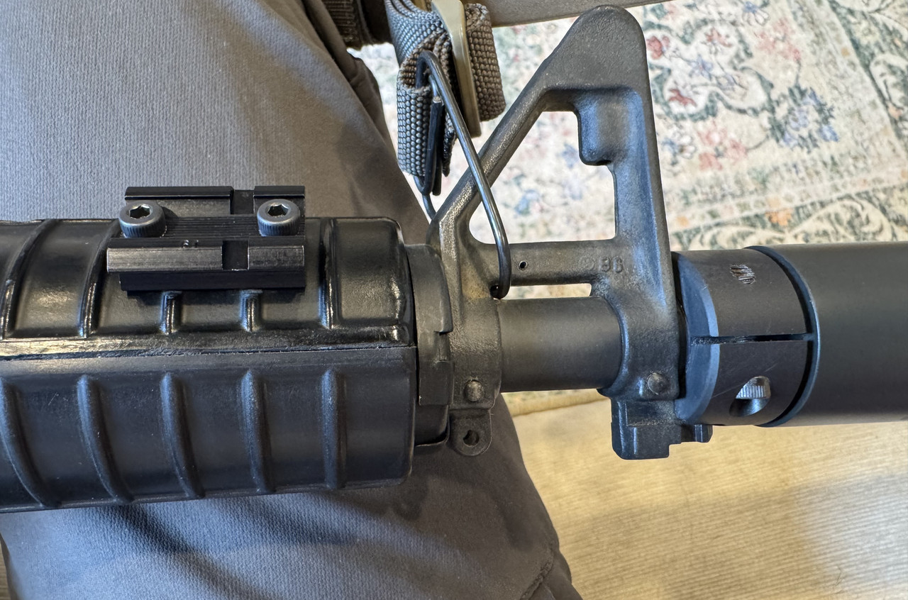

I never did the movie style barrel/FSB mounting but here is how I mounted on the handguards if interested. 61M weaver mounted using M4-.7 16mm cap screws drilled thru guard and heatshield.  Drilled small pilot hole then removed heat shield and drilled separately for clean holes. Used #6 washers secured with M4 nuts and red threadlocker. Took the ribs down with dremel for flush fit. Still solid after about 3k rounds thru it since install.

Did the same, but with a bit less finesse

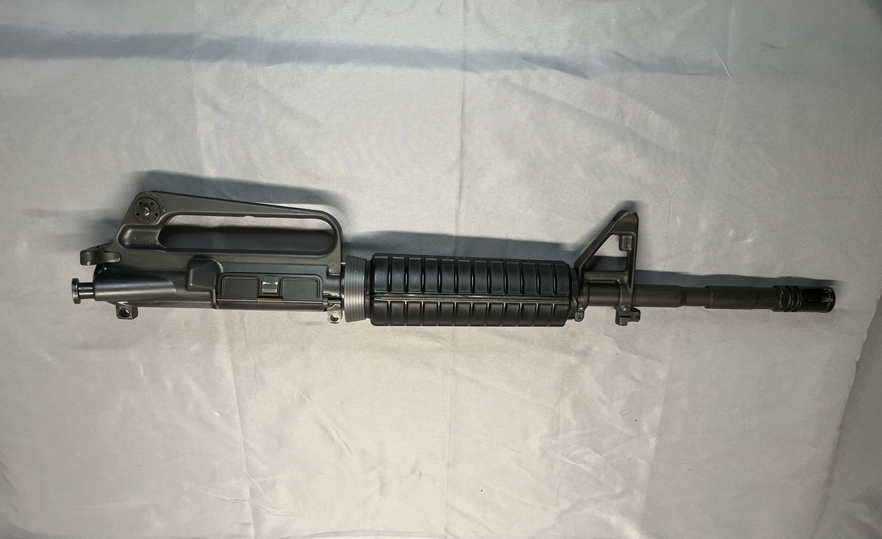

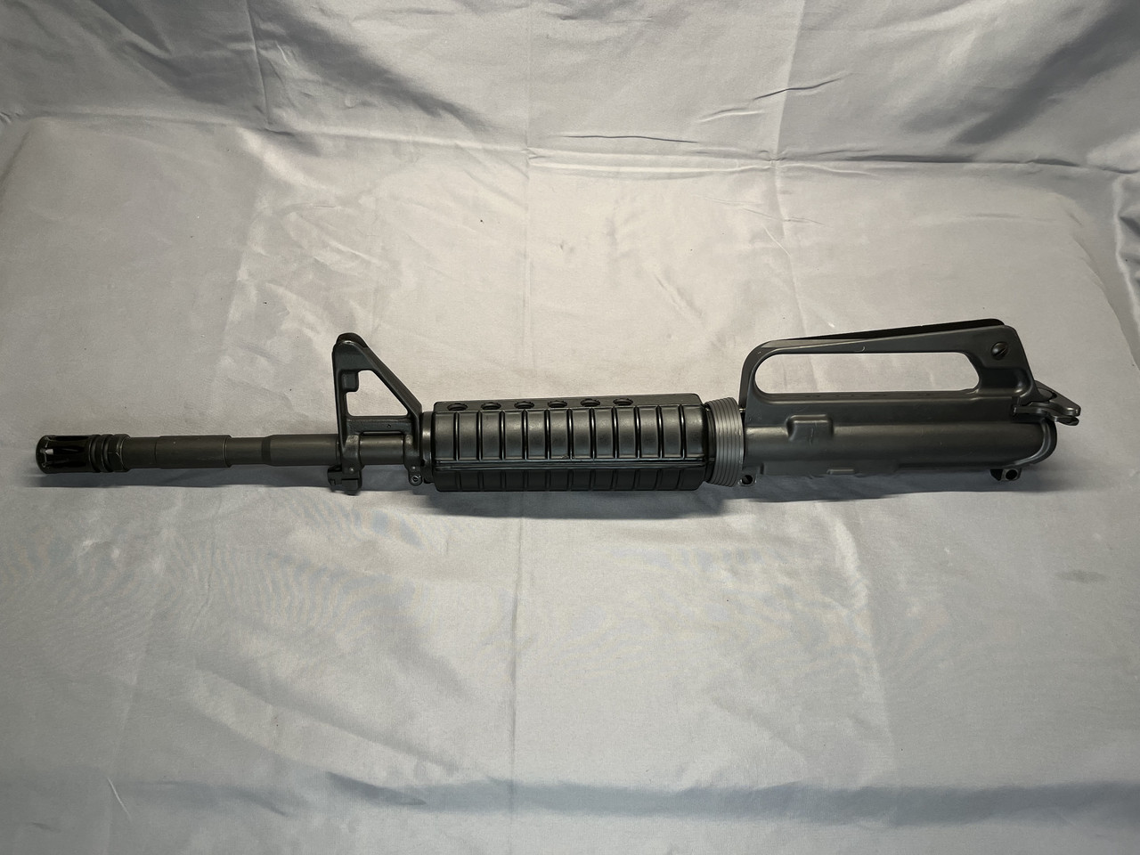

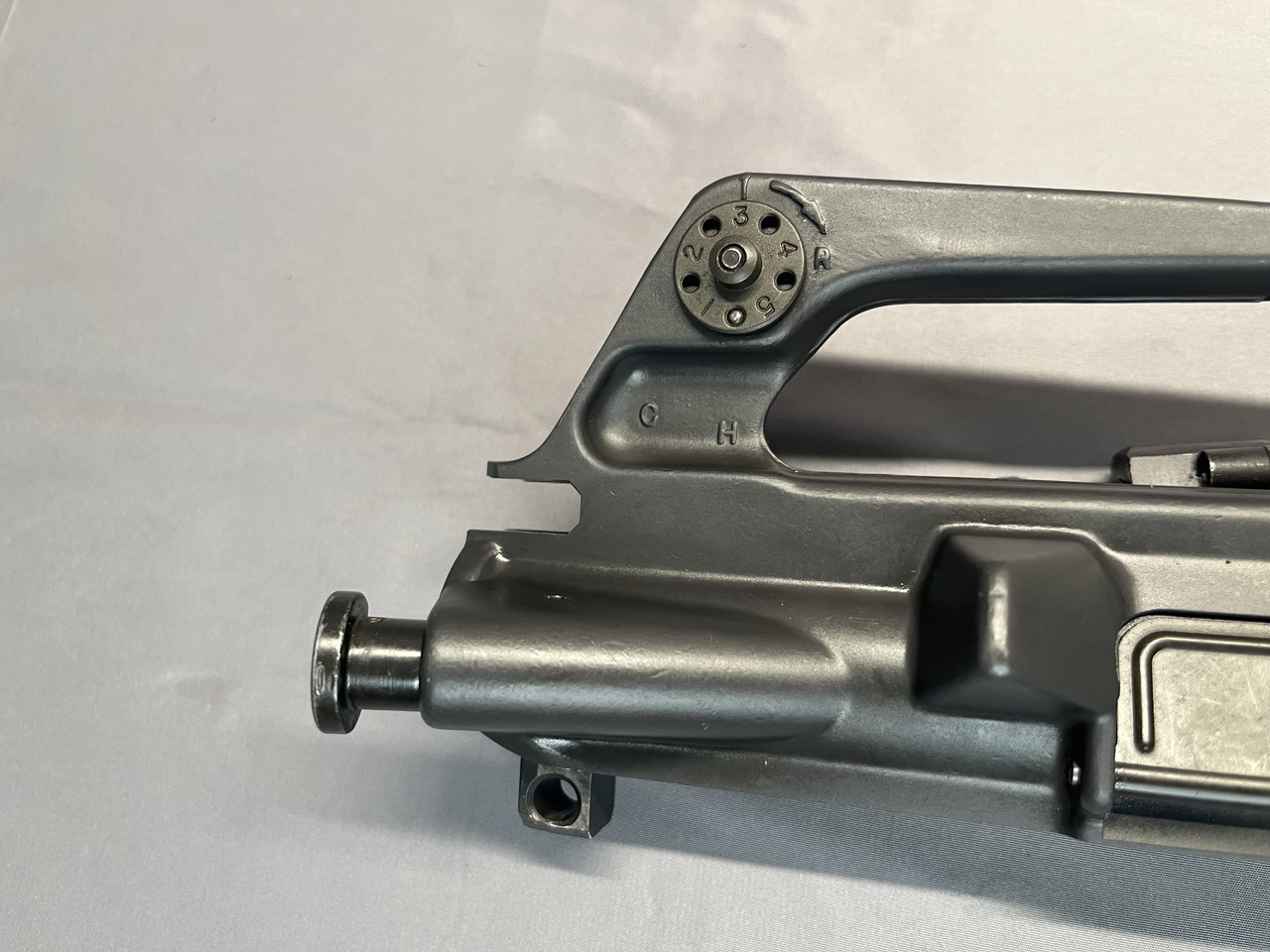

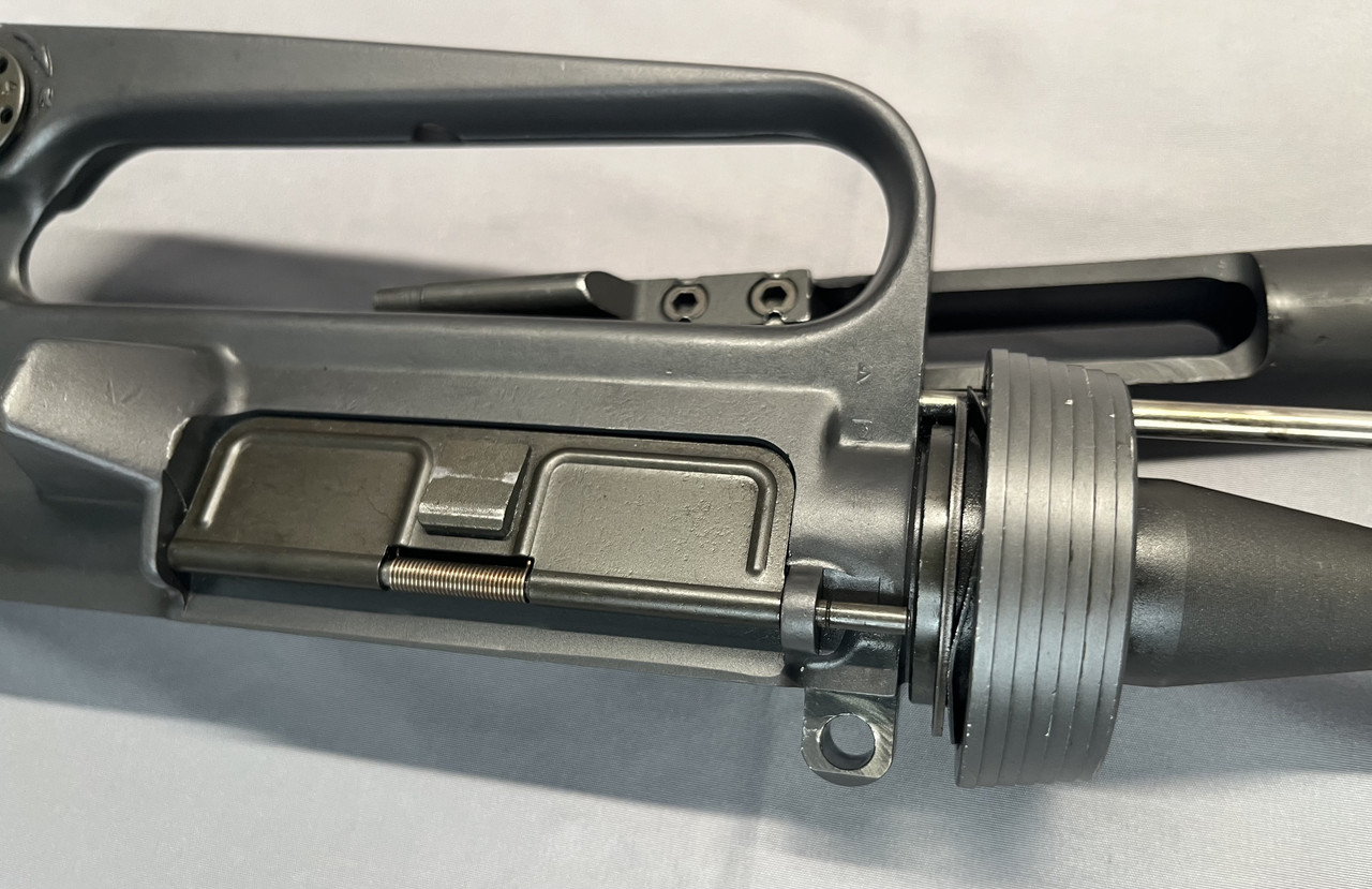

Genuine late  1980s or early 1990s  Vintage Colt 723 Complete Machine Gun Upper Receiver
Sharing because it's old and cool and I figure some of you guys will appreciate it. Plus this thread hasn't had much activity lately.

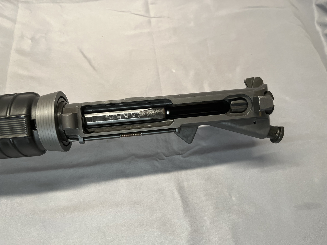

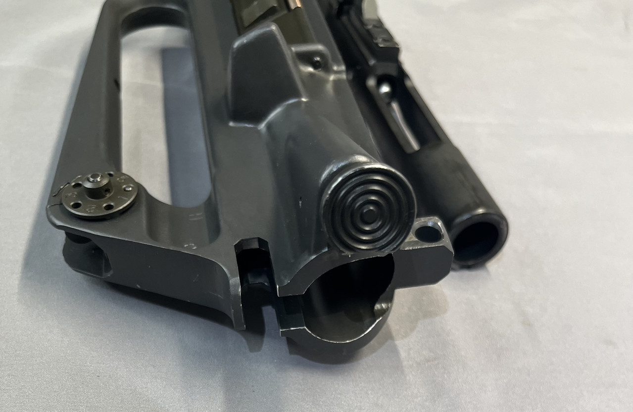

Very excited to get my grubby little hands on this Original Upper Receiver. The seller told me it was a Police Trade In, but not from which department it came from. Unlike most Police trade ins, this one's in really nice shape. There are a couple of marks on it, but the anodizing is a beautiful deep Grey, and is as smooth and even as the Parkerizing.

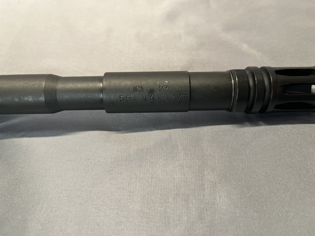

Looking with my bore scope, the barrel has plenty of life left, and the gas port looks good.
The markings make me guess it's from the late 80s or early 90s. Parentheses around the (C) on the barrel may put it on the earlier side.  It has Colt Harvey forge marks, Colt Squared and Verified Proof and a milspec front pin lug, a full auto sear cut, a full auto C marked Bolt Carrier, a peel washer and what appears to be the shallow early feed ramps.

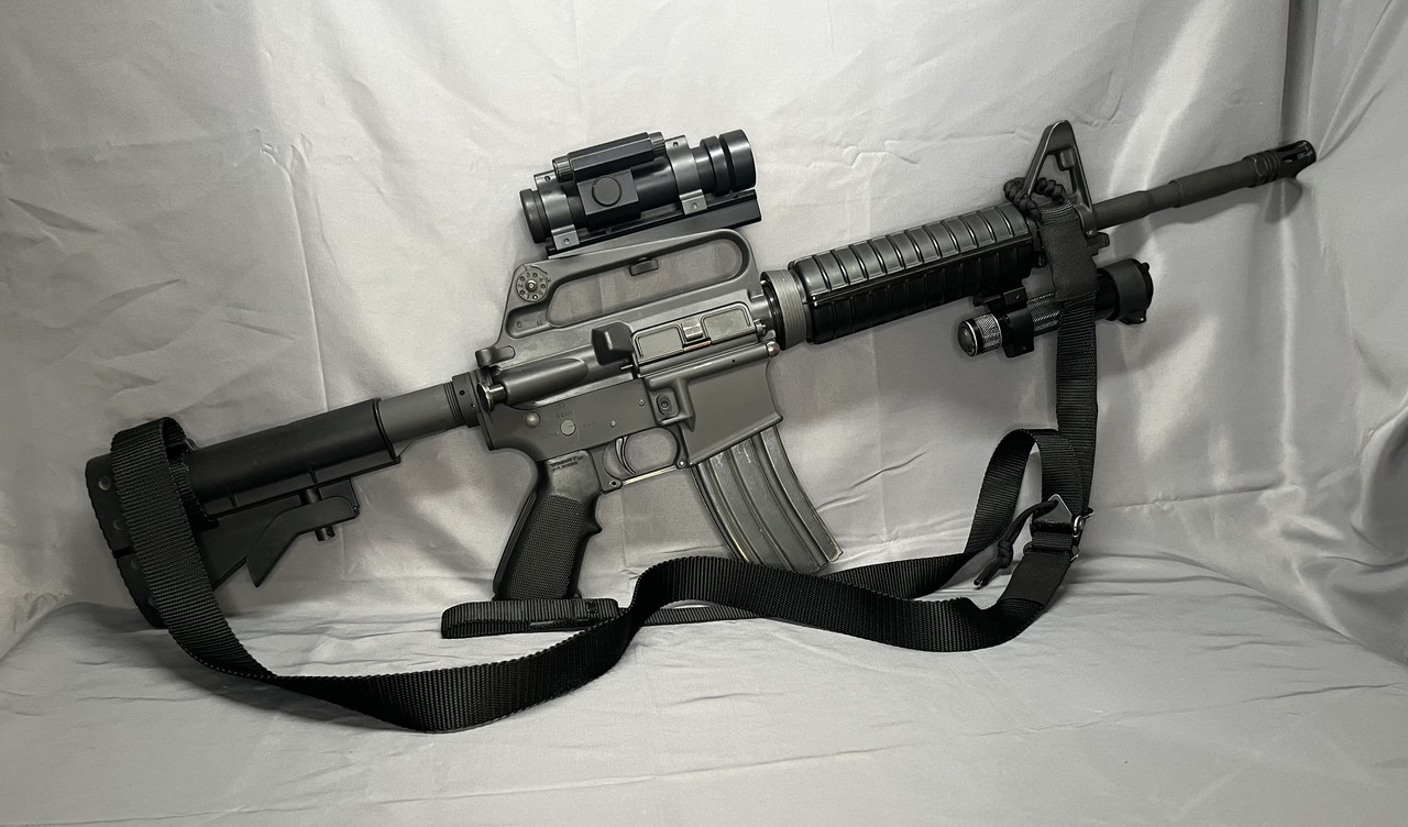

This thing will really take my Gothic Serpent Delta Clone to the next level.
