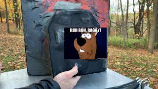

Used here against an RF 2 plate :D
Militech Armor; Is this the best NIJ III++/RF2 Plate on the Market?
