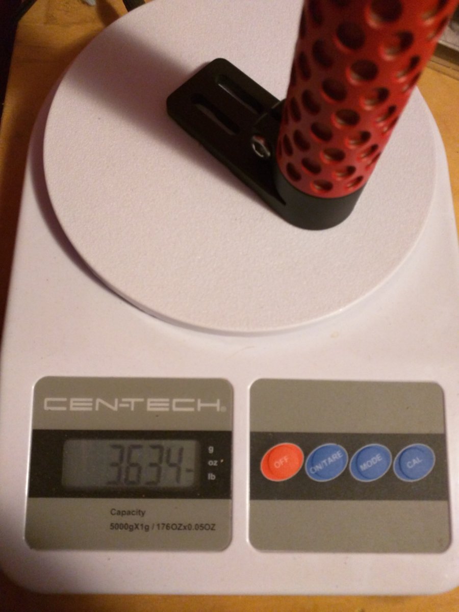

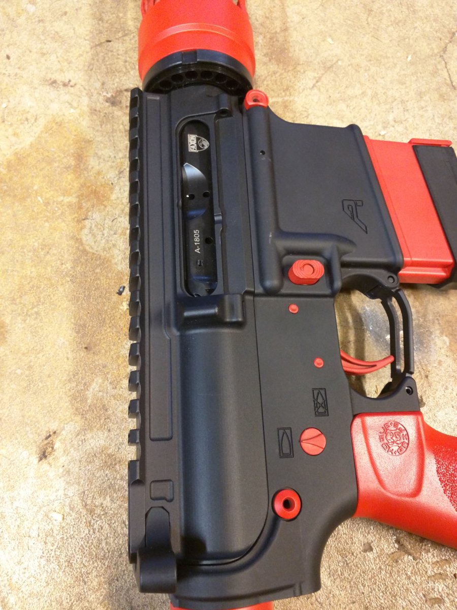

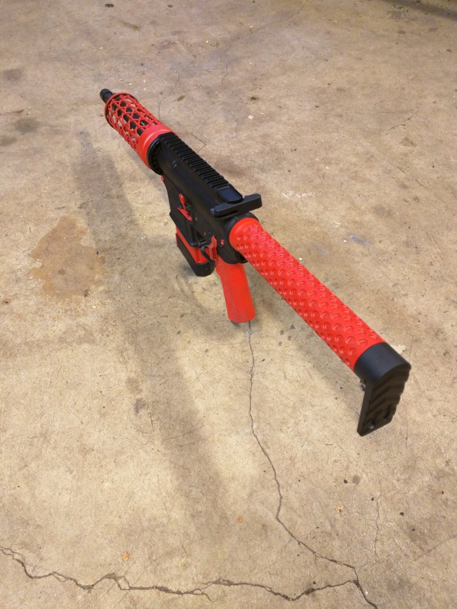

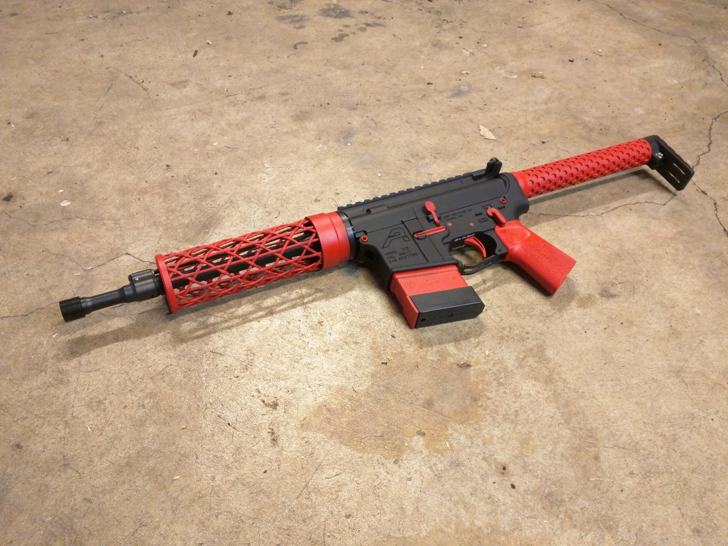

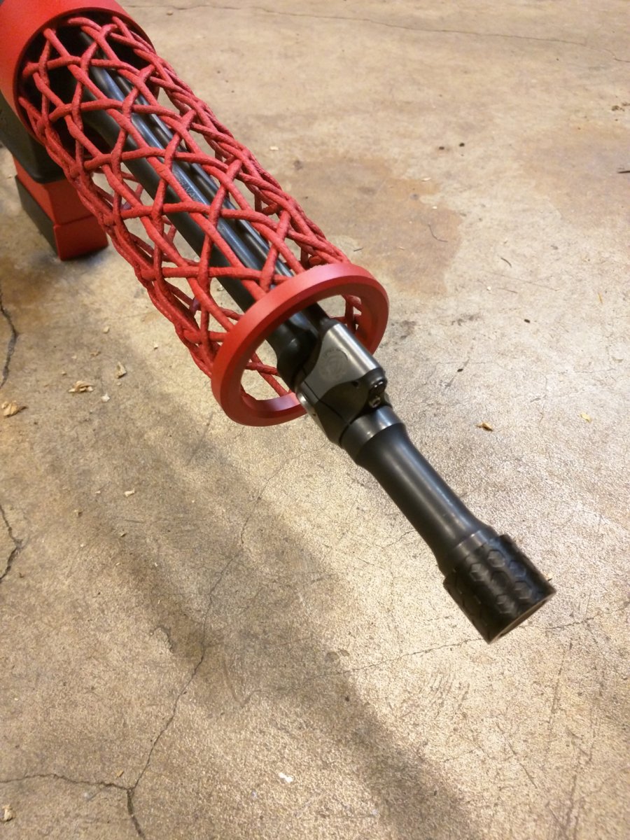

My very long term project is nearing it's end. LW SBR...
Without mag: 3.47 lbs
With mag: 3.63 lbs
Not bad. Had a hell of a time with this build, even if it did take FOREVER. With a CF stock, a Ti carrier, and a different lower it could have been 3 lbs or even less, but I had my reasons for compromising weight at times. I basically chose to keep everything 'out front' as light as I could possibly get it. Haven't shot it yet, but it's going to take some getting used to with respect to transition speed. It's craazy light in front.    Now....time to select and RDS and mount. I was going to go with a Shield, but I'm having second thoughts. Might just run a vortex or FF3. We'll see. Whatever it is, it'll be light.

7/28/2017 5:58:37 AM EDT
[Last Edit: larrys][Edited] [#7]
Great looking build! I like the color combo.
What trigger gaurd is that? Looks like a solid pin on the front.
Is that the lowest weight on this thread so far?
7/28/2017 8:31:28 AM EDT
[Last Edit: jekbrown][Edited] [#8]
That is a damage industries "thin" enhanced TG that I had a 1/4" slot milled into. The final weight was slightly  lower than a standard milspec trigger guard, which may be decades old but is still one of the lightest on the market.

9/26/2017 10:55:47 PM EDT
Originally Posted By larrys:
Finally finished this build.
All metal stock, receiver and handgaurd. The final weight came in at 3.825 lbs. with red dot but no mag.
Haven't shot it yet, hoping to get it to the range this weekend.
https://www.dropbox.com/s/3pvf1h2w6mc05zm/Photo%20Sep%2014%2C%2011%2053%2049%20AM.jpg?raw=1
https://www.dropbox.com/s/oc9blt2b3vra2hu/Photo%20Sep%2013%2C%201%2038%2011%20PM.jpg?raw=1
Nice!
Please update when you have a chance to shoot it.
