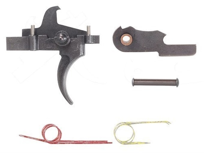

I seem to remember the seller said this is a JP Speedhammer and trigger.  I would date the rifle it came out of in the mid 90's.  Does this look like a JP?  It is a large pin version out of a Colt.  I want to put it on the EE and be accurate with my description.  Thanks in advance.

Looks like a Colt set. Trigger may be nickel plated and pin holes might be for either the .154 or the .170 diameter pins.

I agree that does look like a Colt set.
JP Speedhammers have historically looked like this, regardless of pin size.
Their Competition Trigger Set would have adjustments in the trigger.

OP, your set looks a lot like an earlier version of this.
Colt Upgraded FCP Kit

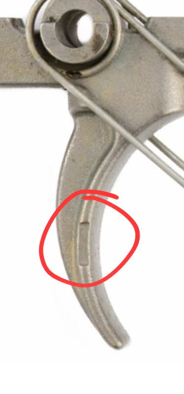

OP, your disconnector is a Colt / Schmid Tool component.
Your hammer appears to be modded (possibly?). I have milled the hook portion off several for friends that wanted a low mass hammer. Any markings on the hammer?
Does your trigger have these flats in the picture below? Every modern Colt trigger that I've seen is cast like this.

Trigger looks like one of the older M marked ones. I doubt it would have the flats like the newer ones cast by a different company. I think the M ones may have been done by Milwaukee Precision.
They show the parts just not in a group in the Colt repair manual.

This came out of a Colt Hbar carbine I traded for a while back.  To date it, the BCG carrier is the completely open wound type, not an AR cut or M16.  The lower has the high shelf web sear block rather than the hardened sear block insert.  It is an LE restricted marked lower.
I had no idea Colt sold upgraded FCGs.  It does appear to be a dull nickel plating.
I might just keep it now.

OPS is a vintage large pin Colt trigger, I forgot what it was called but it’s the same one that came in 24” match rifles, which I also forgot the name of
The rifle would be the CAR-A3 HBAR ELITE

Mix matched components regarding the finish?
I recall them being matched, like so: (but my memory is definitely not what it once was).
https://thecoltar15resource.com/2022/10/16/colt-upgrade-trigger-kit/
