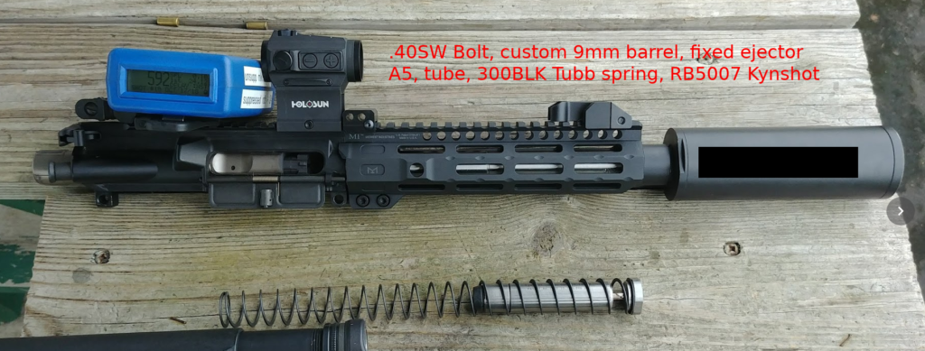

Quoted: I reload all my 147, and I reload it hot. 3.7Gr of Titegroup (max charge is 3.6). That is still subsonic even out of a 10" UZI barrel here in FL. Don't know if you've seen all my posts on the Gemtech MK9K, GSL Phoenix and the Curtis Tactical CT9KS. I would go with the CT9KS over all those options. Shorter than the MK9K / Phoenix. Lighter and completely serviceable and NO ALUMINUM like the MK9K and Phoenix. Documented here: http://www.c3junkie.com/?page_id=244 http://www.c3junkie.com/wp-content/uploads/2020/05/300BLK-A5-9mmKynshot-40SWBolt-CT9KS-1024x389.png The only thing better than that can is the bixler mount! |
