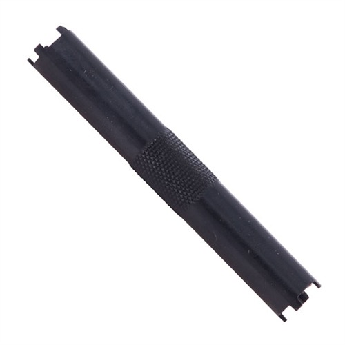

I have a Samson Hk style front sight and my front sight tool won’t fit within the two front sight posts. Does anyone know of a thin stem tool? I’m using the standard metal tubular version now.
4/12/2023 11:04:17 PM EDT
Brownells has this one  https://www.brownells.com/tools-cleaning/general-gunsmith-tools/wrenches/ar-15-sight-wrench/
Another option is the Fix It Sticks sight bit  https://store.fixitsticks.com/collections/ar/products/a2-front-sight-bit
