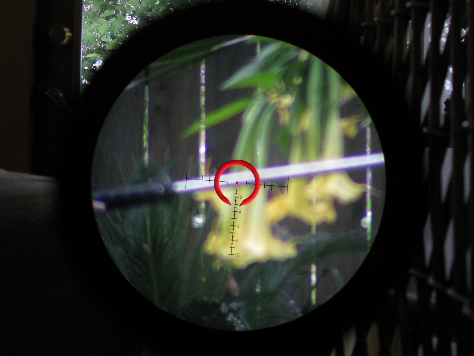

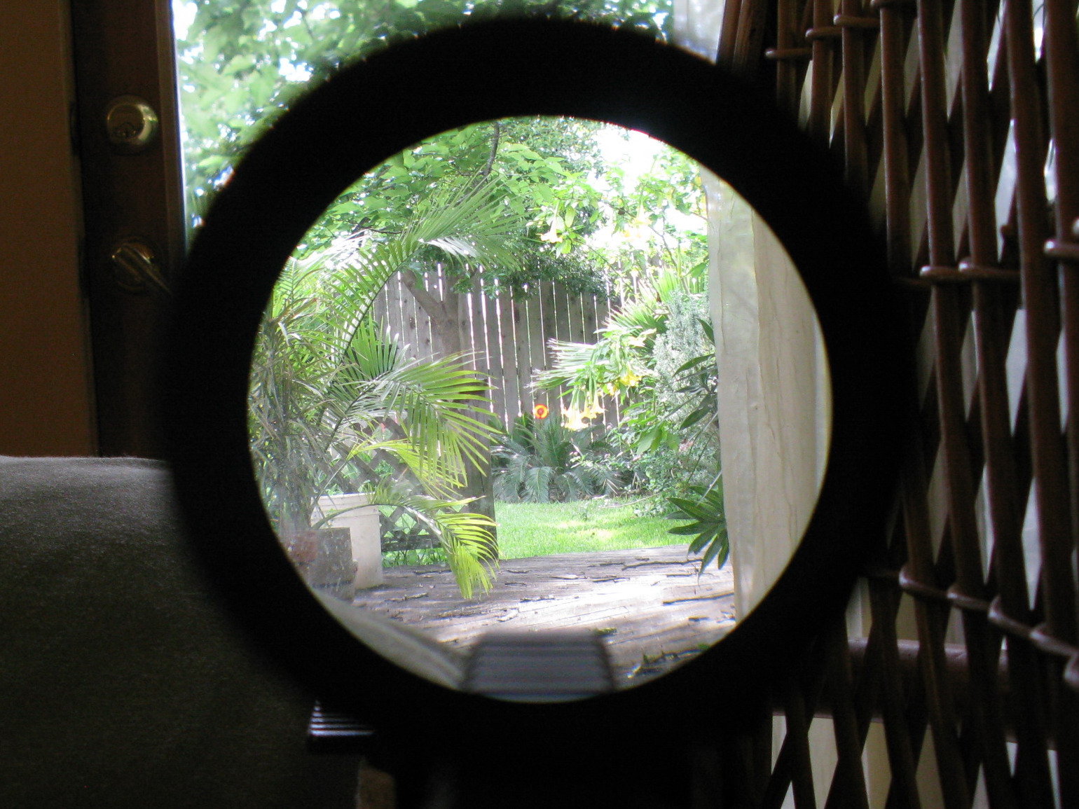

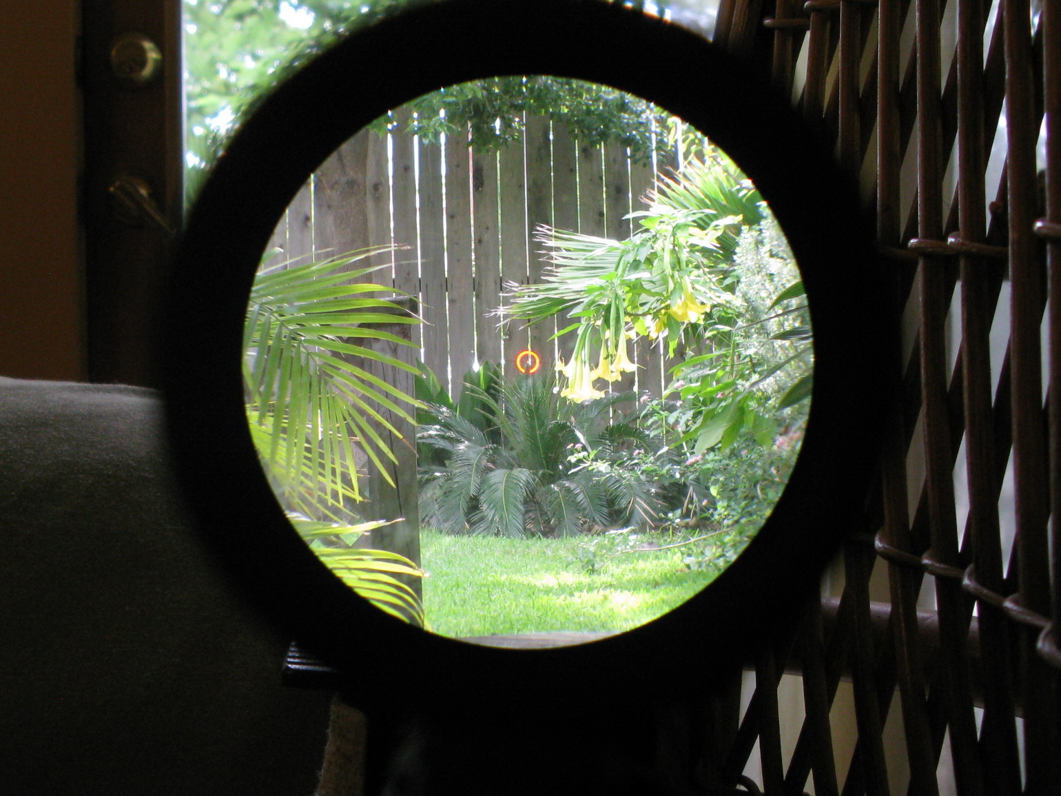

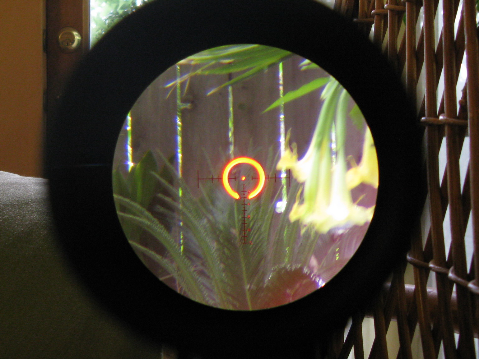

Here are a couple images thru the Bushnell Tactical 1-8.5x. The first photo is at 1x. The second is at 2x. The rest are 8.5x.
1x at 9 brightness
Here is 2x at 9 brightness.
Here is 8.5x at 9 brightness.
Here is 8.5x at 5 brightness.
I'm glad to have FFP for mixed distances on same stage. I don't like having a different tick mark for each zoom factor.
Sometimes I forget to change to right zoom to line up the right vertical hold.

Reticle Description, Close Quarters Performance, Explanation, and Ranging:
March-F 1-8x24mm focused on a tree line at 100yards
The March-F 1-8x24mm that I tested was equipped with the FMC-1 reticle. It consists of three main parts. At 3:00, 6:00 and 9:00 are thick tapering arrows that extend to the edges of the field of view at all powers. These appear to be a feature designed for low light, and close quarters use. They are large enough to make themselves obvious. In the middle of the reticle, a 3mil diameter circle is present for close quarters use. This circle, and everything in it, are the only illuminated portions of the reticle. Lastly, crosshairs display mil hashes on all but the 12:00 extension for ranging and holds. All in all, the reticle departs little from a typical mil hash design and is intended to be used as such. Ranging is done by counting the mils and running the equations in the manner of most long range scopes. Drop is primarily intended to be done via the elevation adjustment as on most precision rifle scopes, though you could also hold using the mil hash marks for guidance. Wind can be done via holds or adjustments, though I am quite sure the dial for drop and hold for wind method would be preferred by most. In short, it is a long range scope reticle with a circle and thick posts added. Not surprisingly, when measured on a test target, the reticle mil marks were the correct size.
Comparative Optical Evaluation:
It has always been somewhat difficult to compare the optics of March scopes to those of other makers. The reason for this is that, while most makers strive to make the user's experience comfortable with a large eyebox; March cranks the magnification ratio up - user experience be damned. I was happy to see that, in this iteration, some balance has been achieved. The scope is more forgiving than past examples and I found it of at least average comfort compared with the other 1-8x offerings. Furthermore, March is the sole maker to have a 1-8x offering with an adjustable parallax. At most distances this greatly improves the user experience vis-à-vis not having one, as this allows both the reticle and the target to be in focus at the same time.
As for the clarity, the March trailed only the Leupold CQBSS in this area. And that only slightly. It took me a while to decide this and I am still obsessing a little as it can be hard to tease apart the effects of a more comfortable eye box and warmer color from the simple ability to resolve. In any case, the March was obviously better than both the Bushnell and USO offerings. The color rendition of the March appeared, on balance, the most true to reality, with the Leupold tinting the image a bit warmer and greener and the USO tinting it a bit cooler. The clarity of the March was excellent edge to edge and only a slight pincushion distortion was noticed at 8x. The overall experience was quite good.

Illumination Evaluation:
Prices for the 1-8x24mm March are  $2,100 without illumination and a disproportionately higher $2,720 with illumination. My advice:  skip the illumination. To say that the illumination is not daytime bright is misleading. The illumination is not daytime visible at all. I am embarrassed to say that initially I thought it might be broken or the battery had died. I changed the battery to no avail. Since I was at Kelbly's doing the testing at the time, I walked in and asked how to turn the illumination on thinking maybe I'm just a fool or perhaps there is some special ritual or sacrifice that I need to perform. Jim Kelbly looked at me like I was an idiot when I asked. It's the big button on the side of the parallax. All I could think was how embarrassing for the both of us. It turns out you can see the illumination indoors. As you can see in the photo at 8x, the circle and inner 6mils are lit.
March- F 1-8x24mm and comparison optics at 1x and maximum illumination. Target at 25 yards.
Now you would think that given the illumination never gets bright enough for daytime use, it probably has a great night vision setting. I do not believe this is the case. The illumination has four brightness settings that are cycled though using the one button and all are visible indoors under normal lighting. Most of the night vision settings I have observed in optics are not. For this reason, I expect the March illumination is ironically probably a bit too bright for optimal night vision system use. What you are left with is a system that is really only useful for low light use without a night vision system. You are also left with only 3mils illuminated in each direction for drop and wind holds or ranging. It just isn't an illumination system that is really very good at anything.

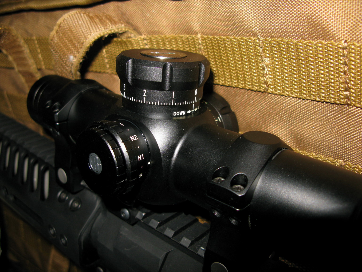

Mechanical Testing and Turret Discussion:
This optic is equipped with 10mils per turn, .1mil per click, non-locking, uncapped turrets that are quite low profile compared to most competing designs. The Windage turret is labeled up to 5L and 5R from 0 and features no stop. The elevation turret features a unique zero stop that is engaged by turning a coin in the slot in the middle of the turret until it stops. Therefore, you can run the turret in either zero stop or no zero stop mode. It is a very easy feature to set or engage, easier than setting the zero itself. This involves three tiny set screws and is performed the same way on the windage and elevation turret. This is a common method, though I don't expect I will ever find it elegant. The feel of both turrets is excellent, both in regards to force required to turn and the feel of the clicks. I will also mention here that the March-F 1-8x24mm has a side-mounted parallax adjustment integrated with the illumination. It focuses from 10meters out and March is the only scope tested to have this feature that is nearly ubiquitous in long range optics and virtually unheard of in close quarters optics.

Leupold Mark 6 1-6x20mm with CMR-W 5.56 reticle at 6x focused on a tree line at 100 yards
Just as with the CQBSS, the Mark 6 is offered with a few different reticle choices and these choices are meaningful. The choices are the TMR-D and the CMR-W 5.56 or 7.62. The TMR-D is probably about what you expect it to be. It is a classic mil-hash reticle with .5 mil ticks and labels every 5 mils. It also has an illuminated circle broken into four quadrants in the center.
The CMR-W offerings are a bit more complicated. You probably guessed that the 5.56 and 7.62 designations refer to 5.56 NATO and 7.62 NATO. The subtensions on these reticles are based on their respective ballistics. The look and function is very close to identical and Leupold actually uses the same stock image, of the 7.62 variant, for both reticles on the website despite the fact that the 7.62 goes out to 1,200 meters whereas the 5.56 only goes to 900. The CMR-W reticles each illuminate only a small central horseshoe.
Each of these CMR-W reticles offers more modes of ranging and drop compensation than the TMR-D. They have a mil scale on the horizontal axis and a small separate vertical mil scale for ranging using mils, but they also feature the chest bracket range finding made popular by Trijicon with its ACOG line of optics. Drop and wind compensation can be made using a caliber specific Christmas tree. The vertical of this tree is denominated in hundreds of meters and the horizontal in 5 mph wind increments. With this combination of mil and caliber specific features as well as a decent set of adjustment knobs, the user is offered a lot of quality choices with regards to determining range and compensating for it. The reticle does not seem overly busy at 1x because, due to the ffp nature of the design and the high power range, they are barely noticeable; leaving only the bright illuminated horseshoe which appears much like a dot. Despite a few tweaks I might make here or there, this is a very functional reticle design with the user given a great deal of choice with regard to method of distance and drop compensation and therefore a great deal of adaptability to the situation.

Going into the optical evaluation, I wasn't really sure what to expect from the Mark 6. It is much lighter than the CQBSS but, given the difference in power range, the price seemed to indicate similar quality glass. That proved to be the case with regard to the excellent resolution, though differences in the color rendition rendered the feel a little different. The CQBSS had a very warm pallet that was significantly skewed to greens and yellows. This was also true of the Mark 6, though to a much lesser degree:  it was closer to neutral color. I'll admit to liking a warm pallet. Bird watchers might consider this a failing on my part, but I don't care. The warm hues make the world seem brighter and more pleasant. That is probably a strange sentiment to express when looking through a combat optic.
For some reason the 1x eyebox of the Mark 6 actually felt a little smaller than the Mark 8. Given the power range difference, this seemed odd. Certainly, the exit pupil numbers do not indicate this, as I measured 1x CQBSS exit pupil at 9.14mm and the Mark 6 at 11.06mm. Impressions can be tricky and I will chalk this one up to unaccountability. In any case, the eyebox was still larger than most and did not present any problem. Its field of view is larger at 1x than its big brother, though I would still qualify this as being in the average range.
Similar to its big brother, the Mark 6 optical design left me with the impression that it was well tested and polished, so to speak:  edge to edge clear with little distortion. Most importantly, at 1x it has a remarkably flat field of view, allowing the user excellent two eyes open operation.
Leupold Mark 6 1-6x20mm with CMR-W 5.56 and comparison optics at maximum magnification focused on test target at 25 yards.

Rather than use one of these existing technologies for the Mark 6 1-6x20mm, Leupold designed a fourth technology. I will call it ‘directed reflected’ because, so far as I can tell, that is how it works. It appears to me that this technology involves directing light forward from the rear of the optic and reflecting it off of the portions of the reticle with reflective dope in the same manner as conventional reflected illumination. The difference is that the reflection is much more intense (easily daytime bright), but that the intensity of the illumination varies greatly depending on how close the user’s eye is to the center of the eyebox. I am not sure exactly how this boost in brightness over conventional reflected illumination has been accomplished. My gut says that perhaps a diode-based laser is used for the illumination source and that this accounts not only for the increased intensity, but also for the sensitive viewing window. That is just a guess though. In any case, the effect is that if the user’s head moves around very much at all, the illumination appears to flicker with your head movement. Users varied in their degree of annoyance with the perceived flicker but all noticed it and found it some degree of undesirable.
The illumination controls on the Mark 6 1-6x20mm are analog knob type. The knob has seven intensity settings with an 'off' setting in between. Settings exist suitable for daytime bright dot style illumination as well as for nighttime use and night vision use. On the Mark 6 1-6x20mm with CMR-W reticle, only the center horseshoe feature is lit. This makes ranging or hold-over in low light a no-go. With the M-TMR the central mil section is illuminated, enhancing long range use in low light. This circular feature only illumination is also the case with the TMR-D reticle variant.
Leupold Mark 6 1-6x20mm with CMR-W 5.56 reticle and comparison optics at 1x and maximum illumination. Target at 25 yards.

Leupold calls the turrets on the Mark 6 1-6x20mm M6C1 'adjustments'. These are locking, 10 mil, single turn, .2 mil per click, zero stop adjustments that are also low profile. Just by my saying those things you can understand that these have a good deal to recommend them. They do a lot of everything in a small package. I will talk about their foibles next as they are not the unmitigated pleasure to use that those on the CQBSS are, but I don't want you to let any of this wipe your mind of the fact that these are very small turrets that do all of those things. That is quite an achievement, though it did not come without some cost to user experience. Just because your iPhone is not as good for watching movies as a big screen does not mean you take the big screen with you every day in case you get bored and want to watch Netflix.
The first compromise I noticed with these turrets is the feel. (Okay, first I noticed they were kind of ugly, but I don't think you can blame that on the small design.) These turrets have a mushy feel to them though they are nevertheless quite stiff and therefore dig in a bit when you turn them. Not surprisingly, this mushy feel is not augmented with audible clicks:  they are tactile only. The stiff feel is probably not the major factor contributing to their digging into you when adjusted. Rather, the little button that unlocks them is probably the bigger factor. This button is only on one side and it is kind of slick, causing everything else you grip with to have to make up the difference. It also can be hard to find with gloves. If you are behind the optic and can't see the button, you just have to try gripping in a few different positions before you get lucky. You probably guessed that with such small adjustments, the zero stop and zero set simultaneously with a hex wrench. This is indeed the case. Other systems for accomplishing these settings invariably take up substantially more room. Lastly, the adjustments are marked both in mils and in BDC specific drops. Only one of these BDC drops is marked as such. The others are just labeled 4, 5, 6, etc. Although on a different line they are easy to confuse with the mils that are also labeled 4, 5, 6, etc., room existed for more markings of the BDC numbers and should have been utilized. All of these caveats aside, the Mark 6 has excellent adjustments because they do all of the things you want them to. The fact that they are uncomfortable is just not a big deal because they are so small and yet so functional.
Close up of the M6C1 adjustments and intricate battery door of the Leupold Mark 6 1-6x20mm
