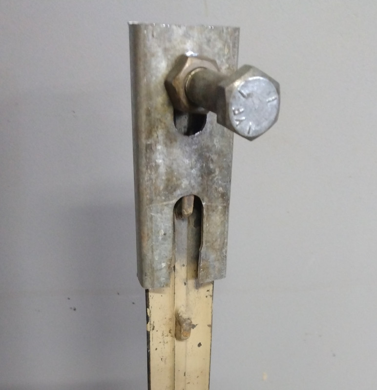

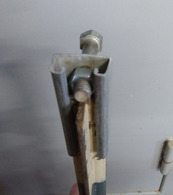

Junk Fu solution:
Shallow uni-strut scraps with the bolts, nuts, washers, spacers, etc of you choice. Strut sections should be 4" or 5" at least or heavier calibers will make them jump off the t-post. Squeeze the strut a little in a vise to bend the center and they will fit over the teeth on the face of the T-post
