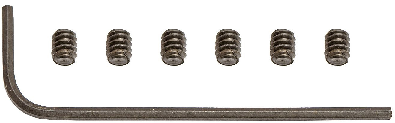

Great idea...but do you know how hard it was to find a 4-40 set screw?  Nobody in 3 towns had them, I tried every hardware and auto parts store including ACE, Home Depot, Lowe's, and NAPA.
I finally found some stainless 4-40 set screws, but I had to buy a pack of 100.
So, since I have extras, if anyone needs some, contact me.  My email is through Yahoo.
Bill.
4-40 set screws are very common I the r/c hobby. Find a good hobby store and I'm sure you'll find them.

I'm lucky enough to live near a Fastenal store. I bought a pack of 100. I now have a kit I'll take with me when I visit buddies and they can do their guns in return for a beer or a meal. I'm sure I'll come out on top!

I've seen this posted before but for those of you with no access to a store that sells 4-40 x 1/8' socket screws, you can buy a kit for under $6 on Amazon.

Have a general question regarding the set screw itself...
  • If using the typical hardened steel set screw, what would be a good dab of grease on the threads to prevent galling or other issues removing the screw down the line?
  • If using a stainless steel set screw, what would be a good grease for the same reason?
I found the hardened type at a R/C hobby shop and have it installed in my rifle at the moment but I was thinking of checking the local Ace hardware or Fastenal for a stainless screw. I bought a tube of anti-sieze, supposedly good for aluminum heads at the local auto parts store, but I noticed it has graphite in it. Seem to recall graphite being on the "do not use this grease if..." list. Think this anti-sieze would be fine considering how little of the grease would actually be used? If I can't find the stainless screw and keep the one that's currently installed, will something like the Mobil 1 grease do the trick?
Thanks in advance...

I have 50 of the stainless 4-40 set screws left over if anyone needs a few, send me an IM and I will send them out
Now please don't ask for all 50 lol, just a few please so I can share with others
They are stainless so use a good grease to prevent galling but I haven't had an issue with them nor do I mind that they are bright steel colored and not black.

I get bored easily. Think I'll do a few. On page 1 the OP states using a ".5mm" allen. The driver is marked ".050" [inches]. I assume it's .050". Is there enough metal and has anyone drill an access port through the end plate so that if you need to remove, etc the takedown pin, there's an easy access or is it (end plate) needed to remain solid because the new threads are too small to guarantee securing the set screw? I'm aware of the cool alternative method of removing the takedown pin. Just wnodering if what I attempted to describe has been done, is it doable or, shut the hell up with your stupid ideas?
Thanks
11/16/2018 10:51:44 PM EDT
Thanks
The correct Allen key for #4 setscrews is indeed 0.050”.
I don’t see a big problem with drilling through the end plate so you can get at the setscrew, but I’ve never run into an issue where that was needed.
Thanks. It was only one of a zillion thoughts that habitually run through my brain. Appreciate it.

I’ve done this on several lowers, and it’s pretty simple, as long as you go slowly.
I don’t swap out receiver extensions on a routine basis, but that detent spring is sometimes a bear to keep straight while you’re installing the end plate.  If I have a helper, that makes the receiver extension installation easier, but the set screw mod definitively manages that issue nicely.

Someone posted about 6 years ago about guesstimating the right amount of spring.  I've just ordered my tap and screws 'cause I had issues with 2 take down pins on 2 lowers, involving the spring pushing too much on the detent and pin.  My solution to that is that I'll be tapping a little deeper, and trimming the spring a little shorter and just increasing pressure by screwing in more....
5/19/2020 6:52:44 PM EDT
I do this on every lower I own/build these days. I also have gone to threaded SS pins for the FA and bolt catch. All little details that make your build stand out. Plus when you really want to tear them down for a dip in the ultrasonic its so much easier.
For this mod in particular though I have found trimming the spring roughly the same length as the set screw works fine for me. Remember when you trim a spring you actually increase its rate. I have thought about taping to hole deeper to allow some room for adjustment but so far haven't found it necessary.
