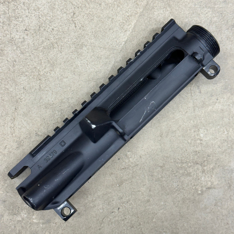

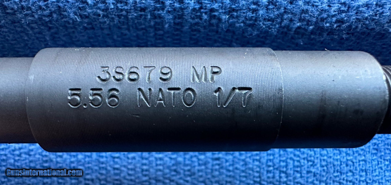

What maker puts serial numbers on receivers and barrels. A guy showed me a rifle with a 5 digit number and the Square forge mark on the upper receiver and the same number on the barrel. I’ve never seen this before. On the barrel it’s right above the 5.56 1:7 marks and has M P next to it.

Colt puts their cage code 13629 on the upper and barrel.
8/31/2026 8:09:15 PM EDT
Most likely what you are referring to OP.
FWIW, all modern .Mil upper receivers and barrels will be CAGE marked with the manufacturer's info.
(A Commercial and Government Entity (CAGE) code marking is a stamped, etched, or printed five-character ID on manufactured parts, equipment, or packaging that identifies the exact business and physical location that made or supplied the item.)

Thanks. Didn’t realize it was a Cage Code. That made search results pop up by the dozen.

FN America example:
ETA: Fixed.

99% it was a cage code as mentioned
1% it was one of those 223 spec Colt made for the European market (6920-EC) those would have a SN on the upper & barrel to comply with recent EU laws

Colt CR6920-EC  guns are marked .223 Remington.
OP's example is 5.56 NATO.
