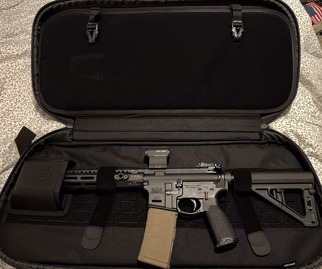

It’s been awhile since we all talked through the barrel choices.
I’m happy to report I went with the Rosco bloodline 10.5”. It’s been reliable through multiple grain weights in 5.56 and .223. Again, thanks for the input from all of you.

https://i.ibb.co/bjc0tqVc/IMG-8618.avif
How do you like that Magpul Brace?

Actually pretty terrible. Not a fan. If my wife wasn’t going to sbr it, I’d get her a sba3 brace. Sorry for the late responses.
It’s not at all comfortable. I chose it based on her wanting the law folder so when folded, it would lay as flat as possible.
