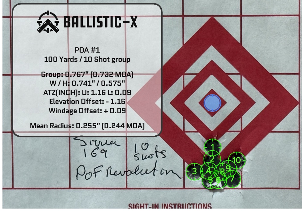

I have a POF Revolution DI that, over the course of two factory barrels, has shot sub-MOA with hand loads.  Bullet weight and powder, as you know, all have an effect.  I've tried more than a dozen projectiles from 150 to 200 grain and have developed either close to or sub MOA accuracy for each.
I've never had great luck with Varget and prefer IMR 4046 and lately, IMR 4895.  With 4046 behind a Sierra 169 SMK in PMC or matched headstamp LC brass, I can consistently get sub-MOA results over 10 shots.  I've never messed with seating depth and I load to just shy of mag length.  I develop on a single stage and load in bulk on a progressive press, a Dillon 750 with a lot of afteramarket bits.
This is a 10-shot group I shot recently, bulk-loaded on the Dillon with the Sierra 169 SMK's in PMC brass with CCI 34 primers.  I can get similar results with their 155 Palma (the original version, not the new with a secant ogive) as well as with a cheap Hornady 150 grain FMJ (actually even smaller groups).  So yeah, you can always improve but again it's a resource thing and what you're trying to do with the rifle.
11/16/2025 2:58:50 PM EDT
10 shot group IMO the way to shake it out properly nice job
