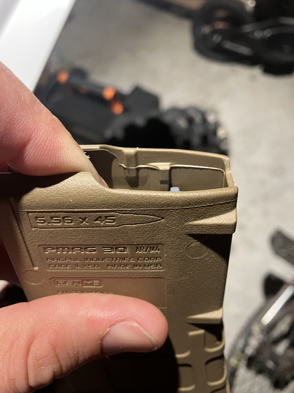

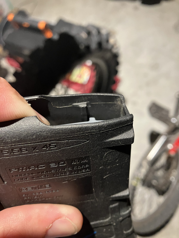

[Last Edit: JBecker_72][Edited] [#5]
Originally Posted By mcantu:
The Gen3s have been out since 2012. I think it's time to upgrade
I have a few early gen 3s that also do it. They added an extra rib toward the top of the feed lips pretty quickly.
Early gen 3 (11/2012 date):
Current gen 3:
