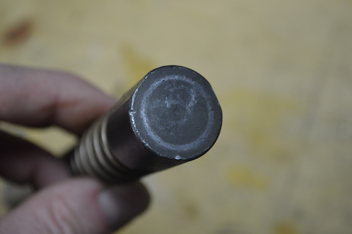

I have 200 rounds through it and noticed the front of the buffer is getting ding marks and indents all around the outter edge from the buffer detent. the detent is bent forward toward the BCG.

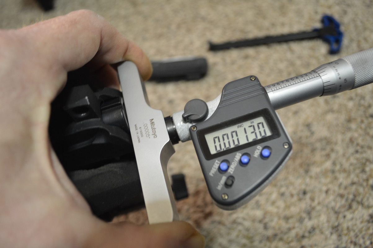

If you have a large enough micrometer, the carrier should be
6.672 ± 0.005 inches. Make sure that yours isn't too short.
4/9/2025 1:29:55 AM EDT
cool thanks, i'll measure that tommorrow.
i requested measurements from pro2a and they will won't provide them to me.
they said, "bring your weapon into our store, we'll measure it".  yea, i live like 2000 miles away....
Only works, when the back of the barrel extension protrudes in the upper receiver cavity the correct distance, so back of carrier (single piece bolt in this case) is correct distance to rear of upper receiver back end to push the buffer off the buffer retaining pin, when the upper locked home on the lower receiver.
So again, need photo of upper receiver with bolt removed, from both the ejection port window, and from bottom of lower receiver, to get an idea of the barrel extension protrusion into the upper, then photo of single piece bolt in upper,and it back end to back of upper receiver.
Granted that still want to check to make sure that one piece bolt is correct length, but want to make sure that barrel nut  is not loose/not allowing barrel extension  mating surface to gap to front of upper receiver barrel socket front lip, which could be causing the problem instead.

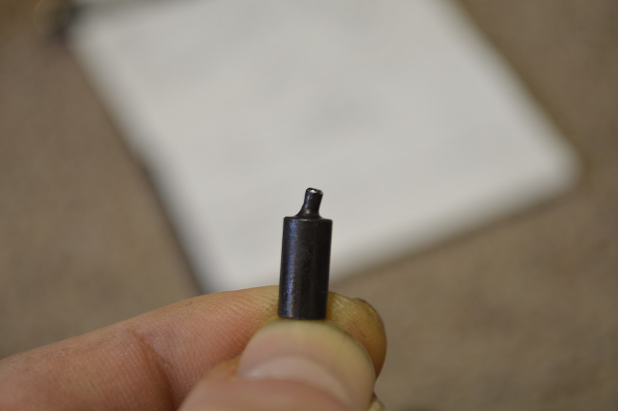

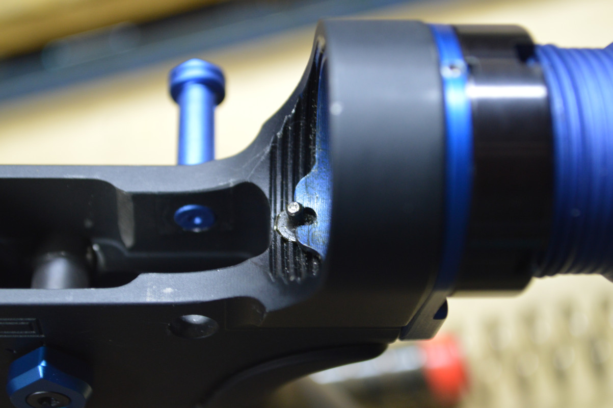

i stipped this little guy today, detent is bent, no other damages found there.
i removed the handguard and checked the barrel nut = tight / no issues found there.

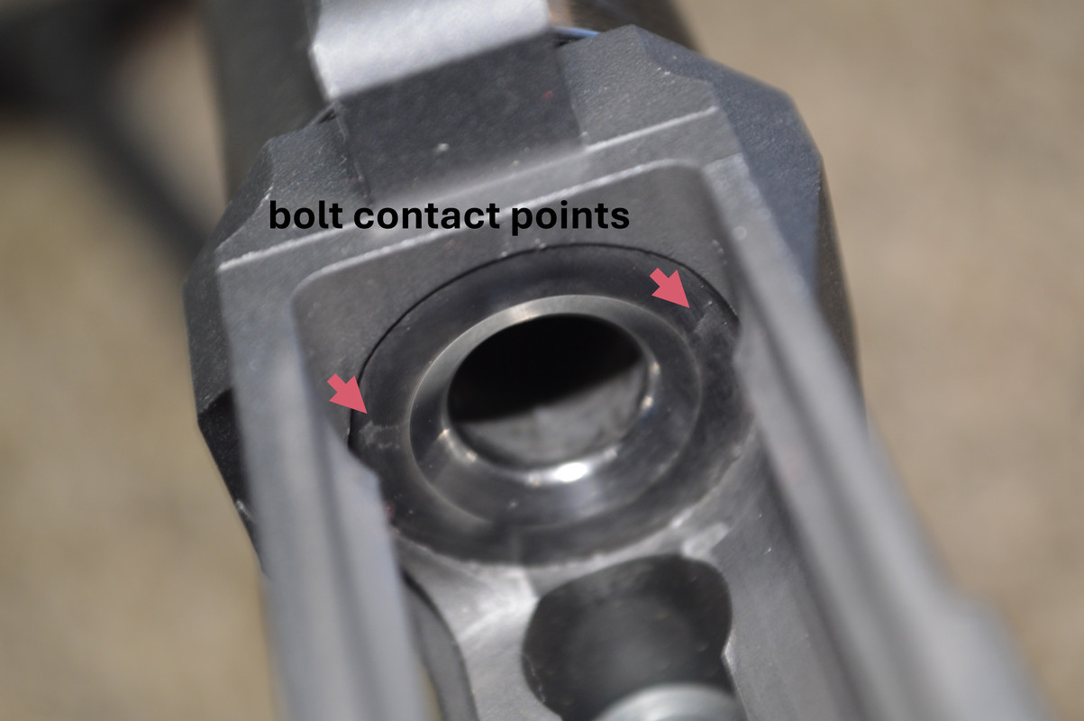

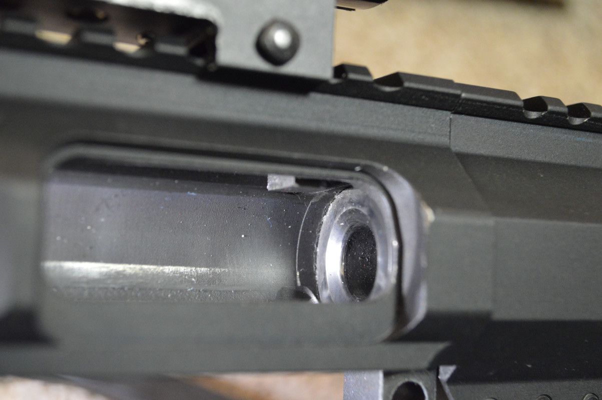

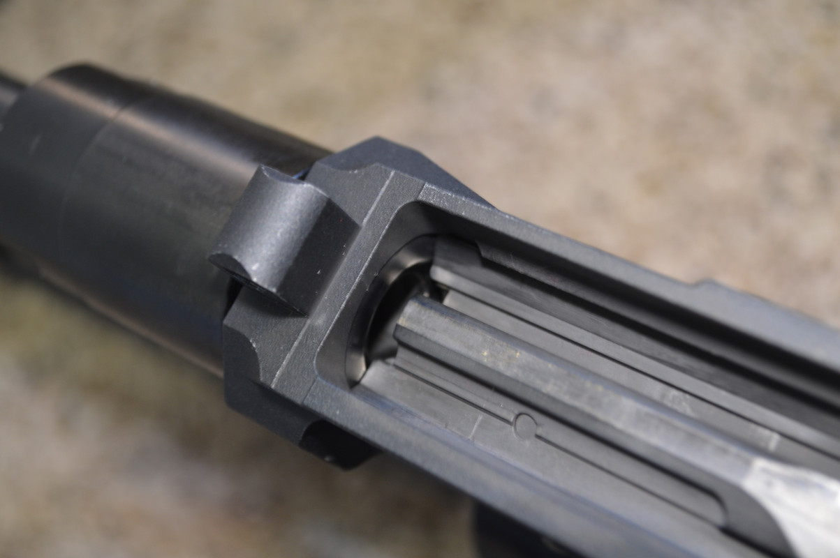

photo's of inside receiver front from below.
with bolt istalled
from ejection port.
with the bolt installed, the bolt just barely extends out the rear, past the receiver. seems to be pretty good?
is there a measurement for the buffer detent hole? like center of hole to some other point i can measure to?
p.s. are my photo's loading on site for you? or do you need to click on to see? i'm useing a new host.

Might be max distance something like 6.940" center of retainer hole at top to the center of front pivot pin hole "vertical center line up from pivot hole to same height as top of the retainer hole to get a straight horizontal line measurement ".

Problem is right here, with not enough of barrel extension protrusion back into the upper receiver void.
If could be that the barrel extension from   seating lip on it  stop collar for upper receiver barrel socket, to back  face of chamber section is too short.
Or it could be that upper receiver barrel extension socket  front lip is too long off inside back wall of upper receiver is too long , and barrel socket front surfaces needs to be squared and set back  instead.
Or as stated, could be barrel nut is coming lose,and this is allowing the barrel extension seating lip surface to gap to front of barrel extension face instead.
Simply, when looking in from the side of the ejection port, the back of receiver extension face should be very close to the front of the ejection port window edge, which is not in this case in the above photo.
As for lower receiver, below is a link to download drawings, to see if buffer retaining pin is drilled in the correct location on the lower receiver.
https://cdn.shopify.com/s/files/1/1067/2310/files/AR15_Lower_receiver_blueprint.pdf?3587052860788957110
Simply, time for the upper to be broken down to check/remove barrel nut, make sure there is no derbies/barrel extension seated all the tight against the front of the upper receiver barrel socket, and it is, then front of  upper receiver barrel socket needs to be lathe faced back to get correct protrusion of back face of chamber of barrel, to the it correct position in the upper receiver to semi bring the built upper back into spec.
Note, if the idea is to play dress up on the upper with different barrels over time, then maybe better to face the barrel extension seating surface towards muzzle, to semi bring the upper into spec/ the protrusion of the barrel extension chamber face inside the upper receiver void to to correct dimension of the needed slight protrude.
Hence the single piece bolt striking the back of barrel face is normal (steel against steel), but if the protrusion of the face of barrel is not back enough off the front inside wall of the upper receiver, then bolt can start to peen the aluminum wall of the upper, to cause all kinds of problems.
So in the above photo, notice how the back face of barrel extension is recessed in from inside surface of upper receiver back wall, and it should be the other way, with face of barrel  every so sightly proud past that wall instead.
As for buffer, and maybe even back of single piece bolt, not seeing any burs on the back of the bolt that is causing any problems to the buffer face, so buffer just needs to be checked up lathe to clean up the peen marks, and do a slightly edge chamfer of it in the end.
Then at that point, it back to checking the actual stroke of the rig, but doing a full charging handle pull, and make sure that the face of the bolt only retracts past the bolt catch by 1/8~1/4", and that the last of charging  handle pull the same in tension from middle of pull, to last of pull.   If the bolt is allowed to come back past the bolt catch more then this, then will just be a matter of time before the bolt catch is broken.  If bolt comes back past catch slightly more then this the above, then you can pull the buffer and spring, drop a quarter or two down the buffer tube as end of stroke spacers, to limit how far the buffer/bolt can retract in the tube.  If way more than this, and the bolt is retracting back past the back of ejection port window, then time to get a buffer spacer the needed thickness, to use in the end of the buffer tube instead.

thanks alot. i  appreciate all the insite given. and j3_ thank you for sharing. this has given me way more to go off than Pro2A has done.
with the lower blue print measurements i found the detent hole is located .019" rearward.
maybe with the combination of the upper's barrel extension and the detent location, these may be my issue.
my offset detent should be here anyday, and off for another range test.

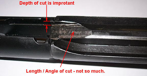

And to point out, since most of the blow back bolts now have ramped bolts, the hammer down against the back of the bolt, offers a lot less help of holding the bolt forward via the hammer on the back of the bolt during ignition, then the old Colt type flat back none ramped bolts isntead.
None ramped bolt,
Ramped bolt,

i received my offset pin, wasn't happy with it. it seemed the offset pin was too thick to fit in the buffer tube slot properly, when i left it stick out of the slot it had enough room to rotate and possibly make contact with the bolt when cycling.
so i took the original retainer pin "the bent one" cut it off flush, drilled a offset hole and installed a harden roll pin.
https://i.postimg.cc/3RkjXdJj/DSC-0134.jpg
i smoothed up the buffer edges, colored it with a black sharpy marker and fired off approx. 75 rounds = no issues / no more contact.

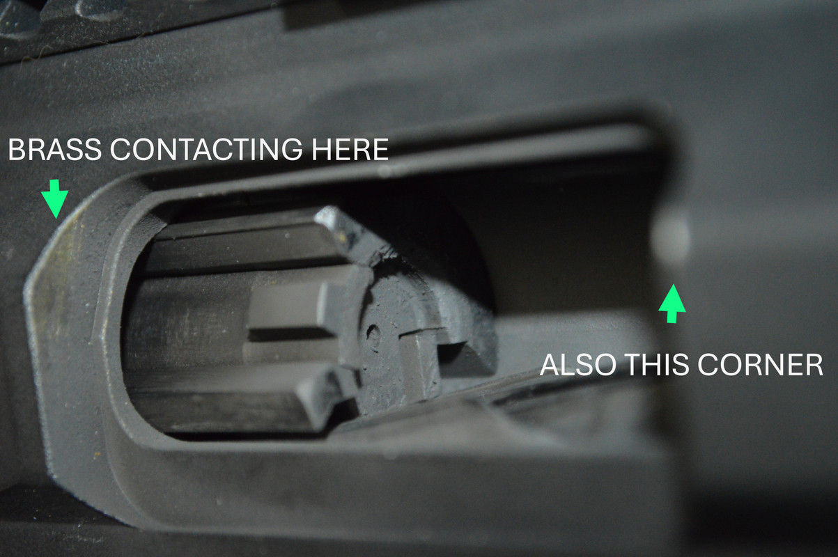

5/2/2025 3:25:40 PM EDT
[Last Edit: Dano523][Edited] [#24]
Yes, no, maybe on the spent cases.
What you have, is as the bolt is coming back, the ejector is going to tag the rim of the case to defect it off the bolt face, and so it all comes down to the ejector  face really in the first place, that is knocking the spent case off the bolt face.
So from the start, you want the ejector to be riding as close to the bolt face in the channel of the bolt, but not binding on that channel side face.  The ejector is hardened, so it if need to be tweaked, then heat will need to be evolved with it out of the lower receiver.
Once that is correct, then we get into of the voodoo of 1911 ejector face beveling, so instead the the face of ejector being squared, its edge beveled to final roll the case off the bolt face (not just hard slap it off without control),  with angle direction of entire face also tweaked so spent case is out center of ejection port as well.
As for the case mouths being slightly dented now, not the end of the world, since sizer will correct that when cases are being reloaded.
So on that note, need photo of where cases are tagging upper now, as well as a photo of bolt pulled back via charging handle until ejector is flush with bolt face, to see what kind of gap to inner side wall of bolt the ejector has now, and the angle of the ejector face to tram line of bolt face as well.
Granted 9mm with hook ejector, but gives you the idea of what I want to see between ejector and bolt face on your rig.

heres a pic, the ejector is square cut / no beveling or angles. appears to fit up pretty nice - no big gaps like your sample picture?
the ejection pattern is all over the place, between 2 through 5 o'clock, it spits brass every where.
https://i.postimg.cc/Rh9rdmBg/EJECTION-PORT.jpg
5/3/2025 9:17:45 PM EDT
Ejection path out of the ejection port a touch high, but live-able.  I say live-able, since if you lower the ejection path out, more of the thicker side wall protrusion of the upper receiver that the cases will needed to over comes instead.
See inner ejector inner edge where finish as been worn off ejector, that edges needs to slightly chambered with diamond file to start with, and maybe even  upper face of ejector on high side slightly cant angled as well, so spent case is more rolled off bolt face via extractor and ejection, verse the hard single point that the  ejector edge is doing to just hard single point slap the spent case off the bolt face.
As for how thick that the ejector port  outer protrusion at back of window protrusion, not sure your every going to get the spent cases to clear that with the best of ejector tuning, even with longer ejector, and may just have to resort to sticky back Velcro strip on that edge, to soften the blow of cases as they tag that edge out.
Hence way upper with wider ejection exterior surface is set up, since its designed to be a  gas deflector to start with, and going to be very hard to tune the upper for brass not to tag it as well on the way out.
