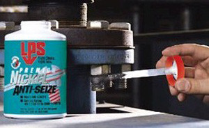

Get some LPS nickel anti-seize.  I use it on breech-plugs for my Savage ML-II muzzleloader and also put a little bit on upper threads and barrel extensions.  It cleans up easy as well.

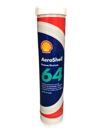

This is the only thing you should be using...
FYI, for those who don't know 64 is the new name for 33MS.

https://images-na.ssl-images-amazon.com/images/I/516YiYlwQkL._SX466_.jpg
You do realize, that just happen to be the cheapest bid when the DOD requested bids right?
There are a lot of quality grease that fits the bill, hell we didn't even use it in the armory when I was in the service.
Actually, AeroShell 64 (or 33MS) is just one of a large number of greases that meet the requirements of MIL-G 21164.
DoD buys in large enough bulk that it really doesn’t matter who made X as long as it conforms to specs.  But major aircraft manufacturers and commercial maintainers also buy in quantity, so AeroShell sells well everywhere.
There are a number of producers of MIL-G 2164 greases that most people have never heard of before, like Royco and Nyco.

Yup, there sure are...

Sure.
And 64 is $20 for a tube that will last you for a lifetime.
It doesn't make the slightest damn bit of difference what grease you use, as long as it doesn't contain graphite.
