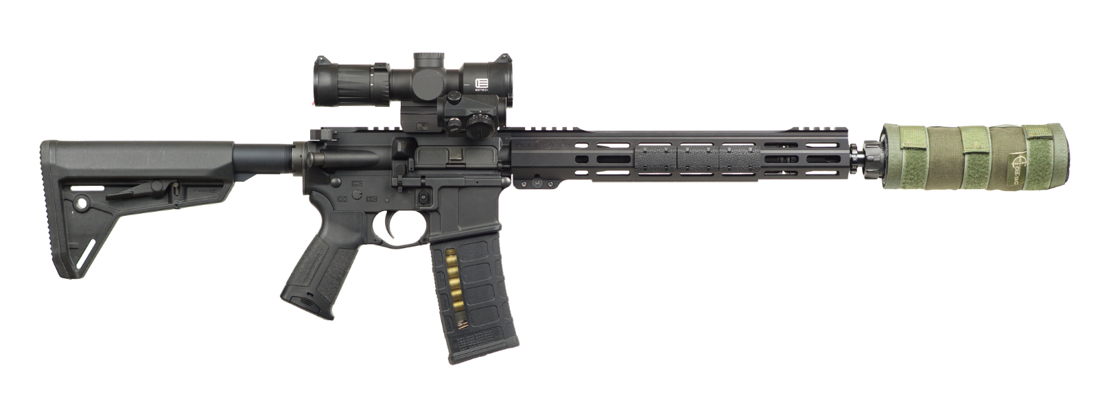

I built this 6.5 Grendel 16" carbine as a general purpose AR using a LWRCI Six8 receiver set. The ICAR mags feed like butter and my Barnes 120gr Match Burner OTMs leave the barrel at 2575fps.
