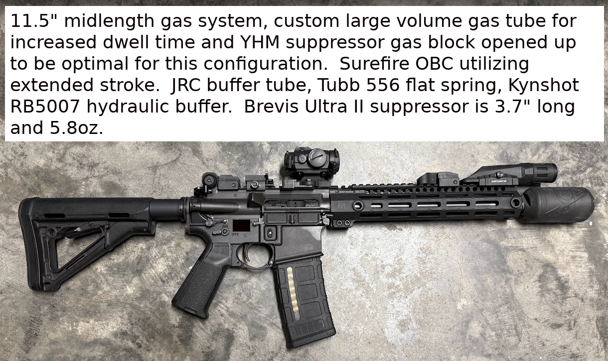

I use a turbo k on an 11.5" midlength and like it really well. Forget the barrel brand but it wasn't a fancy one. Think it was a faxon I picked up cheap at one of the AIM surplus festivities they throw a couple times a year. But it shoots well enough and is handy. It's my go-to to take with me when I travel on long road trips.

I have a 11.5” Sionics suppressor dedicated upper that I run with a YHM fat cat.  It’s a well built upper and gassed nicely for a higher back pressure can, like the YHM turbo you intend to use.  Purchase their complete upper and you get quite the factory package that will work well.  Otherwise consider their suppressor dedicated barrels if you prefer to build to your own specs.
While I can’t comment on the carbine vs mid length gas due to lack of experience, I will say a properly gassed system has more of an impact.
With an Armaspec SRS H weight buffer, it’s the softest shooting of my AR’s.

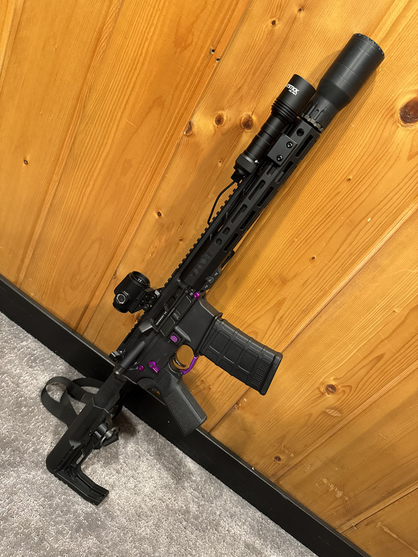

my 11.5 Mid....dedicated suppressed.

8/8/2026 8:43:01 PM EDT
Update in OP
Isaiah 1:18 - "Come now, let us reason together," says the LORD: "though your sins are like scarlet, they shall be as white as snow"
8/9/2026 12:08:26 AM EDT
Originally Posted By Fooboy:
Update in OP
Not to shabby. Looks good.
Do Good
Be Dangerous
Live Free
8/9/2026 10:51:11 AM EDT
Clean chop. Nice work.
