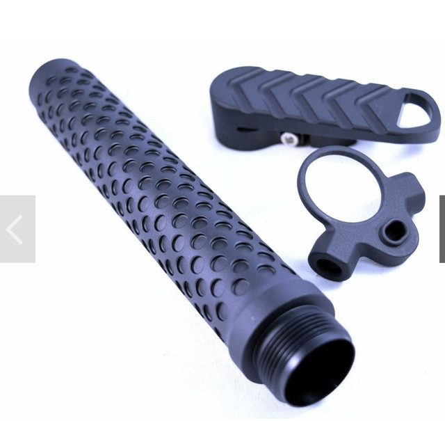

So, back in the long-ago times, I bought the original SB15 brace kit, complete with a buffer tube.  Has anybody build one of these?  The pictures seem to indicate that it just used an endplate and not a castle nut, but can anyone confirm?  I never used the tube that came with it, I got a KAK tube, but now I'm doing some "spare parts" builds and I think I want to use this tube, but I don't know how...  Thanks in advance to anyone who can help...

No, I bought some kind of a kit back in the day that came with its own buffer tube.  You can kind of see it in this pic (best I could find):
All the pictures I've ever seen of this tube don't seem to use a castle nut.  I did a little Googling of pistol tubes today, and apparently that was a thing.  Seems like RRA and PSA, at least, may also have made that type of pistol tube back in the day.  Not sure anybody still does, and I'm guessing there's a reason.  Guess I'll give it a try, what could go wrong?

I used this tube on a pistol build, no castle nut required.  There is no need for any indexing, just make up the tube against the end plate.

I guess what I meant was that brace fits a round pistol tube.  Some use a castle nut and some don't.  There is no reason to index a round tube so the end plate can be superfluous.
My CQB brace has a tube similar to that, but shorter.

The tube that came with my SB15 used a standard end plate and castle nut

The end plate is still required to trap the rear pin takedown spring, if the pistol is so equiped.

Some have a setscrew that retains the spring and detent.  As I said "can be" superfluous
