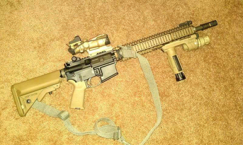

Thanks for the new thread doc. I enjoy building clone guns and saw the MARSOC M4 in the MK18 thread a while back. I like it right away and went about building one. Mine is a real franken gun:
BCM lower that was IonBonded in brown
DD 14.5" mid length Govt profile barrel
DD RIS II M4A1 rail
BCM BCG
GunFighter Mod 4
Spikes stripped upper
PRI rear sight in brown
KAC front sight in brown
SF Flash hider
Magpul CTR
Magpul RSA
Magpul ASAP
Magpul MIAD
Aimpoint M4s w/ Aimpoint cantilever throwlever mount
I know the ACOG is the appropriate optic, but I shoot my guns with Aimpoints much more often and I had an extra M4s on a gun thats just been sitting in the safe. It was a real pain to find an upper in roughly the same color as the lower and rail. Lower and rail match pretty well, the upper has more of a green hue. Just as I was about to get a black upper to finish the gun, I came accross a guy who had a full Spikes gun in this color, but was selling the upper seperate. I asked if he minded if I bought the upper alone and replaced his with a black one. He didn't and that's how I wond up with this.

I actually have only seen one picture of an ACOG on a Block II M4 - the rest have had Elcan SU-230s or EOTech SU-231s.

7/8/2011 12:30:51 AM EDT
Carpet pic
There is way too much speculation going on lately. Shoot your rifle first. THEN, if there are problems call the manufacturer.

Originally Posted By azoutdoorsman:
Carpet pic
http://i53.photobucket.com/albums/g60/azoutdoorsman/IMAG0560.jpg
If you took off the MOE parts this would be exact , and sexy
7/8/2011 4:35:38 PM EDT
Originally Posted By Mattyvac:
Wrong rail color, Wrong stock, wrong grip, wrong fh, wrong buis, wrong trigger guard
Dare to be different!
7/8/2011 4:38:08 PM EDT
Nothin wrong with that, but we are discussing clones. That's simply an M4

7/8/2011 5:12:08 PM EDT
All in good spirit, but most of what is discussed here would be M4's and not the clones you speak of!
Carpet pic
Came with the LPK. However, I do have another lower with a black gen 1 SOPMOD and an A2 grip that I could swap out for this thread. If I get some time I'll take some more pics.
