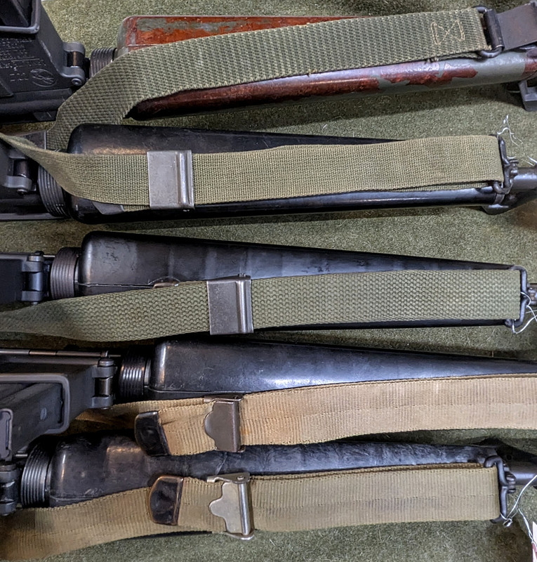

Here's a pic of the different slings, top is 601, with the different weave, next is a finer weave Garand type sling, I have a couple of these dated early 60s MRT, next is the normal cotton Garand type (there were a few different types of those since they were in production since the 40s), and   then a couple types of the nylon "seatbelt" slings, some were more brown, some were green.
 Black cotton Garand type slings found their way onto SP1s in the late 60s, ( earlier SP1s from 64-67 had what look like black 601 slings), the Black cotton D tip slings, then the black nylon silent slings for all in the early 70s.
   The Marines used Black nylon Garand type slings in the 70s and 80s, then went to the silent sling.  The Coast Guard used green nylon and cotton slings into the 2000s on their M16A1s (they were still in the stock system).

Great reference photos!
I found my first brownish seatbelt sling for $15.00 yesterday.
I put it on my M14 copy.
Now I'm looking for a US General purpose sling without the hardware.

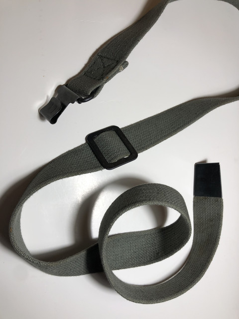

I found a few of these green slings in a box of gun parts from around 40 years ago:
Light green color (looks darker in photo) and I put one on my 601 - looks nice. I don't remember what these slings are for.

That’s a Yugo AK sling

Thanks! I sold those in my shop in the late 1980s and imported some post sample M70s around 22 years ago.
