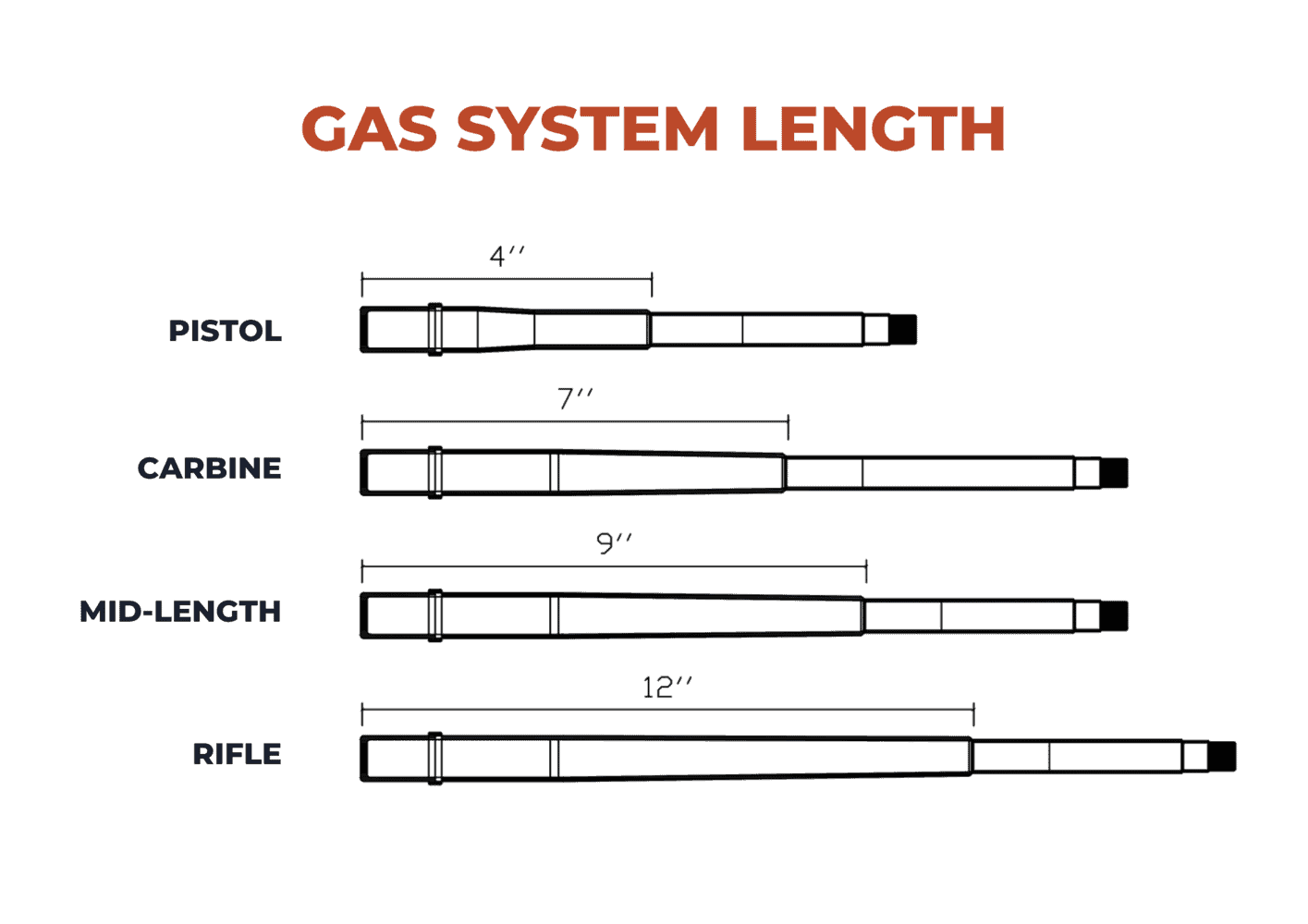

What length gas tube?   I've mostly seen pistol length on blackout guns.

Pistol length gas.   It's all BCM does on 300BLK.

3. for more subsonic rigs in 300blk, and since they are using very fast powder which pushed the peak burn dwell way towards the chamber, you want the gas port to be as close to the chamber as possible.   The barrel can be as long as you want it, but again, want the gas port/end of gas tube to be as close to the barrel instead.
So think this with where the gas port would be on a pistol barrel and where the fast burn power used for 300blk will have it max peak point.
