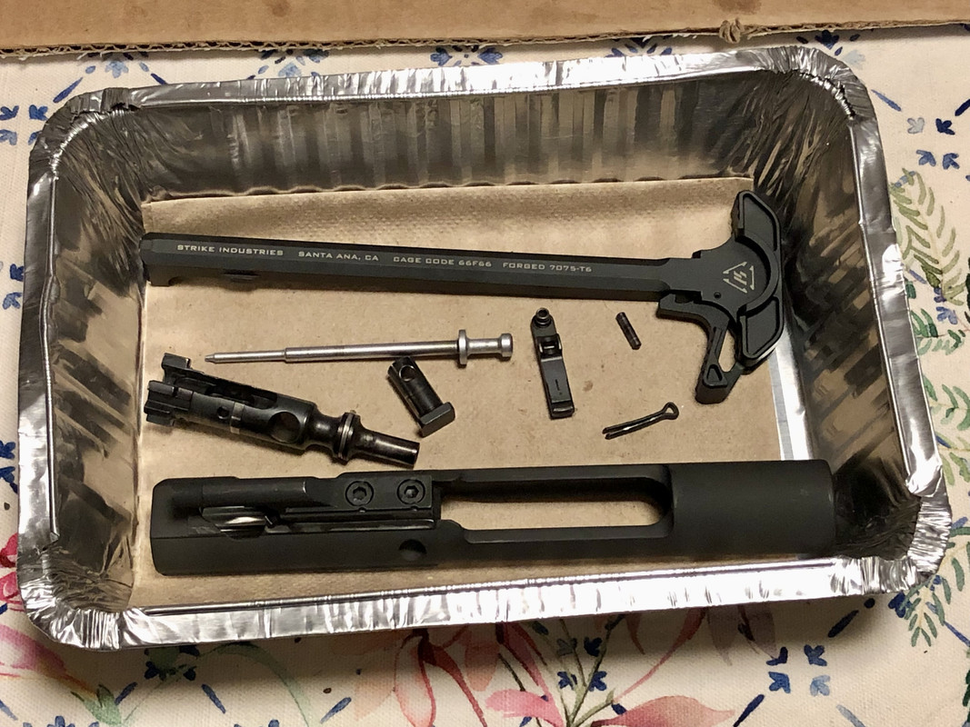

Parts washer from Harbor Freight. Spend a hundred bucks (probably more) on fuel filter assembly, upgraded solvent pump, seals, fittings, etc. Spend a few weekends working on it while the wife asks “when is this project going to be done”?
I use the Tractor Supply parts washer solvent. After a weekend carbine course I’ll take the accessories off the upper and throw the whole URG in and scrub it. Makes cleaning the BCG an absolute breeze too.

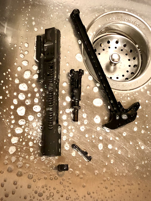

If you use water, best practice is to use VERY hot water so that it flash dries.  The issue is that you can end up with water trapped in places like the ejector spring, where it rusts.
Water isn't bad...but you have to get it all out.  Hair drier...hot...evaporation.  Following that, its optimal to spray it down liberally with a moisture displacing lubricant like PB blaster or similar...maybe even WD 40.  Then, wipe as much off and out as you can.

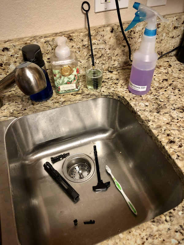

Yes the normal simple green is bad for aluminum but the purple HD simple green is safe. Just read the label on it as it’ll say safe for all metal.
Washing a gun is like washing any other kind of metal. I think something easy to disassemble fully is important like an ar15 or glock for example are very easy to completely take apart and wash and clean.
I used in the past a can of compressed air and simple green in a bathtub. It works pretty well if you let it soak for hours.

I’ve been using Simple Green HD for some time, followed with compressed air. Comes out squeaky clean with minimal mess.
