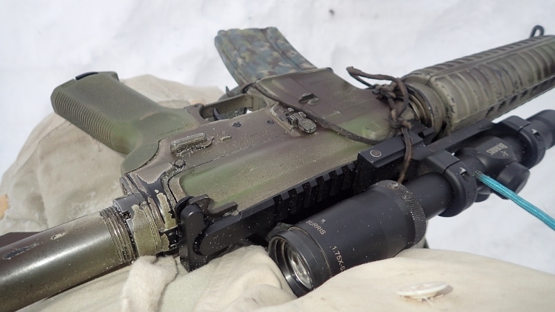

@JLS81  RC on the backup gun but the AR10 is covered in my old standby;  EVRlasting Home-brew top-coat.
It's a secret blend of mysterious chemicals all no-doubt falling under the stinkeye of the Secretary for Environmental Protection/California Environmental Protection Agency. In a decade its use will probably warrant a 5 year stint in a Cali Environmental Re-Education Facility. Which is why I don't live in California.
Actually, it's just high-gloss, hardware-store, oil-based tractor paint mixed with talcum baby powder to dull it and then blended for colors.  Best home-brew top-coat I've ever found for stuff like hard-use guns, shovels, Pulaskis and the like. Stuff dries TOUGH and withstands more chemical abuse than RC.  Used it for years on guns, shovels, picks, sledge hammers and such.  It's a fantastic surface coat on parkerizing and dull anodizing and if it does wear it can be of course retouched where needed.  In practice those coated with EVRlasting Home-brew don't much need to tho I have several RC'd AR's I really need to strip with acetone and re-coat with the better stuff as it is just a better paint. I don't even try to keep up with the wear on my RC's guns.  That stuff really is almost a temporary cover.
EVRlasting Homebrew must be kept out of actions and off bearing parts as it is thick and will cause binding and would no doubt chip off and muck things up inside the gun action, but then the same applies with RC.
Here's a typical comparison of guns coated with RC and my stuff.  Both have been used under pretty rigorous conditions.
Typical RC wear which occurs quite quickly if the gun is used at all and bubs on body, rucksack, etc.  As you can see basically all the high spots get wiped clear of the topcoat:
EVRlasting Home-Brew:
https://i.postimg.cc/1zr5Q3c2/Range-Day12172016320and-PSA-084-800x450.jpg

I've used a variety.  Rustoleum oil-based and other store brands seem to work well. has to be oil base and it goes by a number of names, but "tractor paints" seems to be common.  use yellow and just a spot of black in it to make olive drab.  use talcum baby powder and i can't give you the exact recipe but you use way more than you might think in order to really dull it.  we have a low humidity here so it dried fast, but in really wet areas it might take a long time.  i remember in jersey it seemed like it took weeks for a oilbased brushon paint to really harden.
to make the camo mottled effect I wad up tufts of paper towel and daub over the base layer.

You are welcome.
Some time take a look at pix from the 1st Gulf War.  I remember watching that stuff on the news and noticing how personnel in desert camo were invisible at range but it was easy to pick out that "black stick" they were carrying, sometimes at very far distances in the desert.
It seems to me to be supreme military stupidity not to have spec's a basic flat weapon color other than black long ago.  Even a simple olive drab would suffice for numerous environments.
Seems like I remember something along these lines being ordered for new made weapons or intended to be?  Anybody have info here?
PS:  With the paint, my recommendation is that if you do this in the summer, not to immediately expose the thing to the bright hot sun as bubbles may rise up.  I let it sit for a day or so then lean it against the shop wall where the temps here will reach 125 or more.  Bakes on real well.
And.......make sure you degrease everything touched by the paint with acetone.  Absolutely no oil underneath the topcoat.
Finally, it's paint, so it can/will wear.  But it is a good strong protective layer if applied correctly. If a guy wants to be able to swap colors, RC is better as it is easier to remove.
And regarding that, I've read that ZIP-Strip will remove or damage anodizing, so if something needs to be stripped from the receiver, I don't think it is safe to use the regular paint strippers.
