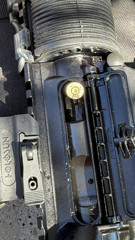

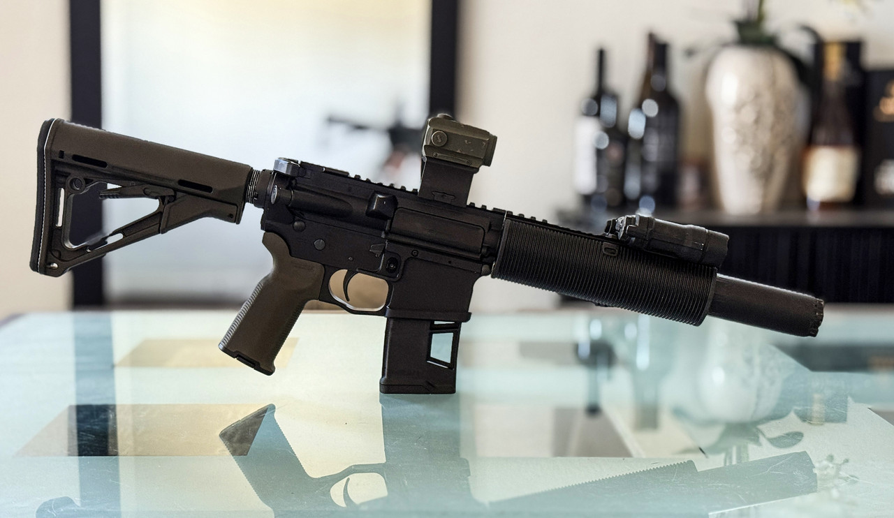

FINALLY received my Atrius as well as my Broad River Tactical SD upper.  The Atrius passes the function test and I finally had a chance to take it to the range.  Unfortunately I started getting failure to feeds almost right off the bat.  With the bolt dropped back, I insert the mag, drop bolt, pull the trigger and first round fires off, second round feeds and fires off and the third is a failure to feed.  I tried four magazines (MEAN) with the same results.
Now initially I tried the Mean Arms 20 round mag and it worked on semi-auto as well as in forced reset for the first mag and locked back on empty.  I then switched to a fully-loaded 30 round mag and that's when the FTF's began to happen.  It would also happen in semi-auto.  Drop the bolt on the first one, pull the trigger and it goes bang.  The second round feeds and fires.   Third round, failure to feed, bolt on top of the cartridge from what I could see at a dark indoor range.
I switch back to the 20 round mag and it starts doing the same thing.
The outliers in my setup are:
-Huxwrx Flow 9Ti suppressor
-JP SCS buffer system, one tungsten, two stainless weights, with a total weight in the 6.4oz range off the top of my head
-Atrius super safety with a Delton mil-spec trigger
-Mean Arms Exo Mags (not the conversion kits for 5.56 mags)
The rest of the setup:
-Broad River complete upper with their SD system
-ADM lower
-Radial-delayed BCG (CMMG) that comes with the BR upper
I also brought along two Unrivaled dead blow buffers, one being the full weight version for a suppressed piston SBR  and one being the light version that I run with a titanium BCG in another rifle.  Neither one of those changed/improved the function.
Ammo was Winchester white box 124 grain, chrono'd at 1050-1080 with the SD setup.  I think the box says 1150 or thereabouts for muzzle velocity.  I don't think it was the ammo.
Anyone using the JP SCS successfully?  I originally bought the 5.56 SBR version so it's slightly heavier to begin with.  I have a pack of 308 springs which I've not tried yet along with one extra tungsten weight.
I also have a few of the Odin adjustable buffers, both the normal and the heavy version with all the weights I'd ever need.  So I could swap in a heavier buffer and a normal spring if something like the SCS or Unrivaled dead blow just functionally isn't optimal.  Unrivaled is coming out with a heavy version of their dead blow system soon btw and I figured the dead blow function would work well with this setup.
To start, I'm leaning towards either the buffer system or the magazines.   I've heard the Mean conversion kits tend to be the most reliable but I didn't want to mix up mags and like the fact the Exo's look visibly different.  My other train of thought, right or wrong, is the bolt is outrunning the mag and needs a heavier buffer or higher rate spring.  But the fact it doesn't work in semi-auto is a mystery.
This is my first PCC and I'm looking for input on where to start troubleshooting.  Thanks in advance!

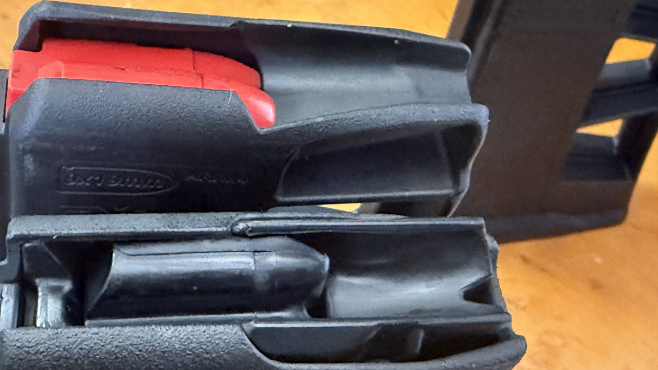

I have the 40 round Exomags and when fully loaded, they swell causing malfunctions.  I've seen people post the same thing about the lower capacity Endomags.  I can't remember if it was the 20 or 30 rounders.
I assume the mag is fully loaded when you have FTF at the 3rd round?  If so, have you tried loading just 5 rounds where I would hope it wouldn't be swelling and see if it happens again?   If not, I would increase the amount of rounds in the mag till it swells.  There is a thread on Reddit where someone is measuring the width of the mag with calipers and you can see how bad it is swelling.
Interesting on the swelling!  I did try reducing the number of rounds in one of  the 30 round mags to see if maybe it was a magazine spring issue or the mags just not "broken in" but had the same results.  I'd load five into the 20 round mag and got the same results, FTF on the third round.
I'll have a chance to mess with it on Saturday again so I'll try just three in the magazine.  Been trying to read as many threads as possible and I'll also check the mag depth and possible swelling issue as it took some effort to get the magazine in and locked in place (30 rounders).  I have a 40 round mag as well but didn't try it as I wanted to make sure the rifle worked with the FRT first.
I may have to try one of Mean's conversion kits just to see if a PMag does it as well.

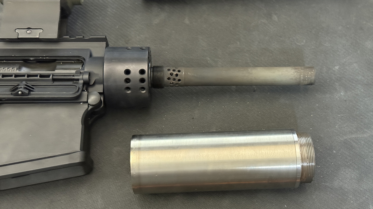

How is it that you're running a regular suppressor with an SD barrel?
ETA: Answered. SD look; not SD.
I have the same upper and it is not a SD barrel but a SD forward hand guard with a shorter barrel so I use the tri lug and it tucks most of my suppressor under the hand guard for the SD look.  If he has a Glock 9mm magazine lower try that or a different lower. Usually when I have issues it is almost always the MEAN or CMMG ends/exomags if he is having semi auto issues. Some lowers like EP9 need a different mag catch from MASON. I know right now he is using a 5.56 lower with conversion mags. He should do what you said and start over....just the upper with a different lower.  I have maybe 9-10 CMMG uppers and 5 CMMG lowers...they all function 100%....it's when I put them on a 5.56 lower with CMMG/MEAN end/exo mags I have feeding issues
It's SD.  The barrel is ported and there's a titanium expansion chamber with a HUB interface on the other end.  Screw on your suppressor of choice and you have an SD system.
If you need a further breakdown, this is a fun little video to watch:
This PCC Has No Business being THIS good - The CAR-15 SD

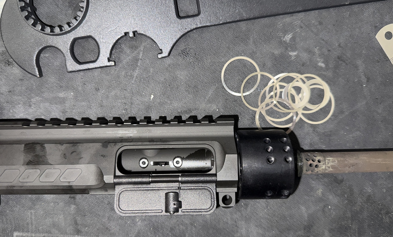

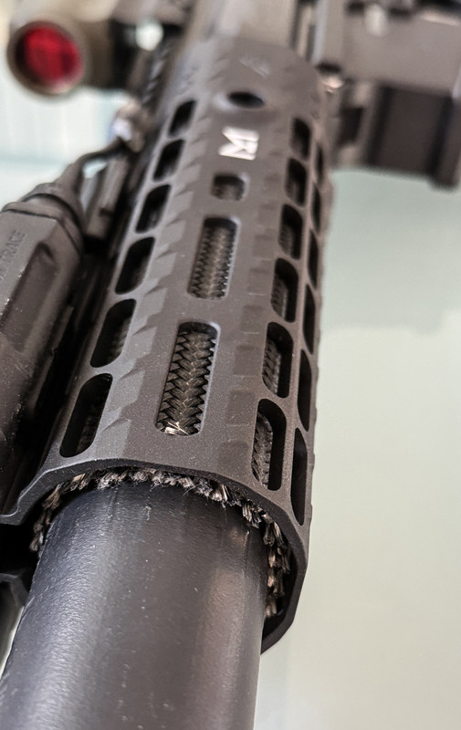

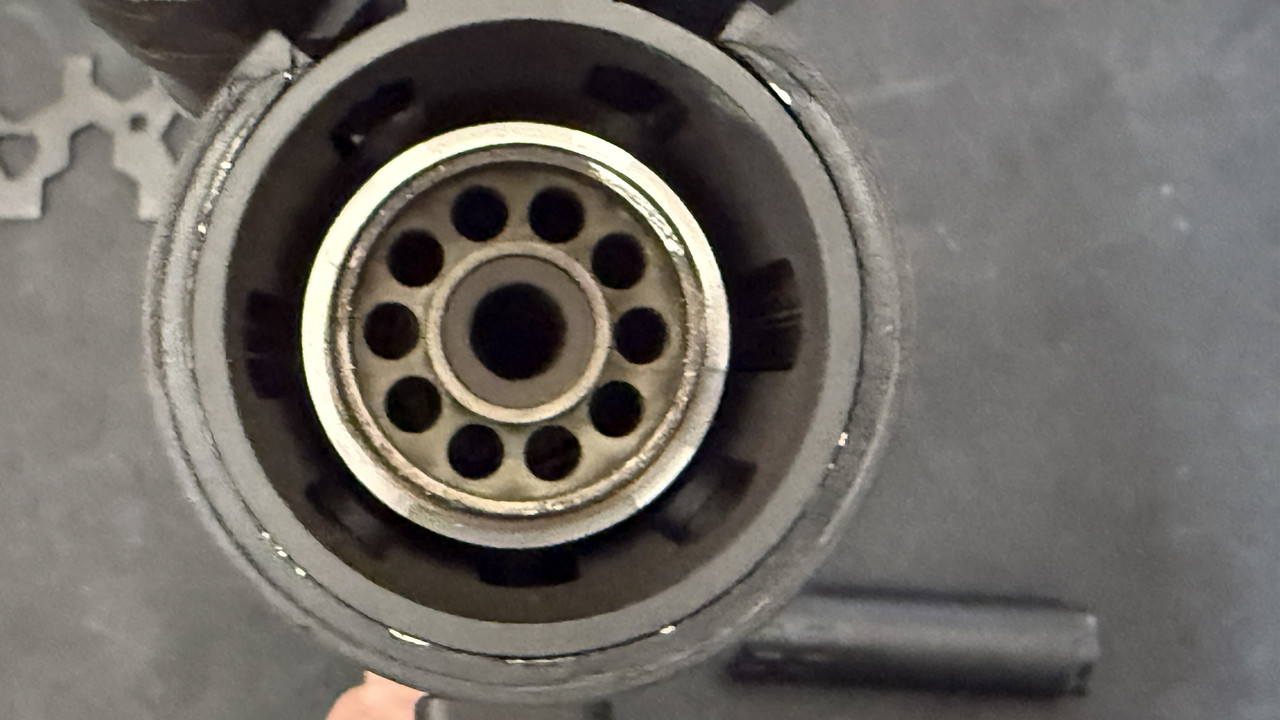

https://i.postimg.cc/vZMWnRg9/IMG-8938.jpg
https://i.postimg.cc/c4fR61H0/IMG-8943.jpg
https://i.postimg.cc/wBwcHWBN/IMG-8931.jpg
https://i.postimg.cc/K8Ntr9BW/IMG-8937.jpg
https://i.postimg.cc/0NkdTg9x/IMG-8932.jpg
If you need a further breakdown, this is a fun little video to watch:   https://www.youtube.com/watch?v=cAG3VaG6N6A

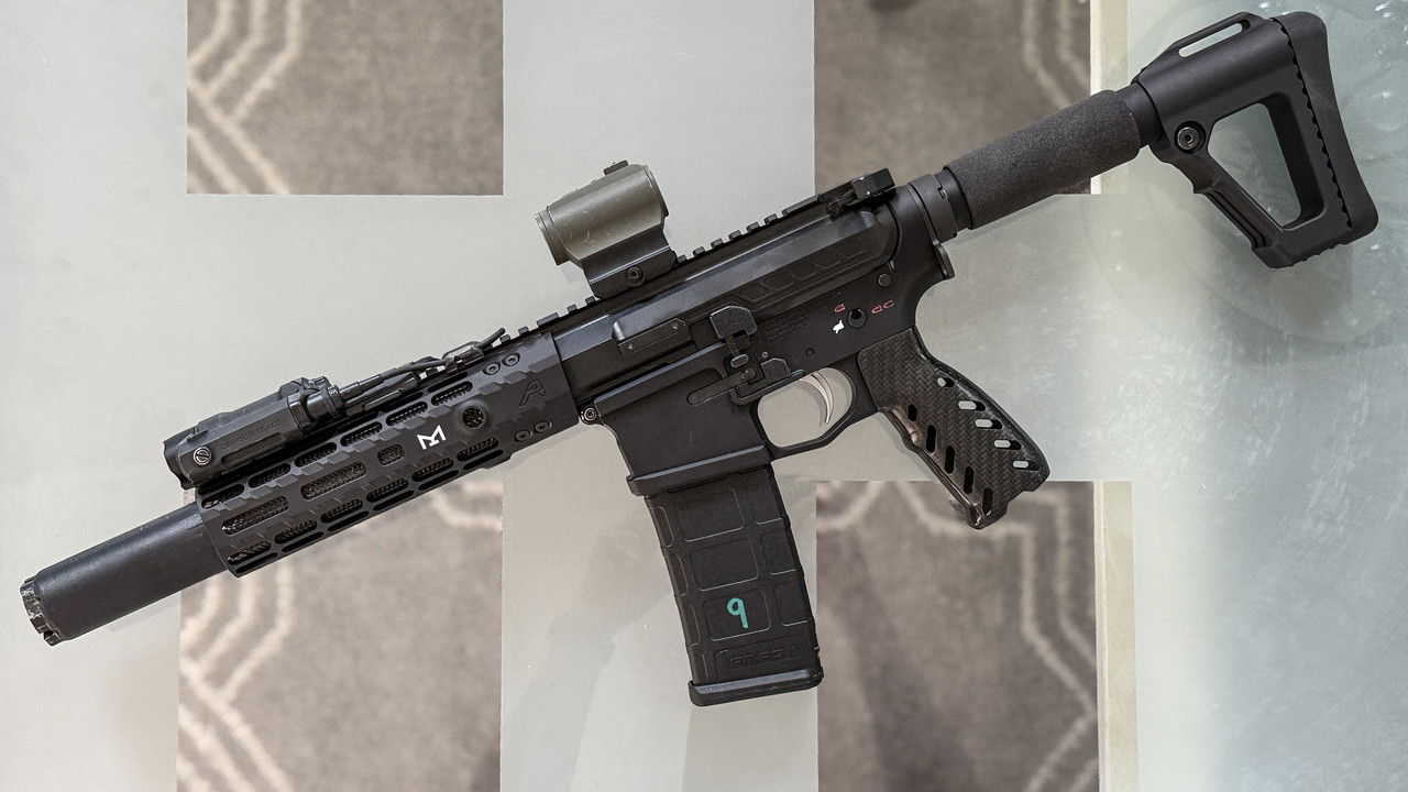

Wow. You really do have a lot going on with this build.
Not sure how anyone's personal experience is going to help with such a unique setup.
ETA: My setup
CMMG Banshee RDB upper w/new FE, BRT SD barrel, B&T SD suppressor
CMMG Mk4 lower w/Geissele SSA-E X trigger (SBR'd); amphibian's A5 buffer setup
MEAN inserts in Magpul TMags
Before I swapped over to the FE style upper, I was having a lot FTEs. At a pretty low round count too. I think I even have a couple of extra spring sets.
ETA2: Keeping an eye on the FRT scene to see which setup I want for this.
Tom Sawyer.

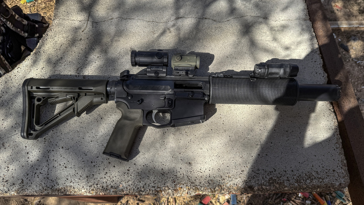

I ordered and received the Sprinco Yellow reduced power spring and I threw in a 3oz. buffer per Chris' recommendation.  I did not change out the trigger but did bring all my tools and an extra Geissele I have lying around.
Bingo.  That worked 100%.  Zero failures of any type in semi or super semi.  Ran like a top.  I really didn't think it cycled too fast but I also didn't do any mag dumps as I was at a range that doesn't allow full auto.  Luckily, the 25 yard line was empty and there's a big wall separating it and the 100 yard line.  I was able to fire off a few five to 10 round bursts without drawing any attention.  It helps that it's so damn quiet.  Recoil is extremely light although the recoil impulse is rather strange to what I'm used to.  Feels like three small pulses upon firing and two on the return.  All the mags worked and I fully loaded one of the 30 round mags which also fed just fine.
I should have brought along some HP's, everything I used was round nose FMJ.
Now the fun part begins.  Developing a supersonic 147 grain load.  I'm aiming for 1100fps which should drop down to 1030-1050 or so with the SD system.  Using Nas3 cases and it'l be a load for this gun only due to the pressures that'll be required to get the necessary velocity.  I have three or four powders I'm going to try out.  Federal, Underwood, Buffalo Bore, all make a supersonic 147 grain +P for handguns.
So to reiterate, here's a rundown of all the parts used in the build:
-Broad River Tactical CAR-15 SD upper (complete)
-CMMG radial delayed BCG (included with the BR upper)
-PRI M84 Gas Buster charging handle
-Huxwrx Flow 9K Ti suppressor
-ADM UIC full ambi lower
-Sprinco YELLOW reduced power spring (AR15)
-3oz. buffer
-Atrius Super Selektor with Delton mil-spec trigger (Delton is now defunct)
-MEAN Exomags
It's a fairly tidy package albeit on the heavy side for what it is.  A lot of that extra weight is the titanium SD chamber and the hand guard surround.  I'd swap the hand guard out but I know the surround does a great job of keeping the heat contained.  I suppose you could go all high end components, like VSeven 2055 upper/lower, all their titanium or aluminum hardware, etc...Smoke Composites hand guard, buffer tube, grip, and a minimalist stock.  I have some of that lying around and I may try the Smoke hand guard to see if it rejects heat well enough.
Accuracy-wise, at 25 yards, it's pretty much a laser even in SS mode.  So no worries there.
It'd be nice to get it to work with the Unrivaled dead blow buffer (light version) but I think the spring is too strong.  I believe they are going to be coming out with products for the PCC market along with a heavy buffer version which should work well with suppressed FRT SBR's.

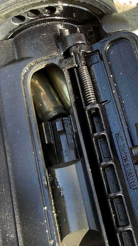

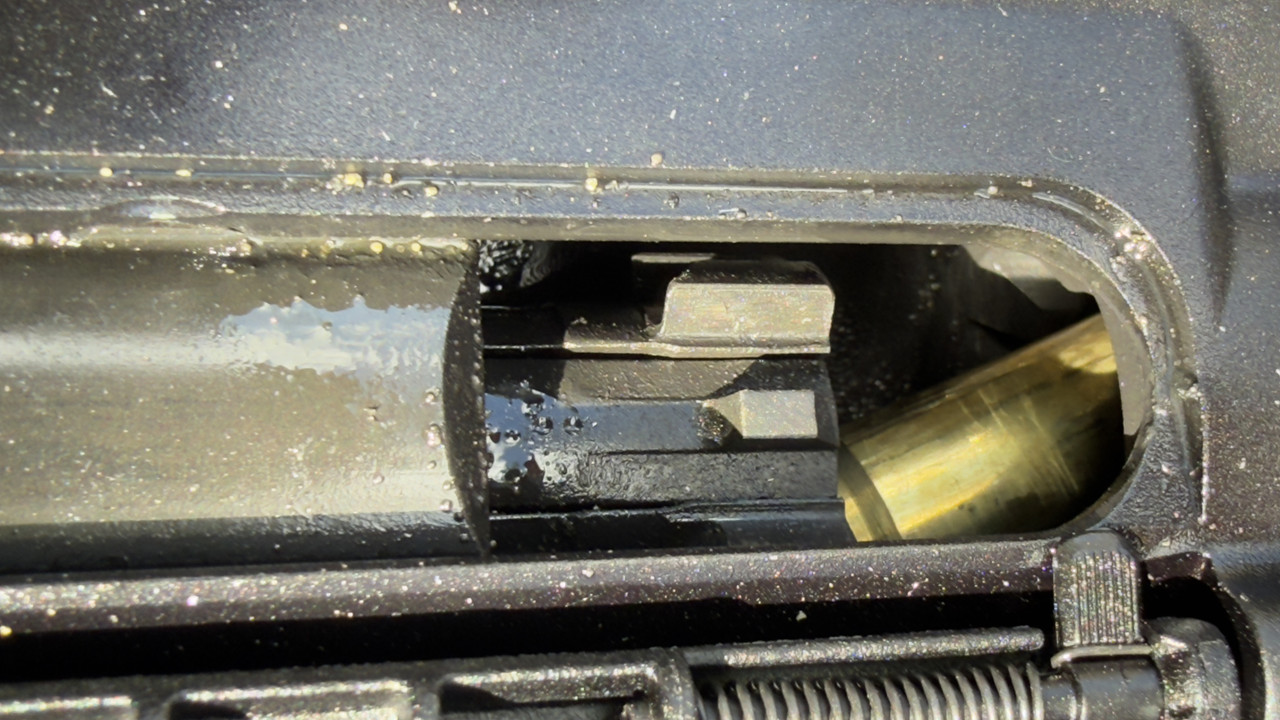

Back to the drawing board.  No idea why but my next outing, I started getting failure to feed issues where the tip of the cartridge would be jammed upwards with the case head below the bolt.  It'd happen on bolt drop or by pulling back the handle and releasing a bit more slowly, albeit inconsistently.  I'd get ok feeds on occasion and could get 3-4 rounds before an FTF happened.  This was with several different factory cartridges, round nose and HP's.  Just bizarre given it worked fine in semi and super semi the last time I had it out.
I need to examine everything thoroughly but there's a good chance the mags are sitting too low or even too high.  I've also read about the possibility of sharp edges on the leading face of the bolt keeping the cartridge from seating on the bolt face as the bolt moves forward.
I do have a bit of uneven wear on the trigger hammer so I'll be looking into that as well.  Just want this thing to run as it's so damn quiet.  I brought my 300 blackout along and even with ear pro, there's a significant difference in noise.
10/9/2025 12:20:22 AM EDT
I briefly played around with it tonight, hand cycling rounds out of one of the mags and most fed but I'd still get failures to feed.  I adjusted the mag release, made it a bit tighter, and that seemed to help a smidge.  I watched as the bolt glided over the feed lips, watched as the round was picked up out of the mag, etc...it wasn't a left or right side feed issue as near as I could tell and the bolt didn't seem to be dragging on the feed lips excessively.
I did have one bolt hang up where it was past the bolt release but still got caught on something.  This was with very slow hand cycling only.  I was watching to see if it's a mag related issue, possibly the magazine sitting too high or too low.  My first outing, I had issues getting the mags to seat more than once.
I also looked over the bolt, looking for sharp edges to see if the round is catching on the bolt as it's trying to seat on the bolt face.  I couldn't feel any snags.  I did notice a very small dent or nickt on the rim's lip, especially on the ones that got hung up.  But that could be from being jammed up like that.
One other thing I noticed is when cycling the bolt slowly, pushing the cartridge out of the mag, once it exited the feed lips it would go nose up, pop up,  as the mag's spring pushed upwards and the cartridge snapped out of the feed lips.  Cycling faster, it was tough to see where the FTF point was or what was different.  I may need to film it in slo-mo.

I think I figured it out today.  It's the mags.  So the Exomag is the stand -alone proprietary 9mm mag by MEAN.  They also make the EndoMag which converts 5.56 P-Mags to 9mm.  On a whim I ordered the Endomag conversion and installed it moments ago.  I then dropped the bolt on a mag full without one single failure to feed.
If you compare the two, the Exomag (red follower in the photo below) has a higher floor and a steeper "ramp" just in front of the follower.  Additionally the Exomag funnels in towards the center where the Endomag does not.  No idea WHY they change the geometry but it is what it is.  The cartridge also sits further forward in the Endomag vs. the full Exomag.  I'm guessing if you're running an AR lower, you'll want the Endomags.  Hitting the range Saturday, weather permitting, to confirm 100%.

Another range trip and another update.
The endomag worked right off the bat but I began to get failure to eject issues which is a known issue with the CMMG bolt face ejector setup.  With less than 150 rounds, this is hugely disappointing.  I have a set of Tubb springs to go in and will contact CMMG to send out a new set of ejector and extractor springs.  The external ejector bolt and upper from CMMG is another $425 not to mention I'd then have to buy all new mags from MEAN to accommodate the external ejector.
Anyway...the FTE's were not a regular occurrence.  Very erratic ejection pattern, sometimes the cases would fling out at a decent velocity, sometimes they'd dribble out or not at all and I'd get a stovepipe or outright jam (see pics below).
I experimented with buffer weight and went from 3.0oz to approximately 2.7oz.  That seemed to work somewhat better for feeding overall but on occasion, the bolt would not lock and I'd have to use the forward assist or drop the bolt on the cartridge.
I went back to the 3oz buffer and did not mess with the spring which is a soft Sprinco yellow.  From there, I started using the Exomags again (remember the Endomags are inserts into 5.56 p-mags) and honestly, they mostly worked.  I moved over to a brand new Exomag which I hadn't used yet and began seeing failure to feed issues.  So now I believe they need to be broken in both the spring but the feed lips as well as the bolt slides along the outer edges.
With all that said, I was able to do some testing on loads and now have a 149 grain load that's technically supersonic but subsonic at about 1045fps out of the ported barrel.  This is a PCC-only load using NAS3 steel cases and Vihtavouri N350.  Single digit SD's and it's dead on cloverleaf accurate at 25 yards.
I went back to testing the mags and my Atrius SS failed.  It'd shoot in normal semi-mode but not super semi.  I popped the upper open and didn't see any marks or breakage on the Atrius.  Haven't had time to dive into it deeper.

External ejector upper and matching bolt installed.  If you make the switch, you WILL need to time the barrel nut so the hand guard rail lines up with the upper receiver rail.  So make sure you have barrel nut shims on hand prior.
I spent a bunch of time working over each MEAN magazine to make sure there's no drag.  I also took the extra step to install some thermal insulation over the titanium expansion SD chamber.  I'd hoped to maybe convert to a Smoke Composites carbon hand guard I have lying around unused but the barrel nut is too long.  Will need a barrel nut that's short enough to allow the titanium chamber to still screw into the barrel if you want to run a different hand guard.

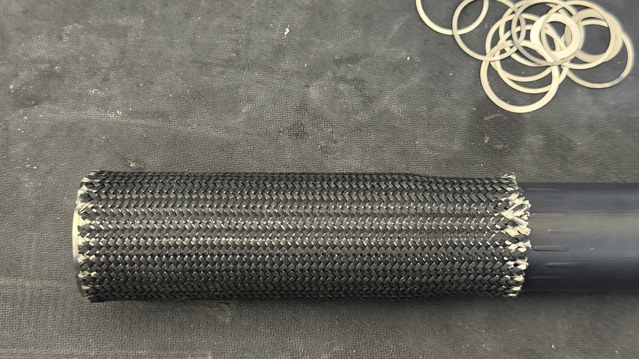

The thermal insulation is Techflex FGN1.00 Insultherm Sleeving 1"  and it'll expand enough to slide over suppressors or anything else up to 1.75".  It works really well and I use it for a few products I produce for high heat environments in the automobile world.

Got to the range today and success!  I ripped out the Atrius this morning and put in a cheap $100 super safety, push type.  I have five MEAN mags total and one 5.56 Magpul converted to 9mm with the MEAN insert.
The conversion (Endomag) worked 100%, full mag dump 30 rounds.
Three of my MEAN Exomags worked, two need more sanding off the feed lips to eliminate bolt drag.  That is absolutely what's causing the misfeeds.  In semi-auto, they were all fine.  Super semi mode will cause an occasional misfeed.
The heat shielding I installed worked really, really well.  The hand guard itself is pretty good but it will get borderline hot.  I could run my hand along the hand guard and where the tech flex ended, the hand guard increased in temp.
If you're planning one of these yourself, just get the barrel, hand guard and SD adapter.  Then get the CMMG upper with the external extractor and the matching BCG.  It'll run like a top.  If you have a ton of p-mags and don't want to mess with possibly tweaking the MEAN Exomags, just get the MEAN Endomag inserts.  I didn't have any issue with the Endomag setup with either round nose FMJ or hollow points.
Overall it's a very quiet setup and I'm using a high flow suppressor.  I'm sure there are other traditional baffle cans that are probably a lot quieter.  None the less, I pulled out my ear plug and it was fine.  This was with 124 grain Winchester plinking ammo.  Super dirty so occasionally I still got a good cloud of gas.
When testing the 124 grain supers, to me, they didn't seem any louder.  I used Alliant BE-86 and Vihtavouri N340 with Shell Shock NAS3 cases.
Hope this helps!

Final configuration (we all say that but you know...).  I installed the AS Designs ARC-Fire with a Geissele SSA-E, the Doublestar SOCOM stock gen 4 and a Smoke Composites carbon grip I had lying around.  Messing around a bit with a digital NV clip on that can sit in front or behind the RDO or as a stand alone as well, haven't quite figured out which mode is best.  The Trigger and AS Designs work as promised although you will have to "trim" the Geissele to work and will need the lever blocker as well.  But it feels like a Geissele so worth the effort.

Here's a full list with links to the major parts:
-Broad River Tactical SD Chamber.  You'll need to pick whatever model works with your suppressor.  I have a HUB suppressor so I use the Bravo series.
-Broad River Tactical radial delayed ported barrel
-Broad River Tactical hand guard assembly.
-Sprinco YELLOW buffer spring. It's part number 25113.
-3oz standard buffer
-MEAN Arms Endomag.  You want the EJECTORLESS version.  This converts a Magpul 5.56 P-Mag to 9mm.  It's not the full mag but it is the most reliable.
-CMMG fixed ejector retrofit kit.
Those are all the major parts.  You'll want a built out AR15 lower of your choice.

MEAN used to recommend doing that but later changed the design so if you are going to go ejectorless you should get the right ones.  They used to swap you out your cut off ones for the ejectorless ones for free.  I don't know if they still do that.
You can see the difference in my link below.
https://c3junkie.com/?page_id=598
When initially introduced, MEAN Arms made only one insert for the CMMG RDB and straight blowback variants.
If you ordered the CMMG RDB version, they would chop off the ejector on the mag and then sand off the front of the mag as pictured below.
However some people were having some reliability issues and MEAN Arms came out with a '2nd gen' version for the CMMG RDB.  Picture below illustrates this.  1st Gen on the left and 2nd Gen on the right.  Note that the 2nd gen has like 'wings' that go over the feed ramp area which prevent the rounds from jumping over the chamber.

The Aero handguard came in and it does indeed work.  Bolts right up to the existing BAR-style barrel nut.  The screws that come with the aero are a step up from the BR screws.  I'm guessing the entire setup removes about 16 oz. of weight.  I ordered the 7" but there are other sizes available depending on how much rail length you need.
I will say it's a tight fit. Some M-Lok screws might need shortening to work depending on your suppressor's girth.
I'm mitigating heat around the titanium SD chamber with  Techflex FGN1.00 Insultherm Sleeving.  It's 1" in diameter but expands and is good for 1200 Fahrenheit which should be more than enough for 9mm subs.
Will take a few photos tomorrow before I head out to the daily grind.

Couple of photos.
