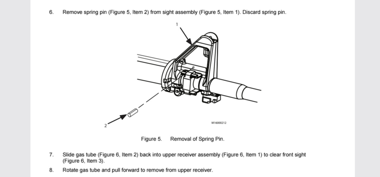

Hi all. I am thinking of buying the Daniel Defense M4A1 upper from Brownells. This upper has a FSP.
I typically change the gas tube to reduce/fine tune gas. With this specific upper, does anyone know if I am able to pull the gas tube out through the upper receiver?
I don't see any other way of changing the gas tube without having to unpin the FSP, which I rather not do.
Has anyone removed a gas tube this way before? Since the gas tube is angled, I assume you would need to rotate the gas tube as you pull it out -- and then rotate it while you insert it back in. I have not found any videos or photos of this method, but it's the only thing I can come up with that would allow a swap without unpinning the FSP.

You do not need to remove the front sight post to swap out the gas tube
Drive out the gas tube pin in the fsb with a punch.  The tube will go back into the receiver and inch or so, and can then be pulled out past the fsb at an angle.
“All things are said already, but since no one is listening, it is always necessary to start again.”
8/23/2026 9:00:24 PM EDT
Tap out gas tube retaining pin in fsb.
Simply slide the gas tube out of the fsb and into the upper receiver until it clears the fsb.
Twist the gas tube a bit so it's offset from the fsb, and just pull it out of the upper receiver.
Do the above in reverse to install new gas tube.

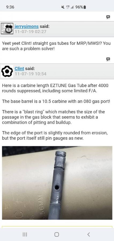

I'm curious how changing the gas tube helps to reduce/fine tune gas.....  🤔
8/24/2026 6:15:24 AM EDT
Not a common thing to do but yes it’s a thing.
https://blackrivertactical.com/WP/BRT-EZTUNE-Gas-Tube-Configurable-Carbine-p103167251
8/24/2026 6:31:14 AM EDT
I have BRT’s on 3 suppressed guns.
They are fantastic!
8/24/2026 7:01:49 AM EDT
https://blackrivertactical.com/WP/Adjustable-Gas-System-c6464009

Massive reduction in gas to the face by restricting the port size on the tube.

For everyone responding, thanks for helping.
Because I would be using a RIS II upper, I am not sure I would have enough space to pull it -- has anyone done it themselves?

I see the roll pin and the gas tube, but I don't see a way to pull that gas tube without mangling it.
The RIS II FSB requires the R&R of the front sight A frame and gas tube. The gas tube is pinned into the front sight, the front sight is inserted into the cutout in the top rail section, and the combined components are slid over the barrel.
Do not plan to wrangle the gas tube around the front sight and out of the railed handguard without dicking it up.

Yeah doubt you have enough room to get the gas tube around the front sight while so close the the sight cuttout in the handguard.

OP, I grabbed a stripped upper, put a gas tube in there, and spun it with different portions of the tube in the hole in the upper.  The front of the tube goes well beyond where a rail would be sitting, due to the bends in the tube near the rear portion.
You could absolutely force it out and pound one back in, but my guess is you'd have a bent tube at that point that would require you to shove something in there to pry it back into place to get it to align with the hole in the FSB.
Long short, either pull the thing apart or leave it be.  You may be able to make it work, but it would likely be equally as annoying as taking it apart.
Thanks for your input... I think at this point it isn't worth it. I either leave it stock and use bootleg BCG or just build out my 14.5 SOCOM RIS II upper, it'll be much easier to swap it out on that.

I have a 10.3 MK18 and a 11.5 RIS III with thousands of rounds of use. This would be a new build I am planning. I started thinking of how I would go about changing the tube and then realized it might not be possible without removing the FSB. Wanted confirmation
I’m curious how those tubes hold up after thousands of rounds. The images from the company show erosion around the restricted tube. Seems like the thinner metal of the tube would erode pretty quick where the reduction is.
8/26/2026 10:45:59 AM EDT
10k rds life expectancy per BRT. I have no idea how accurate that may /may not be? There's a good sized thread on TOS with quite a bit of input from users and also Clint from BRT.
I did see this, and after 4 cases of ammo I thought it was in decent shape still.
