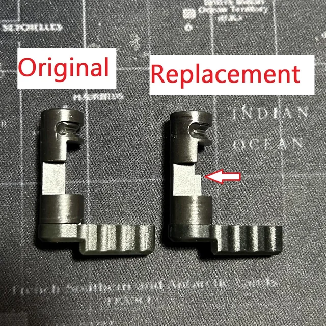

6/27/2026 9:11:19 AM EDT
[Last Edit: mini14jac][Edited] [#10]
Originally Posted By Gorton87:
We were made aware of this pretty early on and started to remove the semi position farther to allow additional disconnector engagement. RB and Triggered have taken this even farther by only relieving the disconnector position farther and not the trigger. Which is what we also plan to do in the future.
Can you let me know when you placed your order?
Obviously if anyone has any issues we would get you taken care of asap.
https://datummachine.com/wp-content/uploads/2026/06/IMG_9876.webp
@gorton87
Any chance you can post the depth and width of the cut in the replacement part?
Thank you sir.

6/27/2026 6:31:57 PM EDT
Was corrected pretty early on so the chances of you having one are low and most don’t even exhibit the issue. I still use one in a rifle with thousands of rounds.
I got my Disruptor 6/9.
It’s got the XP spring, but has the original safety lever as shown on the left above.
6/28/2026 10:56:31 AM EDT
They have always cut their semi position down. You should be just fine.
