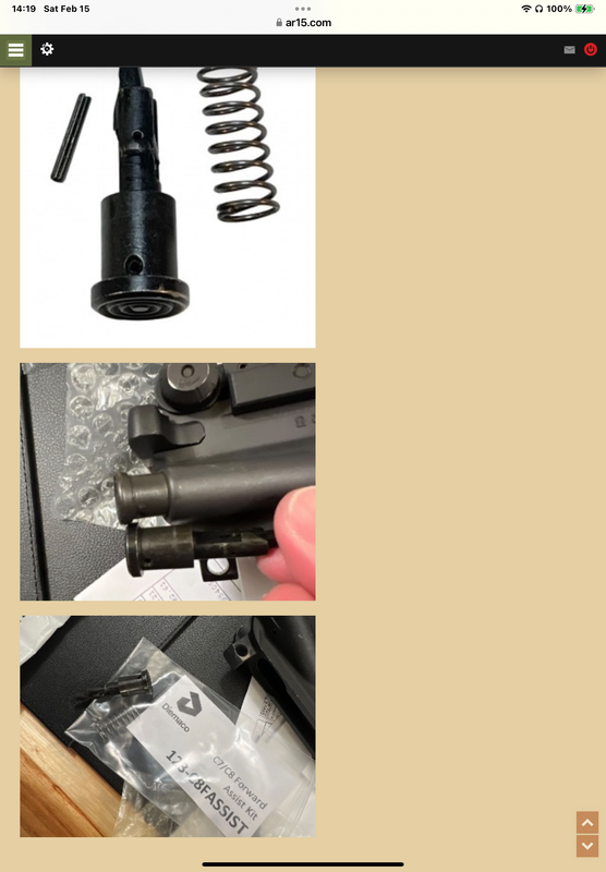

11/2/2025 10:18:31 AM EDT
I believe at some point the Canucks used a unique forward assist.
Looks like the large round Colt one, but turned down to the same diameter as the current F/A, probably to clear A2 lowers.
There are pics in the untacked C7 Thread
