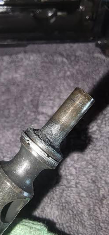

I recently picked up a new Urban Hunter AR-10 from Wilson Combat (paid over $3,000 for it) and noticed a machining/surface defect on the bolt tail right out of the box.
When I reached out to customer support, their initial response was to dismiss it as purely cosmetic because the bolt tail doesn't make direct mechanical contact with other moving parts during operation.
While I understand it's not a primary bearing surface, my thought process is:
Technical Concerns: The bolt tail is directly exposed to hot propellant gases and heavy carbon buildup. A surface bump or defect seems like it could act as a focal point for accelerated carbon accumulation (making cleaning harder) or create potential localized stress concentration/corrosion points over time.
Expectations at $3,000+: Given Wilson Combat’s premium pricing and their explicit satisfaction guarantee, I expected flawless craftsmanship across the entire component, not just the critical contact surfaces.
For those with more gunsmithing, metallurgical, or industry background:
Is a surface defect on the bolt tail truly a non-issue from a functional/durability standpoint?
Given the $3K price point and Wilson Combat's brand reputation, is it reasonable to stand my ground and insist on a replacement/fix under warranty even if it turns out to be purely cosmetic?

I believe it is a critical/functional surface as it fits bolt tail to carrier.  "Machining defect" makes it sound like possibly an out of spec dimension.  If the bolt tail is out of dimensional spec, I would want it replaced.

Please see the photos. I marked the area which is a burr/small bump with finish defects. Also included a full picture of the bolt.

As far as I can tell, it appears to me like a carbon burn which will happen as you shoot it. Try using a solvent like Hoppes 9 and/or using a worn brass brush to scrub that area. My bet is it'll come right off. It may or may not come off with CLP and a nylon brush as it is a pretty baked on carbon. It is also fine to leave it as is if you're not bothered by it. Since it is a DI rifle, all of the hot gas is pretty much building up right behind that area and after shooting a magazine or two, it'll have a nice layer of baked on carbon.

Whatever it is, if the bolt closes there is nothing to be concerned about at all. Where the spot is isn't interfering with anything at all.

Looks like a non-issue to me OP.
7/27/2026 9:51:16 PM EDT
It's in a non-critical area.  Just shoot it.

I can be pretty OCD about things but that looks pretty minor to me.
Put a couple 100 rounds through it and it will disappear.

Thanks for the advice. This is a brand new rifle, it’s a burr and there is no surface finish or the finish is defective, I can clearly see and feel the burr, I doubt cleaning agent will get rid of a metal burr

It's probably from test firing it. It would feel hard like it's almost like metal if you never seen it before. Just clean it, and go shoot and enjoy. It's not a burr or deep gouge in the metal. If it was, the fire pin wouldn't go in as it is a very tight space for it to go into.

Is there a void that this protrusion is raised from? It's about a 99% certainty that parts of this shape are turned on a lathe. All the material where that lump is has been removed by a blade as the bolt spins. If it is indeed part of the bolt raised as a burr, that metal has to have been displaced from the bolt after it was turned.
It's most likely a carbon lump from test firing. If it is carbon, you should be able to scrape it off with a flat metal edge. (not a blade, a 90-dgree edge on a chunk of hard metal) Note that carbon buildup is hard. Half-hearted scraping will not do much. A less physical option is a carbon solvent cleaner.
If you can get some tighter, well lit closeups that show a divot where a chunk of metal was displaced up to form that lump, I'll reverse my opinion.

It's likely just baked on carbon, which will inevitably build up after only a few rounds. Generally the carrier will scrape off any excess so you shouldn't need to worry about it or buy any specialized tools to scrape it off yourself.
I guarantee that I have bolt tails that look worse than what Tigwelder posted because I don't clean my guns, but they run just fine.

Absolutely this.  I highly doubt a lathe would create a raised lump of material with the rest of the bolt tail so pristine.
I’ve seen tears in different types of materials caused by broken or worn out cutters that would leave a worn burr at the end of the tear, but there’s no tear on your bolt at all.
It’s almost certainly carbon from test firing.  It can really adhere to the metal and look like it’s part of the bolt, but if you take some oil and soak the carbon, then get a brass pick or shell casing mouth to scrape it, I bet it will come off.

As far as OP, it is still hard to tell from the pic at that angle, but if it is a raised metal deformity, my non-expert opinion is that functionally it will come down to whether that part of the bolt is meant to enter the small aperture in the middle of the carrier or not.  If it is entirely in the "gas chamber" part of the picture above, it is not a functional issue.  If it is further back than that, you likely have a problem.
As someone said above, if the bolt closes smoothly, it is probably functionally fine.
Regardless, that is kind of crappy to be there regardless of price, and especially on a semi-premium priced gun, even if it works.
Assuming it's a raised metal burr, Its a manufacturing defect, not a surface handling mark or something from test firing.
IF it is completely in the gas chamber, it will likley quickly get covered up in caked on carbon though, so there's that.

Just to clarify I am not a AR novice and I can tell the difference between carbon lump/ buildup from metal burr. This is definitely a metal burr, probably from machining.
My apologies if the photo isn’t clear enough, but it is definitely a metal burr, it might be small but it’s there.

I'm willing to bet I can get it off. Maybe I'll try to go shoot sometime this week and see if I can bring you a similar looking mark on my bolt tail. Yes it will feel very hard and might even be hard to remove. But I believe it will come off, I'm about 90% positive.
However if you are so sure it is a burr in the metal, then go ahead and give wilson a call and demand it is not a cosmetic defect and something you want fixed because it is on what you consider a sensitive area.
7/28/2026 5:10:56 PM EDT
[Last Edit: Trucker69][Edited] [#41]
No, I never considered WC to be boutique AR? Does boutique AR even exist?
But even my $500 PSA doesn’t have this kind of issue after almost 1k rounds with steel case ammunitions.
It’s really hard to swallow that a 3k unfired rifle came to me like this
I’ve been shooting AR’s since the 1980’s and at one time I thought I had the same problem you have.  Carbon gets very hard and bronze brushes alone just turn it gold color.  Oil and a pick will remove it, and I am 99% positive, despite what you believe, I wholeheartedly disagree with your assessment.  It’s carbon.
Not sure how familiar with lathes you are, but just so you know, that defect you show is impossible to have come from one.
Just because you think that you’re highly experienced with the platform, you can surprise yourself seeing things you may have not noticed before and be incorrect.  It’s not a big deal, I’ve been self assured of things like this in the past, only to have to swallow my pride when shown I was wrong.
Get a pick and scrape it, it will come off, then come here are update us.
7/28/2026 6:47:54 PM EDT
Why the heck are we scraping our bolt tails fellas?
7/28/2026 6:51:27 PM EDT
Aerodynamics. Speed rifle. Light weight. Smooth operator.
7/28/2026 6:58:04 PM EDT
It’s not necessary to do it.  OP is certain the carbon on his bolt is raised metal from the turning process.
I’m telling him to do it because it will remove the carbon and show him it’s in fact, not a defect.

It's not necessary to do it.  OP is certain the carbon on his bolt is raised metal from the turning process.
I'm telling him to do it because it will remove the carbon and show him it's in fact, not a defect.
That's fair enough, but some guys are talking like this is a normal part of maintenance.
Eh, it doesn't hurt to scrape your bolt tail now and then. It'll build up pretty excessively if you don't. Not saying it's absolutely necessary, but if you aren't ridiculous about it, no reason not to do it.
I have a fairly well-established reputation for fairly extended periods between cleanings, but even I clean my bolt tail occasionally. At the same time, if you're scraping off your finish and/or removing metal to get it perfectly clean on a regular basis, that's excessive and not at all a good practice.
