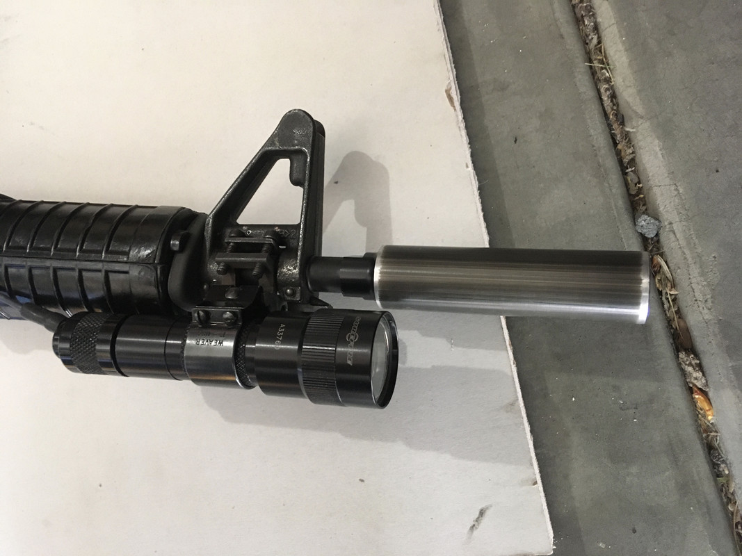

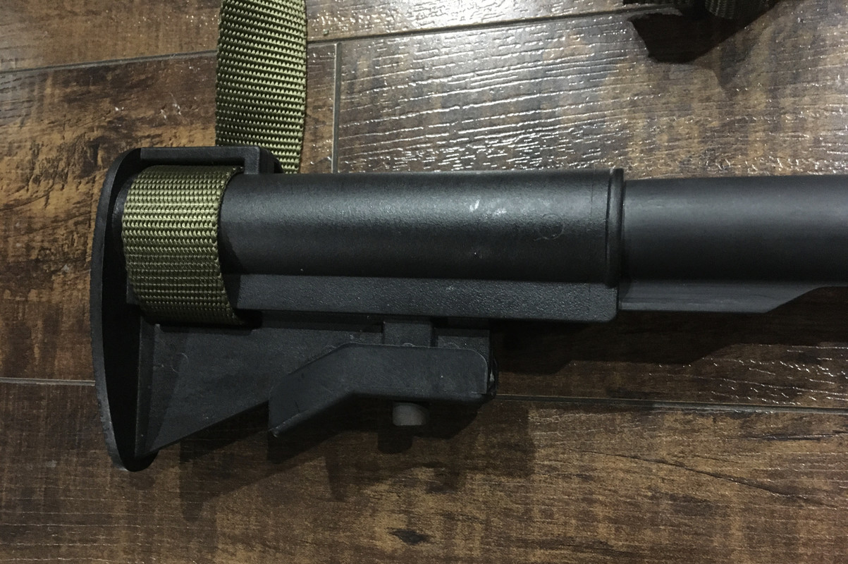

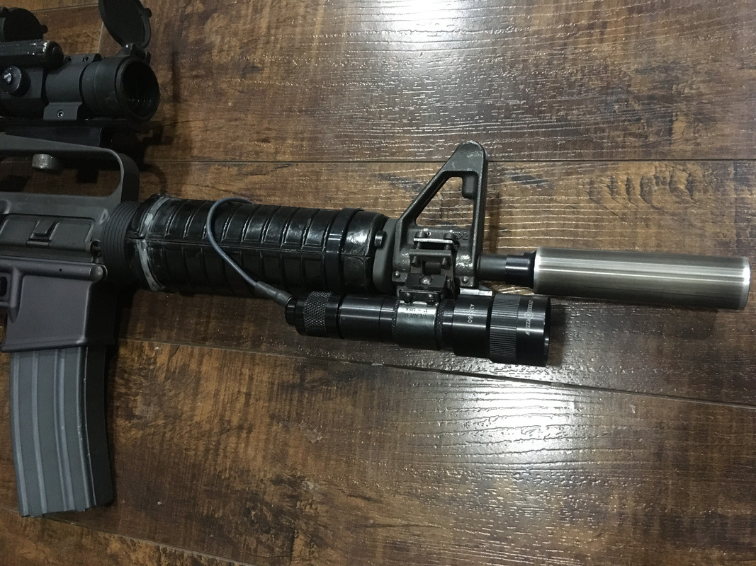

I made a few changes and now I’m 99% done with it. Here’s the updated parts used
-Colt A2 upper
-Brownells A1 barrel cut to 10.3 with non F bayonet lug FSB
-triangular handguard retainer
-Retro Rifles long 607 style moderator
-Fiberglass A2 handguards cut and JB welded to carbine length
-Surefire 660 with fitted Surefire M14 mount and tape switch held by zip tie
-B Square weaver mount
-Early 2000s Aimpoint Comp M
-Trijicon TX14 30mm split ring
-Model 1 Sales commercial size polymer CAR stock. It has the profile of an aluminum stock with reinforcement ribs and no markings except for circular mold marks on the right side only
-commercial size receiver extension with lock ring
-replica OD green nylon M16 sling modified into a shoulder loop
-Brownells A1 lower borrowed from my XM177E2 SBR(A2 grip installed, but not pictured)
I’m holding off on painting it until I get another lower for it, but I’ll probably throw an A2 grip on it in the meantime.

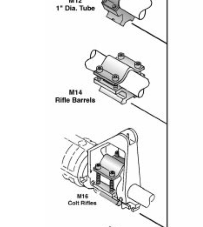

Is the barrel mount an M14 or M16 mount from SureFire? And does anyone have a lead on one?
Originally Posted By bradpierson26:
So I know you're a SF whore . . . . .
4/16/2025 2:21:00 PM EDT
I used a M14 mount on mine, the M16 would probably be easier to fit as it’s not as wide as the M14 from what I can tell. The M16 mount was designed to go over the gas tube rather than under it so some filing would still be needed. I don’t have a M16 mount, but I do have a real M14 mount on my PTR91 if you need it for measurements. It hasn’t been filed down, but it would be awesome to be able to get legitimate reproductions rather than the thin Chinese barrel mounts. Here’s a comparison picture out of the ‘97 Surefire catalog.

How much OAL does the TIA muzzle device add to the end of the barrel?
4 3/8" is the size of the moderator from the TNTE clone upper I have (does not include the generic washer)...
Not sure if there is a specific device you're looking for but it seems like most of them are the same length.
