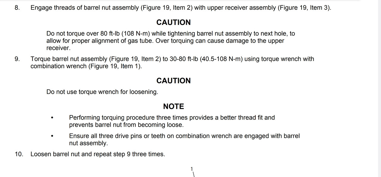

When in doubt, follow the TM:

If you’re using the GI barrel nut, the torque range is 30-80 foot pounds.  I’ve had a few over the years I probably had to bump a touch over 80 to get alignment and it’s not a big deal.  Guns ran well and when disassembled later there were no signs of damage.  As long as you’re not using PSA breaker bar levels of torque I wouldn’t worry personally.  Otherwise your only other options are to try and shim the barrel nut, have multiple receivers and check for best fit, or swap barrel nuts also looking for the best fit.

I would say make sure the threads are greased, do the 3 times  tightening-loosening thing, then tighten it to alignment.  Should be fine.

Tighten and loosen 3 times to stretch the threads then anywhere between 35-80ft/lbs to get the alignment right. This is pretty common it will never line up at a specific torque spec. It's a torque range because of machining specs no two recievers or barrel extensions are the same.

According to Ripcord industries installation instructions, you tighten it to torque once, then back it off, and then tighten it back to torque one final time.

Again, refer to the TM:

Originally Posted By m4nut:
Again, thanks for all the help.
On the 5th tightened/loosened/tightened, all aligned.https://www.ar15.com/media/mediaFiles/20054/1000027831_jpg-3742153.JPGhttps://www.ar15.com/media/mediaFiles/20054/1000027831_jpg-3742154.JPG
Some threads need a bit more "seasoning" than others. Glad to see that you got it together.

Originally Posted By DancingInAshes:
I use white lithium grease for anything that needs grease: trigger, buffer spring, threads on barrel nut.
I've used Lucas white lithium grease on several barrel nuts, buffer springs and such over the years. it seems to dry up and get chunky after several years so I switched to aeroshell. The lithium grease I have seems to separate out the oils from solids over time. I haven't noticed this happening at all with Aeroshell.
4/12/2026 9:33:54 AM EDT
Originally Posted By MaxSpeed74:
Once you get a thermal fit barrel in to where you can engage the threads you can generally tighten it to contact with your fingers so... 5 ft/lbs max?
Pretty much. When I installed my criterion core on my BCM stripped upper, I was able to get it almost all the way in just by pushing and wiggling. Then I put the barrel nut on and GENTLY tightened in to push the barrel all the way in.
Then I took the barrel nut off, used a bit of white lithium, and torqued it to spec once, backed it off, and torqued it to spec a second time for final installation.
That's an interesting point you make there. Just from reading this thread I think I'll switch to aeroshell for future builds or modifications.
