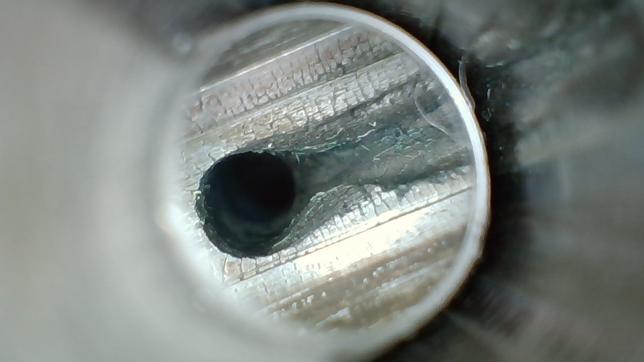

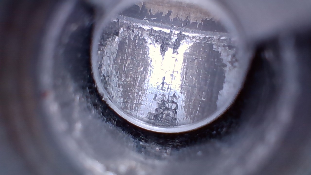

Okay, it took me another 3 hours and probably a few dozen patches, but it looks like I got the barrel free of copper. Here is the bore scope video:
https://i.imgur.com/JoPVafx.mp4

[Last Edit: AR-Zen][Edited] [#40]
Originally Posted By Samuel_Hoggson:
At 2.5k with a softer firing schedule, and assuming the loss of precision is factual, suggest getting serious with abrasives (as others have already suggested).
I decided to not use abrasives for now, but I did construct this apparatus (shown below) to speed up the cleaning process. There is a nylon brush at the end, and yes, I did use the bore guide when using this.
The barrel is super clean now. I'll shoot it this weekend to see the effect. I am predicting at least a few of the 0.7" 5-shot groups.

2/12/2026 3:34:55 PM EDT
https://i.imgur.com/FxdgMIr.png

Just when I thought I was done cleaning, I've used a bronze brush, and it removed a lot more of carbon. After a few more hours, I think I've removed all the carbon and copper that I could, although the bore scope still shows dark color near the throat of the barrel. Also, I've installed NamionalMatch shim to eliminate the wobble between the upper and lower receiver. And finally, I adopted what I call a "supernatural point of aim". That's when/where I am so comfortable behind the rifle that I feel I could fall asleep.
The results are now closer to what I want to see. The groups below are 0.65", 0.7", 0.85", 1", 1.3".
