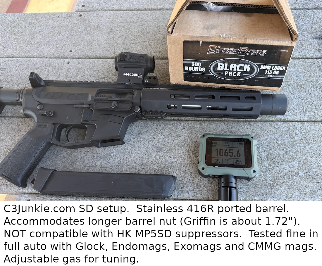

I need to test my new Scorpion mag lower setup.
https://c3junkie.com/wp-content/uploads/2024/03/XK9-1.jpg

I contacted NFA before I bought the XK9 that they make.  They told me that they are coming out with a Gen2 but it won't be till the end of the year.  They didn't tell me what was changing.  Seeing how everyone complains about the 'cheesy' ejector in the lower, I figured maybe they were going to change that.
But based on this thread: https://www.ar15.com/forums/ar-15/New-NFA-S-9-Lower--Scorpion-mags---Pics--review-and-build-in-progress-with-CMMG-RDB/15-754694/
That guy got his working with the CMMG RDB so I figured, if I wait for Gen2 maybe the changes will make it more difficult with the CMMG RDB so might as well buy this one since the thread above was 'successful'.
I purchased 10 of the same mags from Prepper Gun shop like he did (all clear version like his).
I opened the package on 4 of the 10 and they all SUCK.  I test fired it and it was jam city.  I pulled the mag from the gun.  Just stripping a round off with my thumb, it would hesitate for a few seconds and then the next round would move up.  So obviously a mag problem.  I checked the other 3 mags and they all the same shit.  I thought maybe a COL issue.  So I tried factory hollowpoints and just trying to strip rounds off with my thumb it would hesitate as well.  Obviously not good enough for live fire.
Since I opened the wrapper they wouldn't give me a refund which is bullshit.  I can exchange them but why.  To swap out for another shit one?   I did return the other 6 for a refund but was also charged re-stocking fees.
I'm not buying from them again.
So I borrowed a factory CZ 30 and 20 round mag from a friend and I will need to clearance the carrier to make those work.  I ordered some of the PSA AKV mags which people seem to rave about and got them today.  They are like the CZ mags in that I will need to clearance the carrier for those also.  I have uppers and carriers that have been clearanced to run unmodified AK mags like the KS47 stuff and those clear.  So now I need to mill my upper and carrier out some more to test the factory CZ or PSA AKV mags.  I did only buy two of the AKV mags this time and PSA literally put them both in saran wrap and a plastic mailer bag with no padding.
What is more concerning is that a friend of mine bought one of these XK9 lowers at the same time and assembled his in a straight blowback configuration which is what it is designed for and even with factory CZ mags, it is jam city.  He says it is feeding too low.  Which is really what you need to make the CMMG RDB work....the feed height needs to be lower than straight blowback but I have shit mags right now so I don't know.
So now my friend and I are wondering if these lowers are just whacked and don't work with either.  Have you shot yours?

So just to be clear, my PGS mags fail to feed when not even in the gun so nothing to do with the lower but that doesn't rule the lower out either.
I have about 8 of them in total. I've tried Magpul and they were a no go for both my AR-V and my S9. The AKV mags were a close second but I had to shave the plastic off the feed lips all the way down to the metal reinforcement and even then they induced malfunctions while feeding my S-9 lower. The PGS mags were the only ones that worked without issue out of the box. I will also admit I don't shoot much in the way JHPs with it, but I did test about 2-3 mags worth to make sure it would feed them well. If my memory serves me well there were a few hiccups with upward facing cartridges causing FTFeeds. It hated small projectiles like Hornady Critical defense, but liked Speer GDs and HSTs as long as they were heavy 135gr-150gr.
So maybe I got a bad batch?  I also tried swapping the spring in mine with an UZI and 33rnd Glock spring which helped but still wouldn't just stripping rounds off with my thumb also.   Also tried swapping just the spring and also spring and follower from the factory 30 round CZ mag so I suspect something is wrong with the bodies of my PGS mags.
If yours work then maybe I got a bad batch.  My buddy ordered 4 at the same time I did and has the same issues so maybe we both have bad mags?

I've had people ask me about converting those barrels to the RDB system.....yes, I can do it BUT.....
I know someone that has the Hitech / MEAN SD upper.  He told me it is way too aggresively ported and it doesn't run even with hot 124Gr ammo.  I sent him a picture of the RCM ported AR9 straight blowback barrel and he says the porting looks identical.
He thinks the same company makes barrels for both.
All that said, that amount of ported works fine for straight blowback but has issues with a delayed blowback setup.
He ended up paying more money to have someone plug the ports of his upper to get it to work.
When I tell people all these details, nobody wants to try paying me to convert one of those barrels.
I personally don't care for these SD setups as it does have a smaller operating window.
Here in FL factory Aguila 124 Gr is subsonic out of a 5" barrel.  While factory 124Gr Blazer is supersonic.
I do have a customer in a northern state that I did a 3.5" barrel for.  I'm waiting to hear back from him but I may do more of those if he has success.

I think if you read through this thread you will see how much I despise the original spring loaded ejector and went through great lengths to modify it to use a custom fixed ejector.  I was always hesitant to recommend the CMMG RDB for 9mm or .45 until the FE Banshee came out in Feb 2025.  I wouldn't run the original spring loaded ejector if it was free.
However, like I mentioned before they are using the same 55 degree bolt that is used in the bufferLESS Dissent for the FE Banshee.  Being bufferless means less reciprocating mass.  There have been threads where people have issues running short barrels unsuppressed with the FE Banshee but then work fine when adding a suppressor.  Likewise running an SD setup is going to have less backpressure.
Analagous to an HK MP5SD which uses a 120 degree LP vs standard MP5 using a 100 degree or an MP5K suppressed using an 80 degree.... we have no options in changing bolt angles with the CMMG RDB at this time.  So you are left with messing with buffers and springs.
I get emails all the time asking me for advice on the BRT cycling issues.  BRT already recommends using the LW Sprinco yellow spring and 3 oz carbine buffer.  It is his product so I'd say do what he says and talk to him if it isn't working for you.  I think that advice has worked for most people.
You may have seen that I offer the service of lightening the carrier which should also help: https://c3junkie.com/?product=lighten-cmmg-fe-banshee-carrier-cut-key-in-half-and-provide-spacer-for-ars-ex
As you may know, I am the inventor of the MicroMOA Govnah adjustable gas block.  Since I like tuning things I did this SD setup for the CMMG.  See last sentence in my picture below.  I'm saying adjustable gas but it is really adjustable porting but I guess you could say the same thing.  This allows tuning the velocity and backpressure.  Please don't ask me how I'm doing this as I am not ready to release it yet.  I'm sure people will copy me once they see it.
You have to zoom in but the average velocity was 1049Fps with this 115Gr Blazer brass.  I'm very happy with how this came out being so compact and it is really quiet.  Thing is so light that it feels like my son's airsoft gun.
I don't care about HK MPSD compatibility and wanted to use a longer barrel nut that is common on some rails.  This setup also uses a taper so nothing is coming loose.
