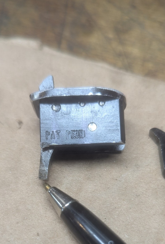

After checking the disconnector spring and hammer, I filed the end that contacts the trigger to stop the FRT in semi.  Worked great.
 This pic is an early one I welded and reshaped into a 3 position.  Unfortunately, not all frt's are drop-in.  If you aren't a tinkering, puzzle solving type with easy access to a place to shoot and test stuff, this realm will be frustrating.
