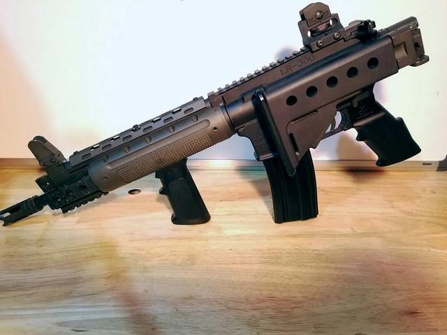

Originally Posted By TonyRumore: Other than Olympic Arms, are there any folding stock AR-15's that can be fired repeatedly with the stock folded? Tony My underfolder prototype does with the help of an ARIC bolt carrier. ![]() The Evolution Weapons System does too: Evolution link |

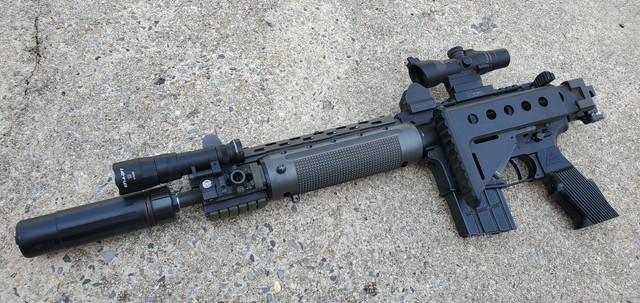

Originally Posted By kwb377: Adding the Foxtrot Mike FM-15 to the list of "mostly, sorta AR" that can fire folded. Do you happen to own one of these? Can you tell me if they're decent? I'm debating on going full send when I have the ability to. The BRN-180 just seems out of reach in my budget nowadays. |
Originally Posted By MjmsQuon: Do you happen to own one of these? Can you tell me if they're decent? I'm debating on going full send when I have the ability to. The BRN-180 just seems out of reach in my budget nowadays. I do...bought one a couple of weeks ago. I really wasn't expecting much out if it, bought it more out of curiosity and also to compare to other bufferless guns I own/have owned. I got the 12.5" version...I've only put @ 200 rounds through it but I really like. it. Pros: - Lighter than a piston gun, while being lighter than a traditional DI gun due to no buffer/tube. - Fairly accurate...I was getting @1.25MOA on paper at 100yds. with XTAC M193. Cons: - The factory charging handle sucks...it's angled and can be oriented up or down (and left or right). But having it angled up causes a "cheese-grater" effect on your finger against the Pic rail, while angling it down puts it too close to the handguard for easy purchase. I've ordered an AppleSauce Engineering extended replacement. - Gassy when suppressed. I used a YHM T3 and instead of getting a cloud of gas from the receiver/gas port, it felt more like a jet of gas into my face. FM supposedly offers a stronger recoil spring for suppressed use and I may try that. I also have/had a few other bufferless AR-based systems...BRN-180 (5.56/300blk), Spear LT (5.56/300blk), and JAKL. The FM isn't as smooth as the BRN or MCX, but I'd put it above the JAKL as far as operation and build quality. I really like the BRN, but I don't like 10.5" for 5.56...I wish they made an 11.5" or 12.5" version. The 11.5" 5.56 MCX was just too heavy to me for what it was. I've since pared it down to just having a 300BLK version of each (10" BRN, 9" Spear). I'm hoping this thing proves to be reliable/durable over the long term. Attached File |
Originally Posted By kwb377: I also have/had a few other bufferless AR-based systems...BRN-180 (5.56/300blk), Spear LT (5.56/300blk), and JAKL. The FM isn't as smooth as the BRN or MCX, but I'd put it above the JAKL as far as operation and build quality. I really like the BRN, but I don't like 10.5" for 5.56...I wish they made an 11.5" or 12.5" version. The 11.5" 5.56 MCX was just too heavy to me for what it was. I've since pared it down to just having a 300BLK version of each (10" BRN, 9" Spear). I'm hoping this thing proves to be reliable/durable over the long term. https://www.ar15.com/media/mediaFiles/16205/20260713_104503_jpg-3797507.JPG They did very briefly make some 13.9" Gen "2.5" brn-180 uppers Cleared them out super cheap on black friday a couple years ago for $400 - I snagged one ![]() Originally Posted By TonyRumore: Lots of great info posted. I appreciate the responses. Adding on.....can any of those systems handle a rapid reset trigger, trigger kicker, etc......or does the bolt bounce in rapid/auto fire? Tony Supposedly AS designs was going to release a slip/trip kit for the brn180 https://activesafetydesigns.com/brn/brn-180-slip-trip-kit/ If you're an FFL/SOT, take a look at the AR-18 design and use your imagination

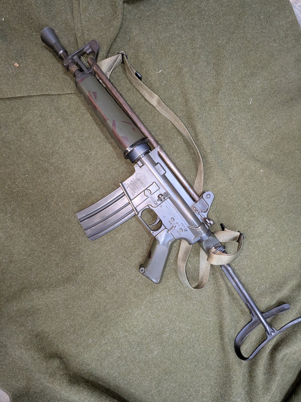

My son's RRA. Attached File |
